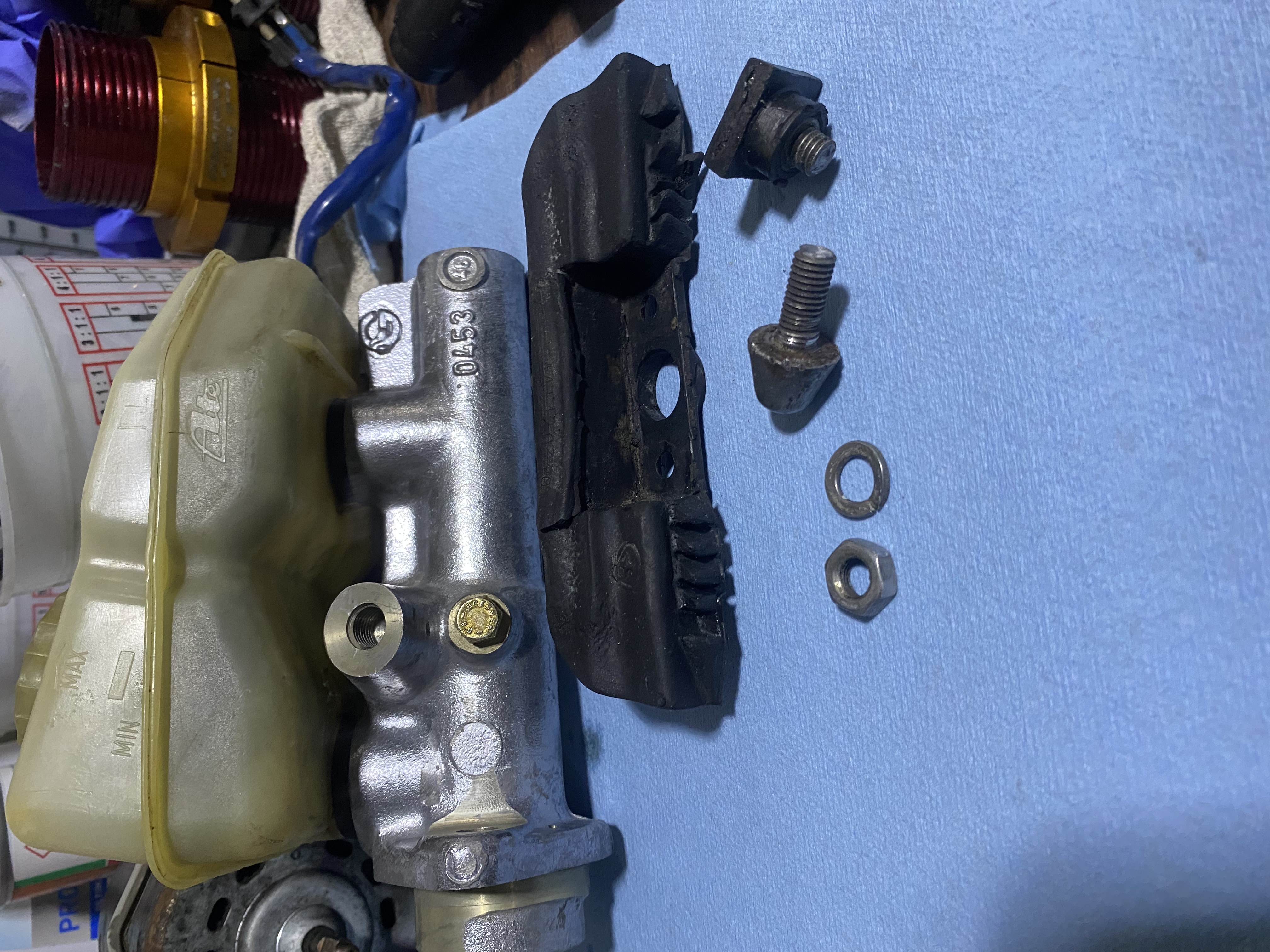

I have not looked yet but has anyone ever purchased this from Porsche recently?
After being submerged in WD40 for over 2 years it did nothing to free the threads from the rubber/plastic insert. I will not be using WD to loosen threads anymore but just as a cleaner. I have a ton of other chemicals to choose from in my locker that are far better. But anyhow if anyone has been able to purchase this new from the Porsche Classic collection of new parts please reply.
Thanks

I was in the middle of cleaning it and turning the pin when it twisted off

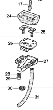

Last I checked, only the entire receiver was available from the dealer. PET seems to only show a complete unit #26 (#30 is described as "rubber sleeve")
Screen Shot 2022-01-27 at 4.45.58 PM.png (38.68 KiB) Viewed 1089 times
When I got my delrins, I did have to replace the o-ring with a stronger one.. but that did the trick

danmartinic wrote: Thu Jan 27, 2022 1:48 pm Last I checked, only the entire receiver was available from the dealer. PET seems to only show a complete unit #26 (#30 is described as "rubber sleeve")
You're right. I keep a little log of work I do on the 951. Here's the smoking gun entry:
August 8, 2014 – rear hatch popped open on freeway. Delrin seats are too hard to adjust, so order new clasps and pins from 944online.
