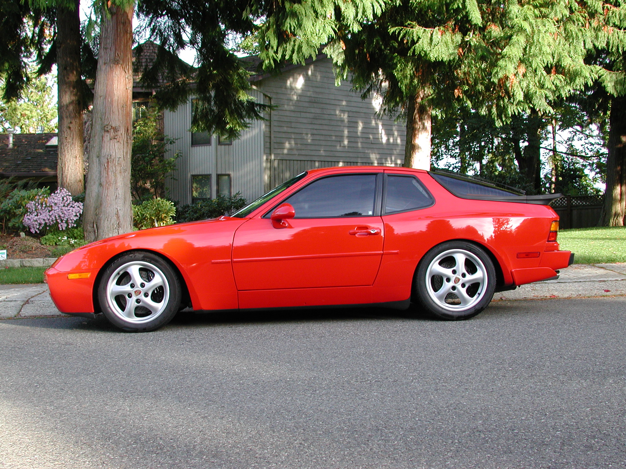

About 20 years ago (still have them) I ran a set of 996 17" twist wheels, and they fit fine. Boxster wheels should be similar, but I believe the offsets and widths are slightly different. Here's an image on my S2 back in the day; currently running 18" BBS RS-GT.onspeed wrote: Mon Dec 23, 2024 9:18 am Regarding 17" wheels, for a late offset 944 - what porsche OEM wheels fit without needing a spacer to clear the bearing dust cap on a 944? From scattered forum posts it sounds like only the 964 cup 1 and 993 cup 2 wheels? Anybody with experience fitting Boxster and 996 17" wheels?
