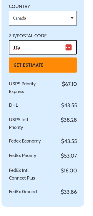

Deemar
Posts: 60
Joined: Sat Aug 17, 2024 9:31 am
Tom wrote: Sun Nov 24, 2024 9:24 am
Deemar wrote: Sun Nov 24, 2024 9:19 am Thanks, if they're special then I'll order them from Porsche locally. Ordering online will be $50 for shipping.
Pelican will ship them first class for $4.99 :angel:
Not to Canada.

Yikes! Dealer it is! :)
