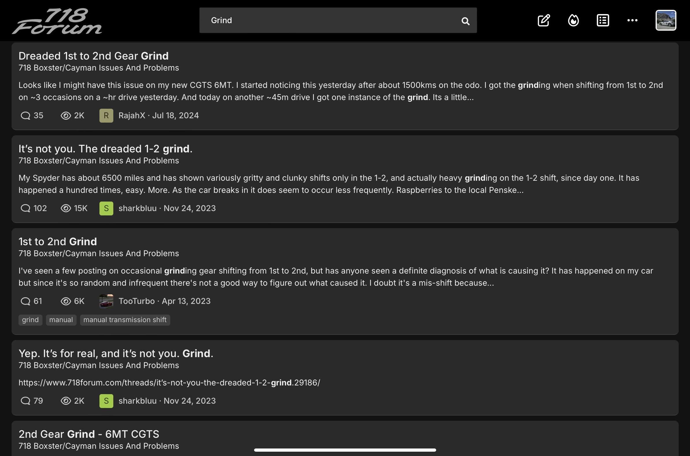

A lot of chatter on the 718 Forum
https://www.718forum.com/search/330162/ ... =relevance
