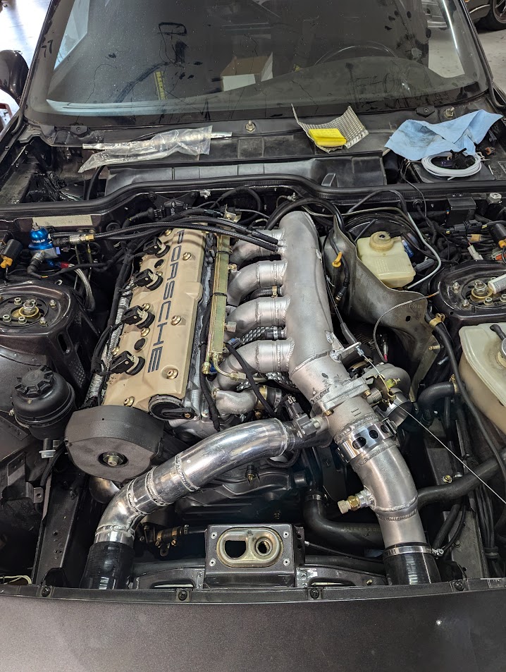

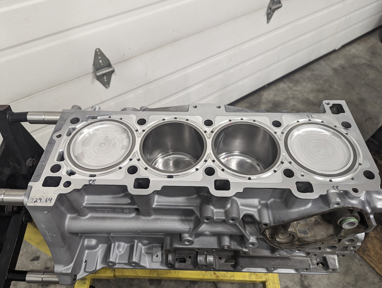

Looks great! Love the Wiggins style clamp. Maybe add boost braces to the others. What deck plate is that? Why the 3D printed cam gear housing? Anyway to straighten out the I/c pipe paths a bit?
TC72
Posts: 20
Joined: Wed Apr 17, 2024 11:15 am
Been thanked: 17 times
Tom wrote: Wed Sep 11, 2024 7:34 am Looks great! Love the Wiggins style clamp. Maybe add boost braces to the others. What deck plate is that? Why the 3D printed cam gear housing? Anyway to straighten out the I/c pipe paths a bit?
I'll add braces if I have an issue with them coming off, but so far no issues. There's no good way to straighten them, and they're pretty short now.

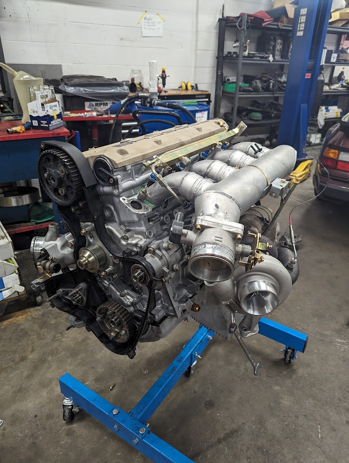

I got the engine running last year, but the oil flow control valve for the head failed, the cam seized, and shattered the gear and housing. All the old magnesium parts are warped and corroded, I don't need a distributor, so I decided to make a new one. I didn't leave enough clearance for the bolt, so I'll print a new front half over winter. I may add some cosmetic ribbing or something too, if I feel fancy that day.
I made the deck plate from a pricey piece of low expansion aluminum to get as close to alusil as I could. I have some revisions I would make if I ever make another, but I mostly want to get time and use on this to prove my take on the concept work reliably.

I've formed a heat shield similar to the one over the manifold on the exhaust side, and teh one between the up p ipe and block(I don't think they are captured in the pictures), tacking a pair of nuts to the turbine housing to secure it is on the list of houskeeping items.
Updates to the cam housing will be adding a bump for the bolt, some cosmetic items, and for myself I am going to add a spot to mount a K20 cam sensor on the front. I spent a lot of time to make sure the OEM cam sensor fit at exactly the right distance, and was lucky enough to have a bad sensor out of the box! So the change to a K20 sensor and a longer stud in place of one of the three distributor rotor bolts will provide a new phase sensor signal.
Once I'm happy with the fitment, I'll gladly share the STL or print them for people who don't have easy access to a printer.
