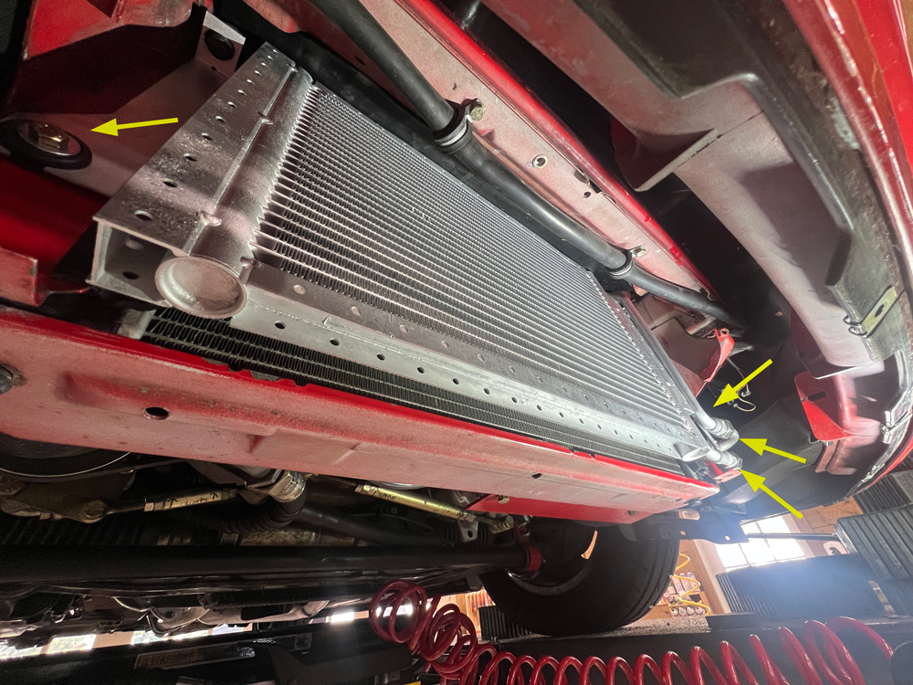

Well, I got a sniffer and was waving it around under the hood and got to where the intercooler tube goes down to the front of the car and the sniffer started reacting. I pull it away and it settles down - move it back there and it starts beeping furiously again. It seemed like it was right in there at the condenser. Tom, how big of a job is it to get the condenser pulled out? I'd imagine the front plastic nose piece has to come off?

You might want to try some dye to confirm, just in case it's coming from the fittings or something, but it does sound like you have a leaky condenser.
Removing and replacing the condenser is surprisingly easy. The hardest part is removing the black lip under the front bumper. Other than that, the bumper cap itself stays on. The condenser is held in the car with two M6x20 bolts. You just remove those, and undo the two refrigerant fittings, and possibly a little rubber clamp that holds the refrigerant lines to the side of the condenser, and the condenser slides right out the bottom. The top of the condenser is locked in place by sliding over two rubber mounting nubs. I don't have the batwing on my bumper these days, and have the luxury of a lift, so with all that I could literally have the condenser out in 5 minutes or less....

If I were to pull the condenser off and want to pressure test it, would a person want to cap off the two lines before driving the car - or should I not drive the car til the condenser is back on the vehicle?

As long as you change the receiver drier on re-assembly and pull a good vacuum, I'm not sure it matters all that much for a day or three. I put little silicon plugs in the fittings to keep oil from dripping out.

I'm a fan of keeping the system closed as much as possible, especially if you are driving the car. Tom's plan with the silicone plugs is great. I think I have a collection of those originally purposed for powdercoating projects.
Especially when the car will be driven or otherwise at risk for those plugs falling out, a nitrile glove offers five different-sized prophylactic sleeves to slide over the exposed tubing or hose connectors. Secure those with cable ties, tape, or even rubber bands.
Similarly, I'd have the connections on the condenser itself protected as soon as they are open. With the tape wrapped around the finger sleeves, there's a certain amount of mechanical protection for the threads. Plus, unless the front area of the car is surgically clean already, it makes sense to keep stuff from getting into the condenser as you R&R it. Isopropyl alcohol is pretty good at removing the adhesive residue after common electrical tape in this instance, should that need arise.
If you do plan to drive the car with the condenser out, take a moment to unplug the compressor clutch coil wire and secure it safely. The systems have low-pressure protection and of course we'd never accidentally hit the AC button by accident on a warm-day drive. But, just in case, ...
