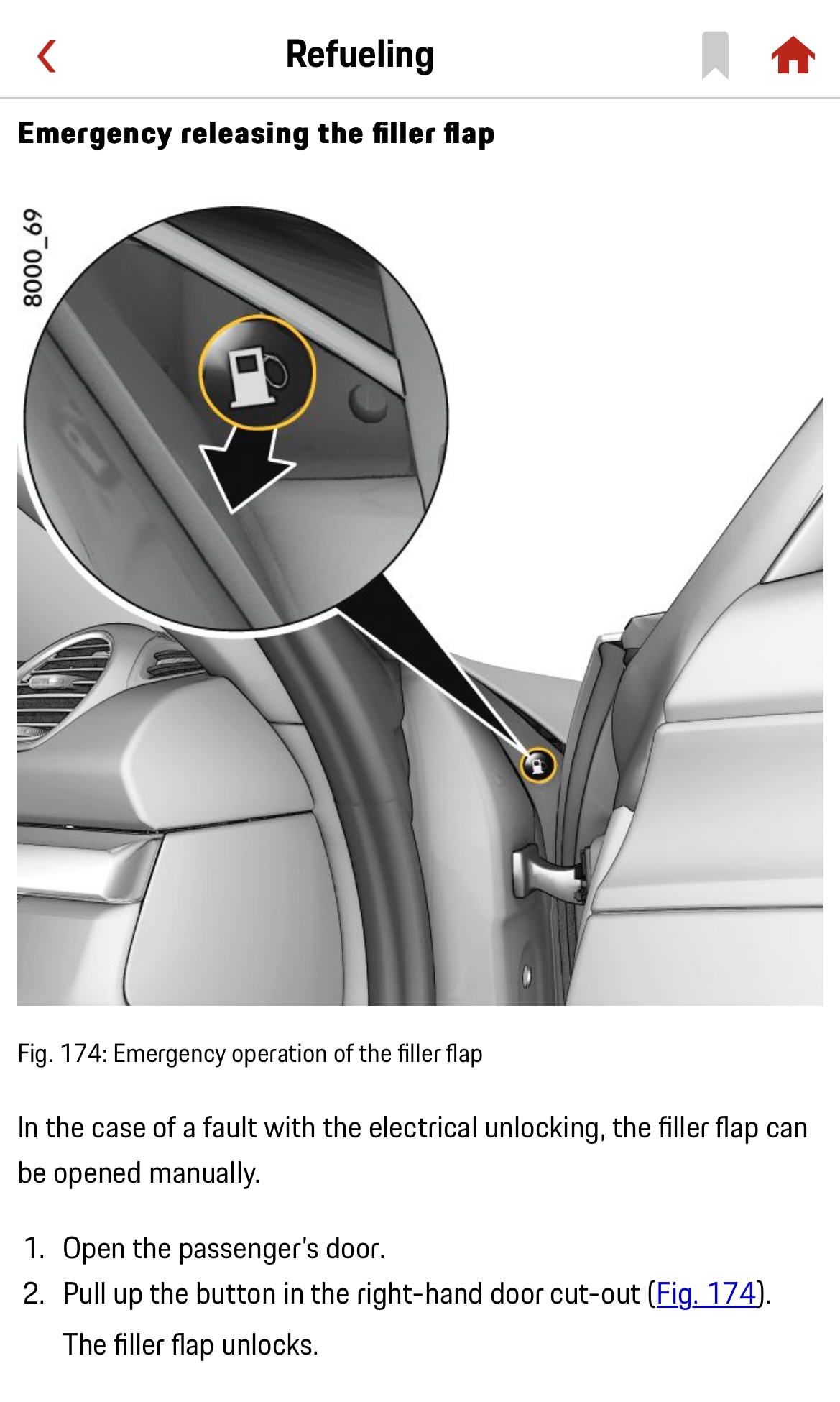

Sounds like the latch (or catch) might not be fully releasing? Failing actuator. Good thing there is a manual fuel door release - just in case.

Adding this for future reference:

No problems with my GTS, and yours is also a new lady so no problem to pop into your Dealer and have them check her over for free. In my past life ( 30+ years in the Automotive Industry selling ICE machines - pun intended ) there were cases with doors on different brands and it often was a misalignment issue from the factory. Your Dealer should be able to check and make sure the release is fully disengaging since it has an electric contact system.

No problems here as well. Could the emergency assembly be interfering somehow?
