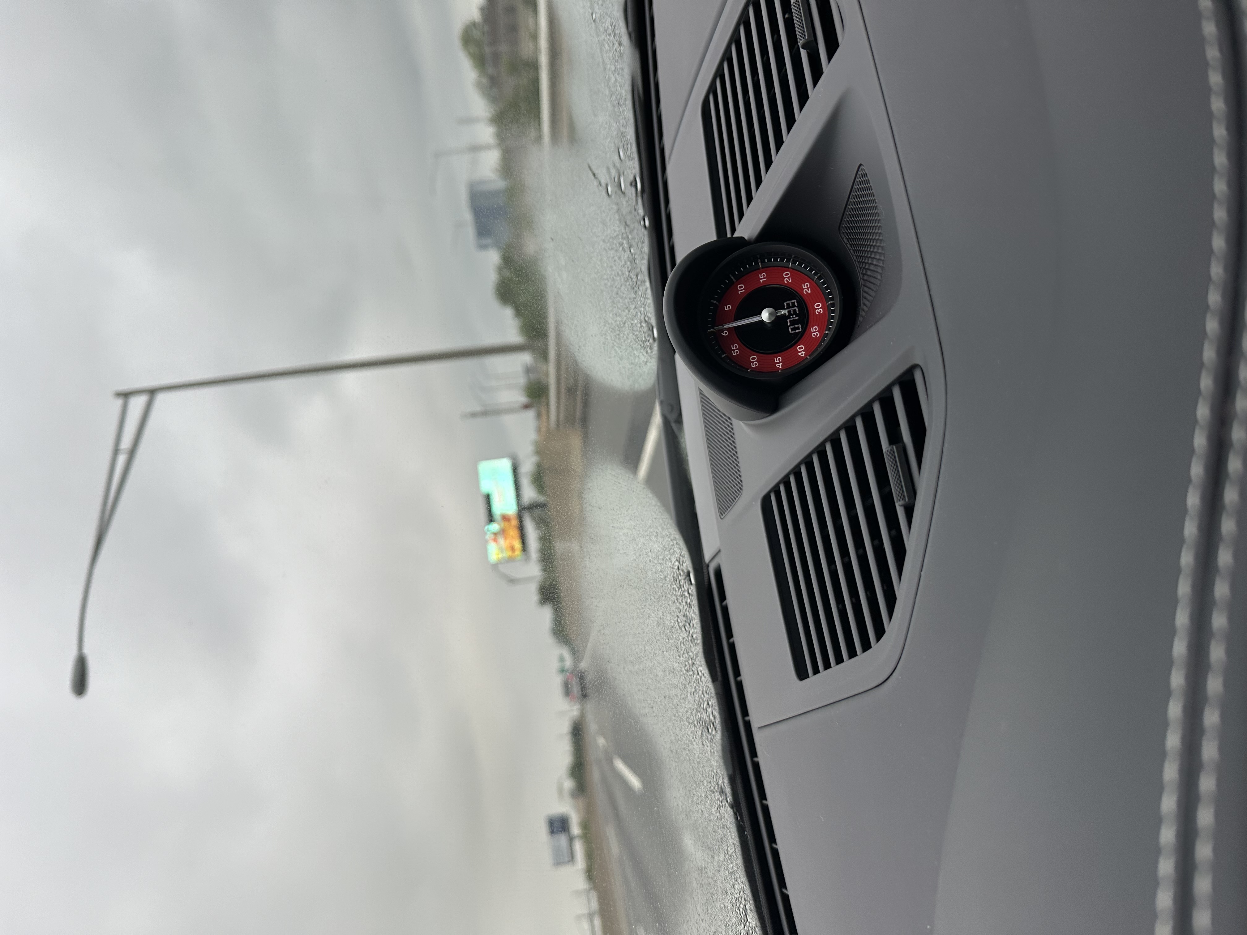

See photo. What is the remedy during air-conditioning operations? Any idea why summertime weather causes the exterior windshield to steam up? Only happens on my 2023 Targa. Not on my 2017 Carrera.

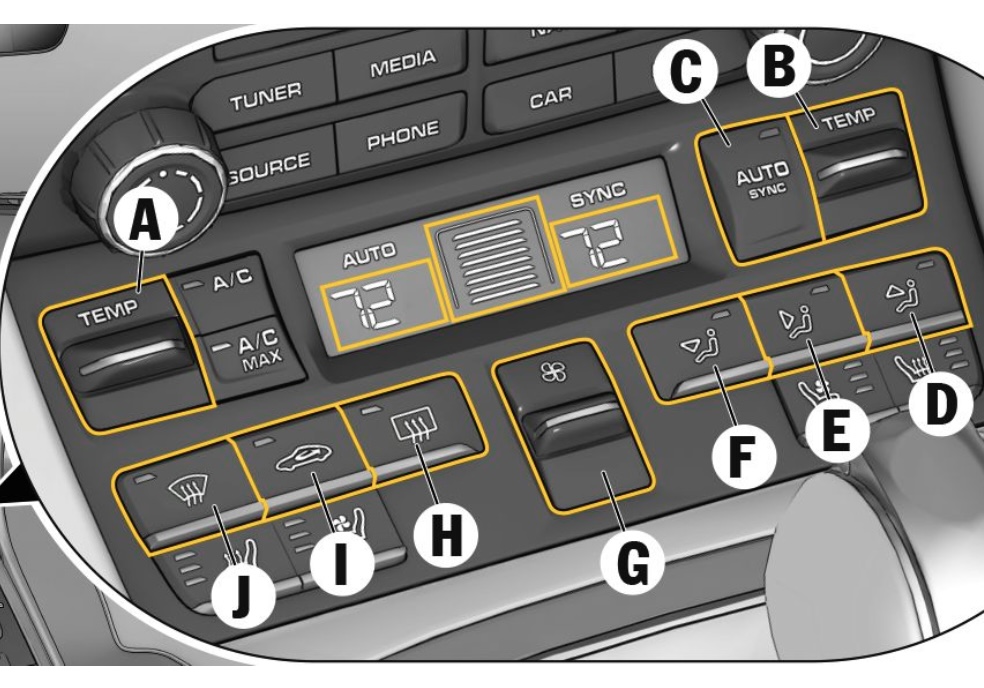

I would start by setting airflow to avoid the windshield. In the included example that would be E & F.

The warm summer air held a lot of water, some of which condensed on your cold windshield. Use your wipers to clear the water; adjust your a/c outputs to avoid the problem.
