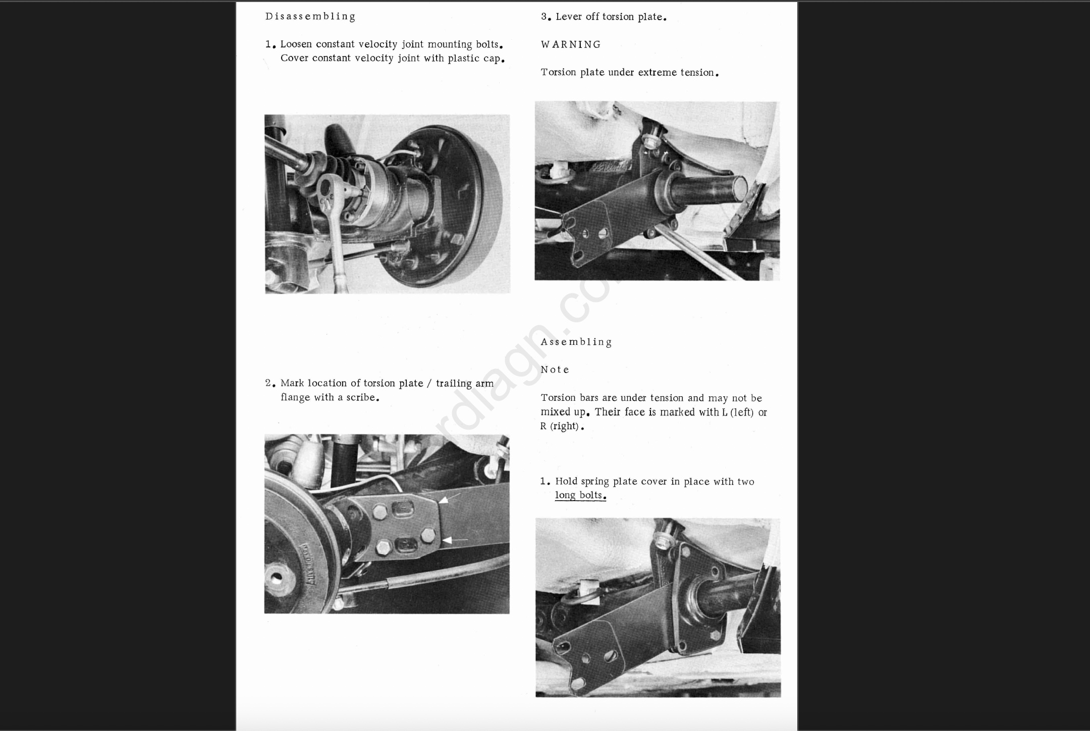

By "relaxed," I mean with no tension on the torsion bar. Spring plate is bolted to the torsion tube, but nothing else is bolted to the spring plate (trailing arm and shock are not attached to the spring plate). Lower spring plate cap to torsion tube bolt is removed to allow the spring plate to fully rotate downward to the relaxed position.944m3 wrote: Sat Jun 29, 2024 12:58 pm Thanks for the detailed response. I think that makes sense.

Once your angle is set, you will need to use a floor jack under the trailing edge of the spring plate, which twists the torsion bar and allows the spring plate and trailing arm to be lined up so the hardware can be installed. The opposite is needed during disassembly, need to maintain tension on the spring plate to allow the hardware to be removed, then the tension is slowly released and the spring plate is allowed to rest in the "relaxed" position of the torsion bar. You *might* be able to attach the trailing arm to the spring plate before attaching the lower end of the shock, which would allow you to jack up the spring plate and trailing arm together to line up the lower shock mounting bolt, which would be easier.
See screen shot from the factory 924 manual (later 944 parts look a bit different, but the concept is the same), both pics on the right show a relaxed spring plate, the angle should be measured at this point to ensure that the ride height is the same after reassembly.

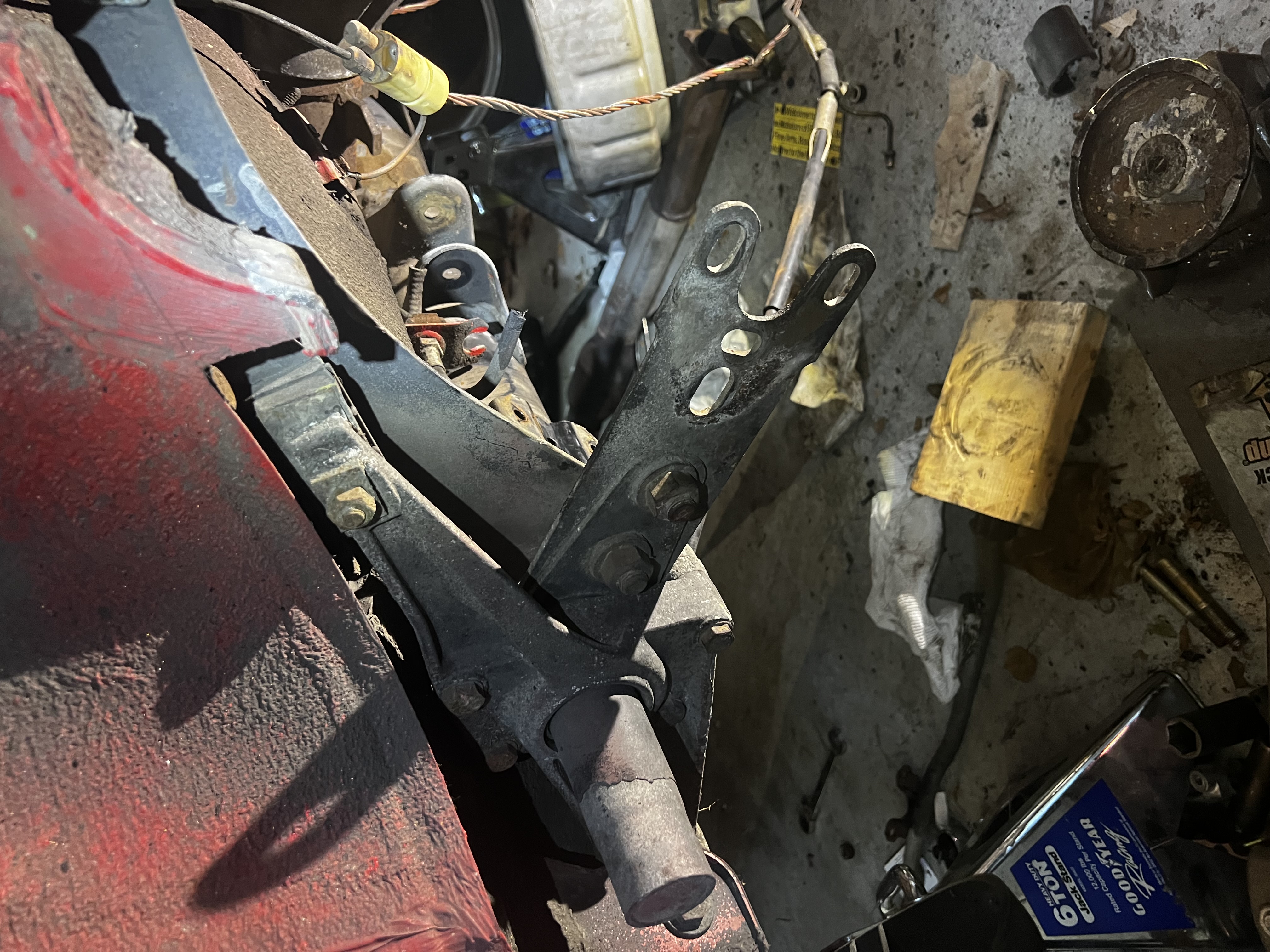

Also, couldn’t I take the angle measurement with the entire carrier off? Before I remove the spring plates.
Any point in saving the anti-lock brake wiring? I’m assuming that is what the wiring on the upper right of the picture.

Yes, it might be, hard to tell from the picture.944m3 wrote: Sun Jun 30, 2024 2:33 pm Actually, the spring plate bracket is keeping the spring plate from fully extending or relaxing, no? See picture.
I also realize that posting pics of the 924 manual might have caused confusion, but the reason I posted the 924 manual and not the 944 version is Porsche usually explains a concept only once, when a model is first introduced (such as how the torsion bar splines work). After that, they assume the technician is forever imbued with said knowledge and subsequent manuals explain only updates and differences between the 924 and 944. One of which is the 924 has a welded-in torsion bar tube, 944 has a removable bolt-in tube, hence the difference in torsion bar end caps.
You could measure the spring plate angle with the torsion tube removed, but that makes it more difficult to ensure the base angle of the torsion tube is consistent while measuring spring plate angle. If it is securely bolted to the chassis while on jack stands, the basic angle of the torsion tube is fixed. Your call, though.

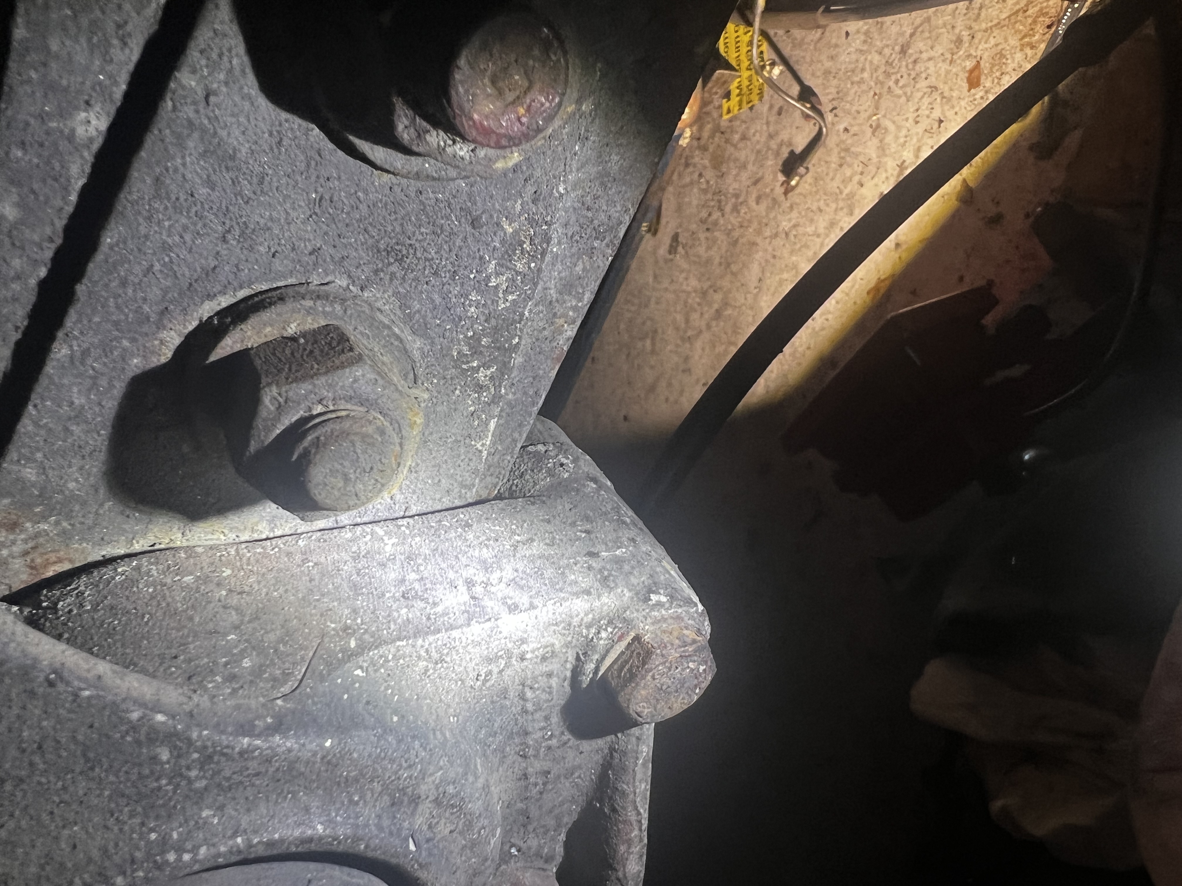

Welp, not sure if I’m happy or disappointed.
Got the carrier off the car and removed the spring plate on one side. To my surprise it came off easily. Looking at the bushing I was again surprised by the appearance, it looks good. I’m able to dig my fingernail into the rubber. I tapped it with my hammer and it responded like good rubber, if that makes sense. In other words, they seem fine. The trailing arm bushings also seem fine, they are playable. (I used a long screw driver to “wiggle” the bushing and it felt “bouncy”).
I can’t tell if they are original or not. I could not see any obvious evidence that anyone had taking any of the bolts off. As far as I can tell it’s the OEM shock too. The car has over 100k miles.
Question, is this normal or should the rubber be hard as a rock? At this point I’m not sure if I should just put everything back together or proceed with swapping bushings. I could use the money for other things for sure.
Thoughts?
