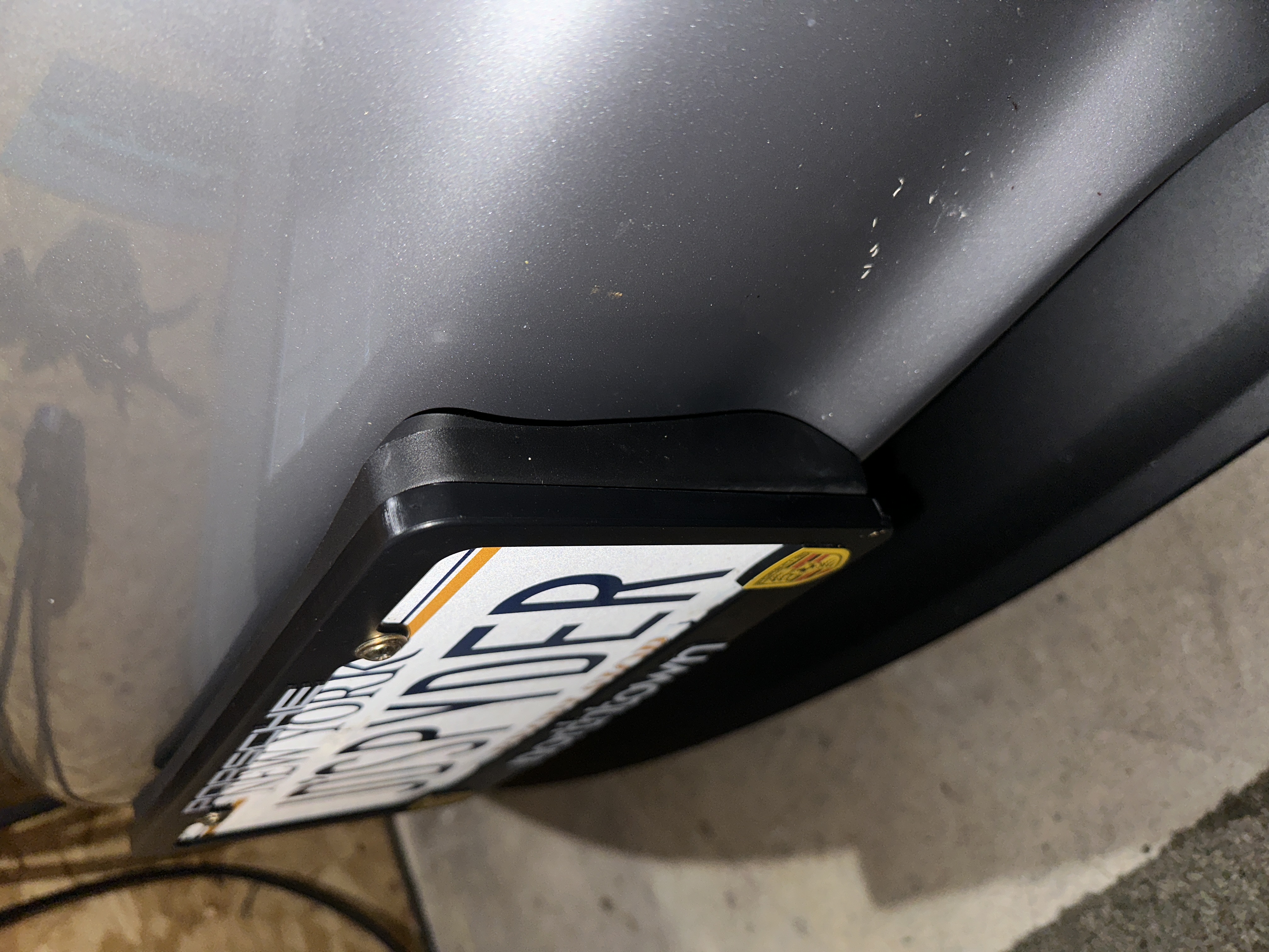

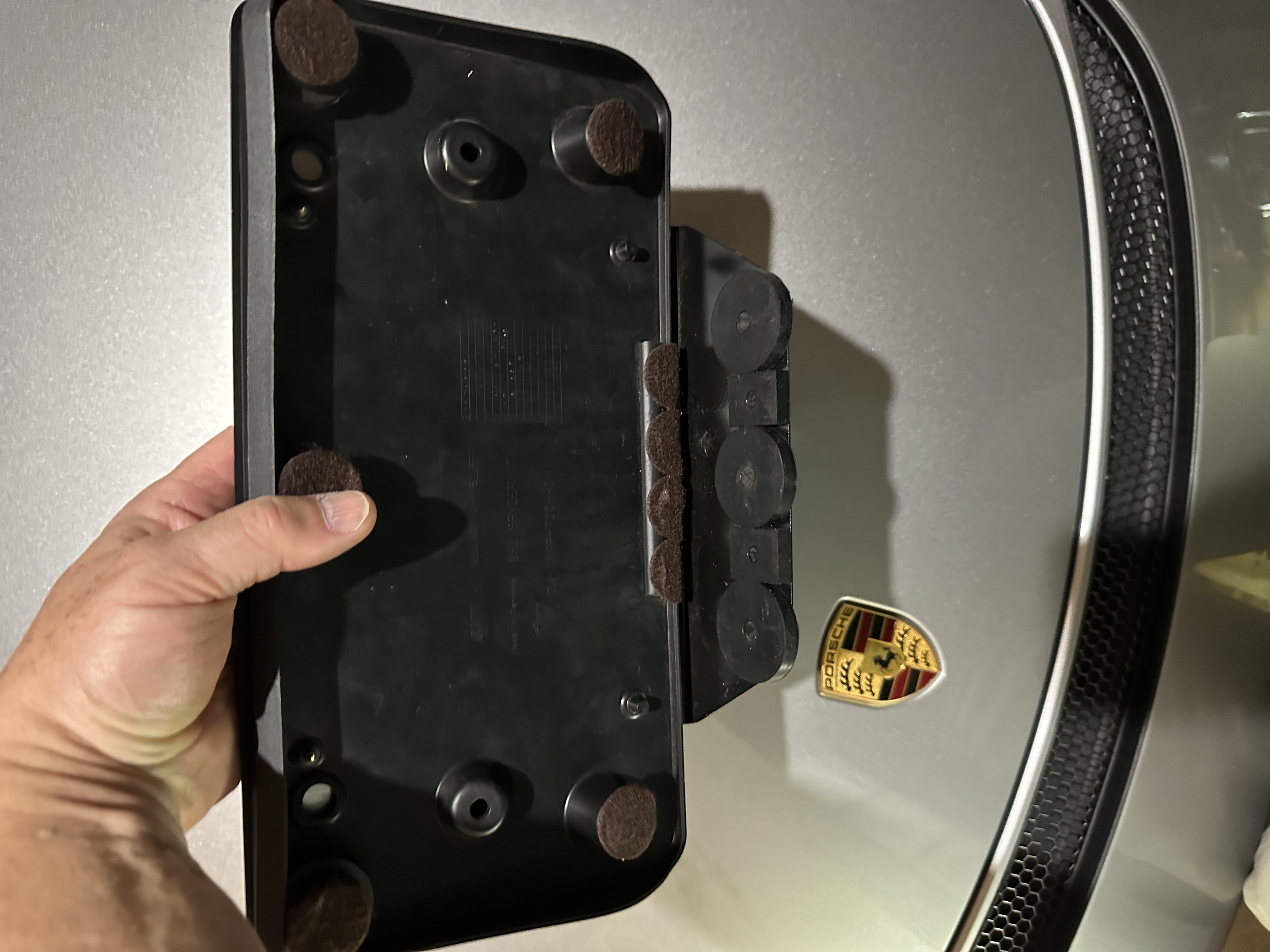

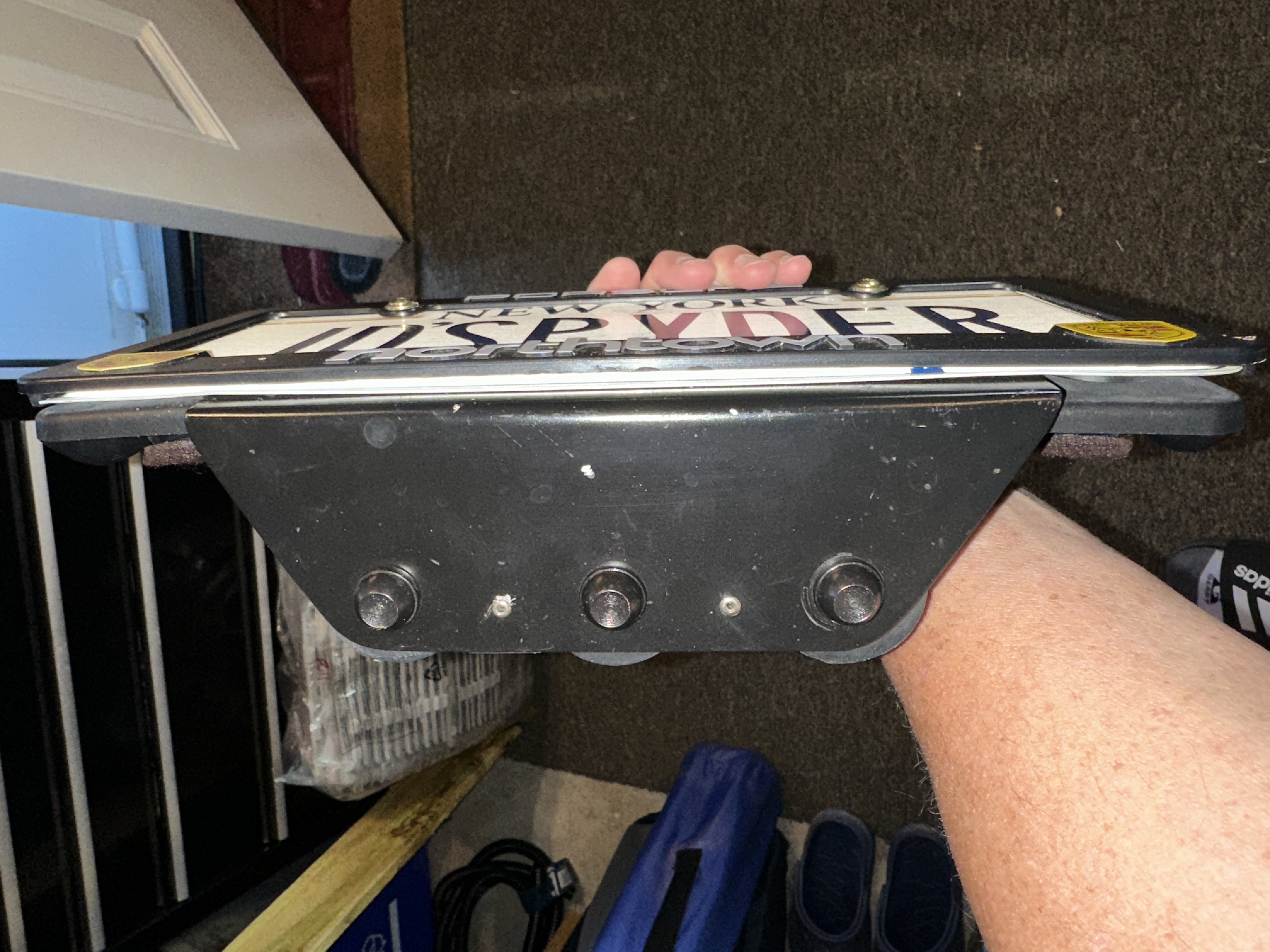

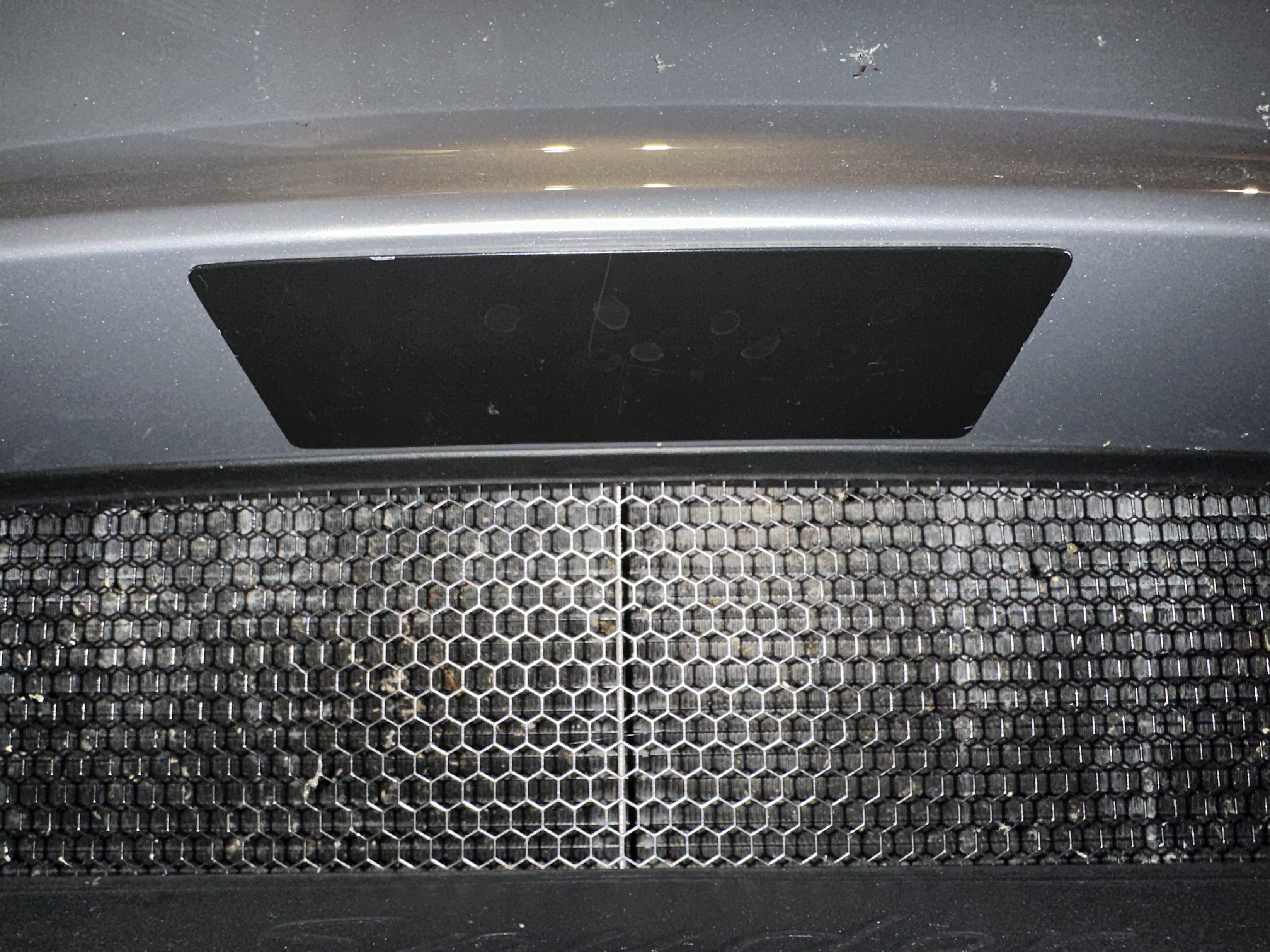

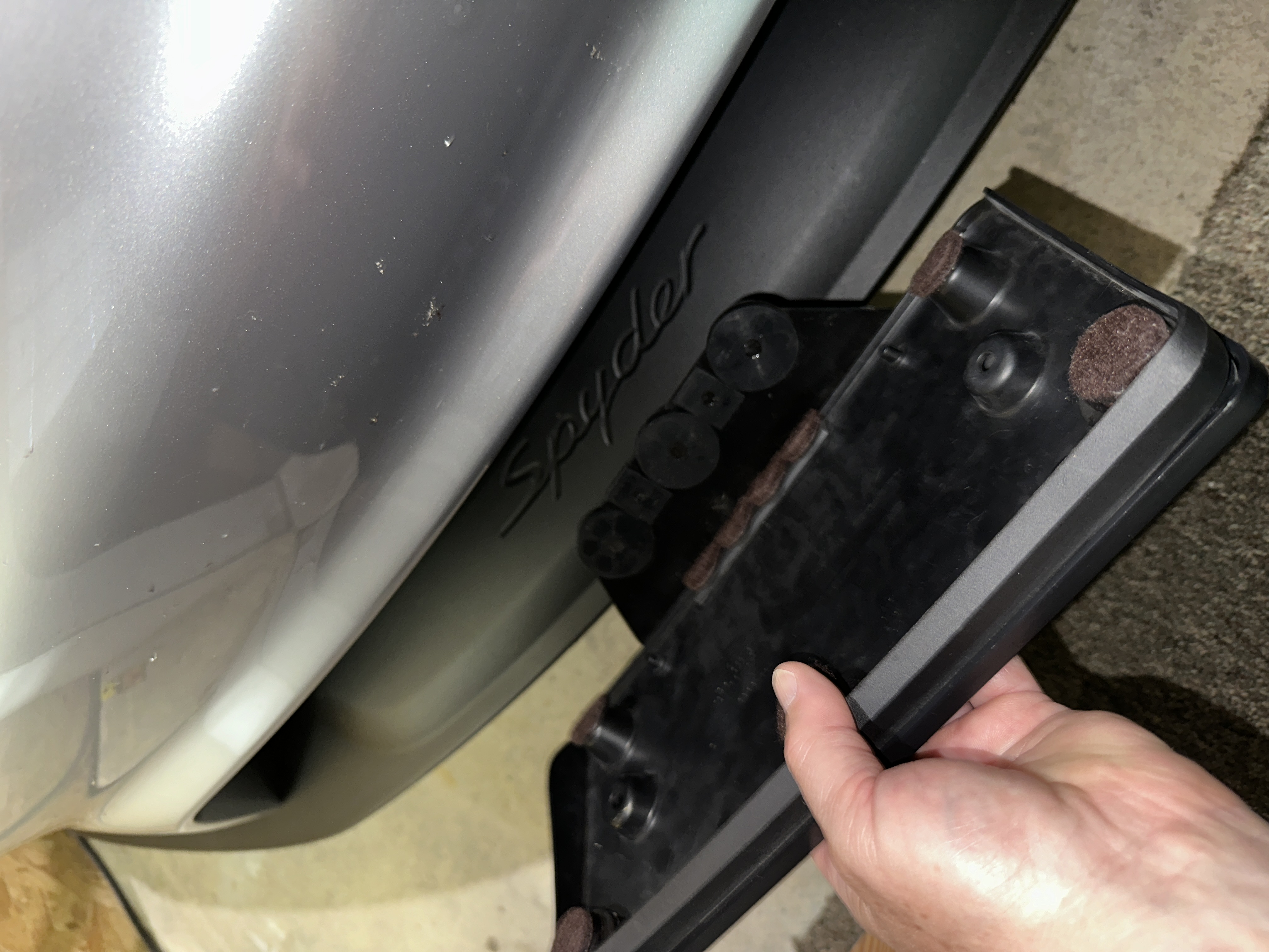

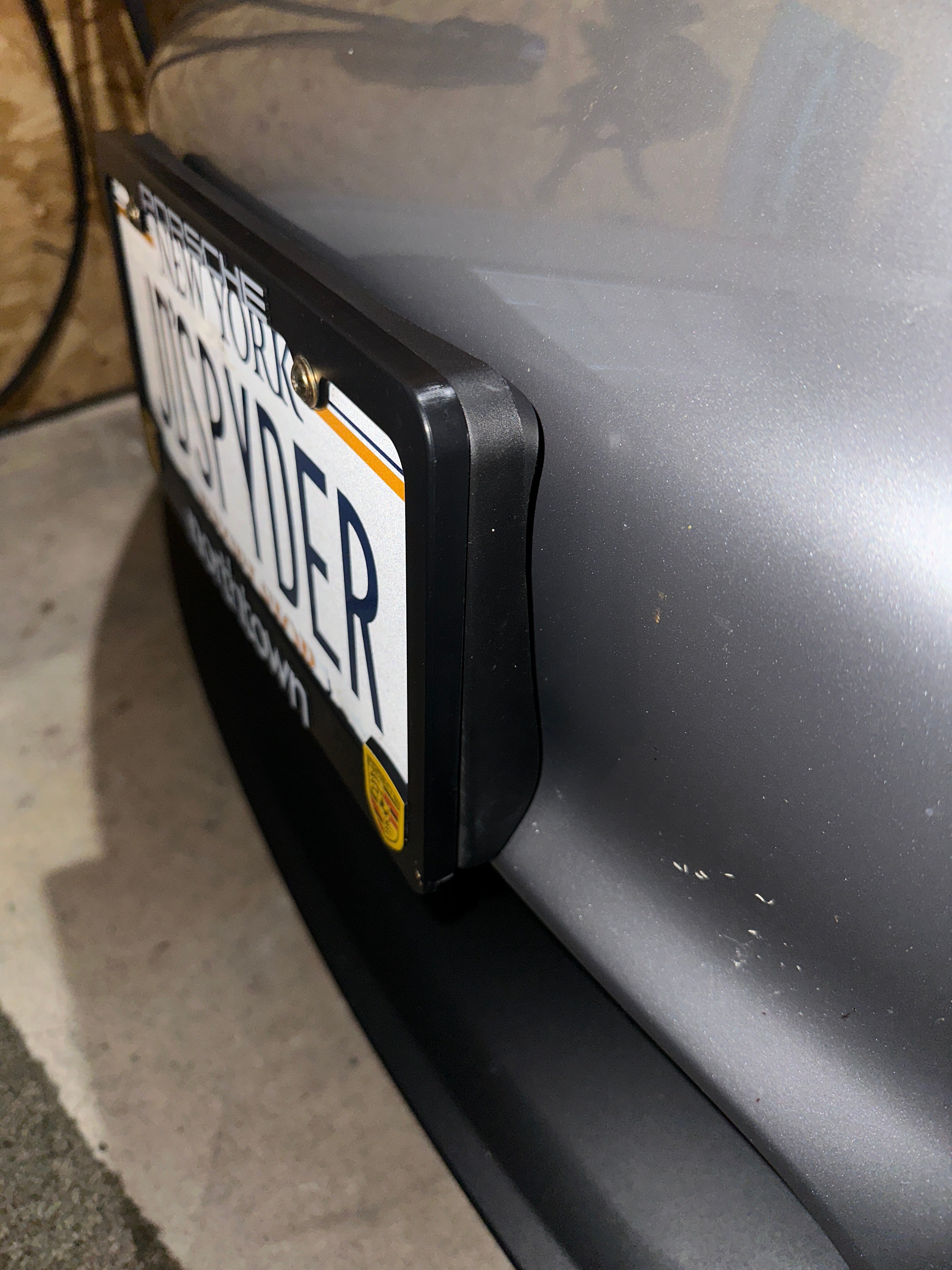

I made myself a “L” bracket that I attached rubber coated magnets from KJ Magnetics to.
https://www.kjmagnetics.com/products.asp?cat=6
If I were to do it over, I’d use 3 of the 38Lb. square ones, as opposed to three of the 30 lb. round ones.
Those attach to a mount under the lip that I mounted to the underside with gorilla tape.
It’s yet to fall off, but super easy to remove or install when I want to.
This is how I made mine for my 718 Spyder, it might not work for your model.
I cut, bent, smoothed and painted sheet metal, but you could probably find something close enough to use/paint at your local hardware store.
It’s basically an “L” bracket that’s opened more than 90* to 100 degrees.
The L bracket has the magnets mounted to it. On my first first go around, the round magnets were screwed with those plastic caps covering the exposed screws, then I added the square ones later for additional strength and those were riveted… I would just use steel rivets if I made it again along with the stronger magnets that I mentioned in my previous post.
It mounts to the front of the stock plastic plate mount, then the license plate is mounted in front of it.
The magnets stick to a second plate that is Gorilla taped to the underside of the bumper.
See the pics, let me know if you have any questions.
