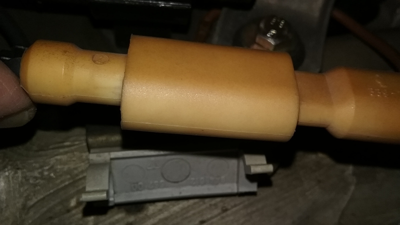

Can anyone give me a condensed version of things to look out for when buying a used 3D printer? I want to print small discontinued plastic Porsche parts like the brake wear sensor connector clips pictured and also some of the files available here.
I've got my eye on a Creality ender 3 but I'm not sure if this model is up to this task, what mods, if any it would really need, etc. I run OpenSUSE Linux exclusively and would be using Ultimaker Cura to drive it.

What is your budget? For most car parts, you want to print in ABS or better. ABS is much easier to print in an enclosed printer. It can be done with an open printer, especially if you make and enclosure for it, but one of the enclosed Bambu Lab printers like the P1S would provide reliable hassle-free prints (or its knock-of (?), the K1C if you are a Creality fan). I'd be pretty leery of buying a used printer unless you can run some test prints first. Absent physical damage, you can't really tell healthy printer from a bad one ust by looking. Most printers can use any slicer, like Cura, but most printers use a default slicer tailored to it, so I wouldn't go in with one slicer in mind -- use the one best suited to the machine you get.

Thanks Tom. Why enclosed? is it a draft thing?
Re: Used 3D printer buying tips??
Posted: Wed Jun 12, 2024 9:40 pm
icb wrote: Wed Jun 12, 2024 9:20 pm Thanks Tom. Why enclosed? is it a draft thing?
It's really the heat. When you print ABS at room temp, it's much more inclined to warp and lift off the print bed. With a heated bed inside an enclosure, the temp inside can get up over 100, which dramatically reduces that problem. The high-end printers have actively heated print chambers for even higher-temp plastics.
