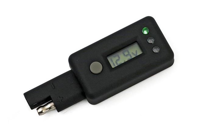

If you charge like I do where you charge the battery and then disconnect (provided you do not have a high current draw while parked), I call it spot charging, you might consider one of these from Battery Tender for under $20.
If the charge cables attached to your battery end in a SAE connector (most do except CTEK and others like it), get one of these to monitor battery voltage. Press the button and the display stays on for 15 seconds and then switches off.
