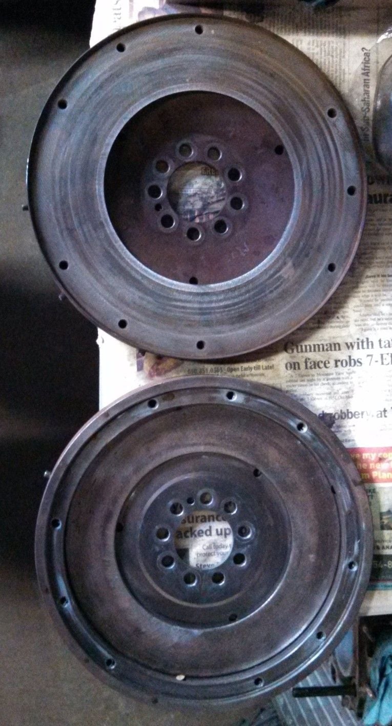

Top photo is 951, bottom is 944.
Sometimes it's difficult to understand if you can't visualize. Some further 944 vs. 951 clutch/flywheel differences:
Clutch diameter 951 is 240mm
Clutch diameter 944 is 225mm
You can't mix and match clutches and flywheels between the 2 models.
If using a 951 clutch and FW, you must use a 951 bellhousing.
