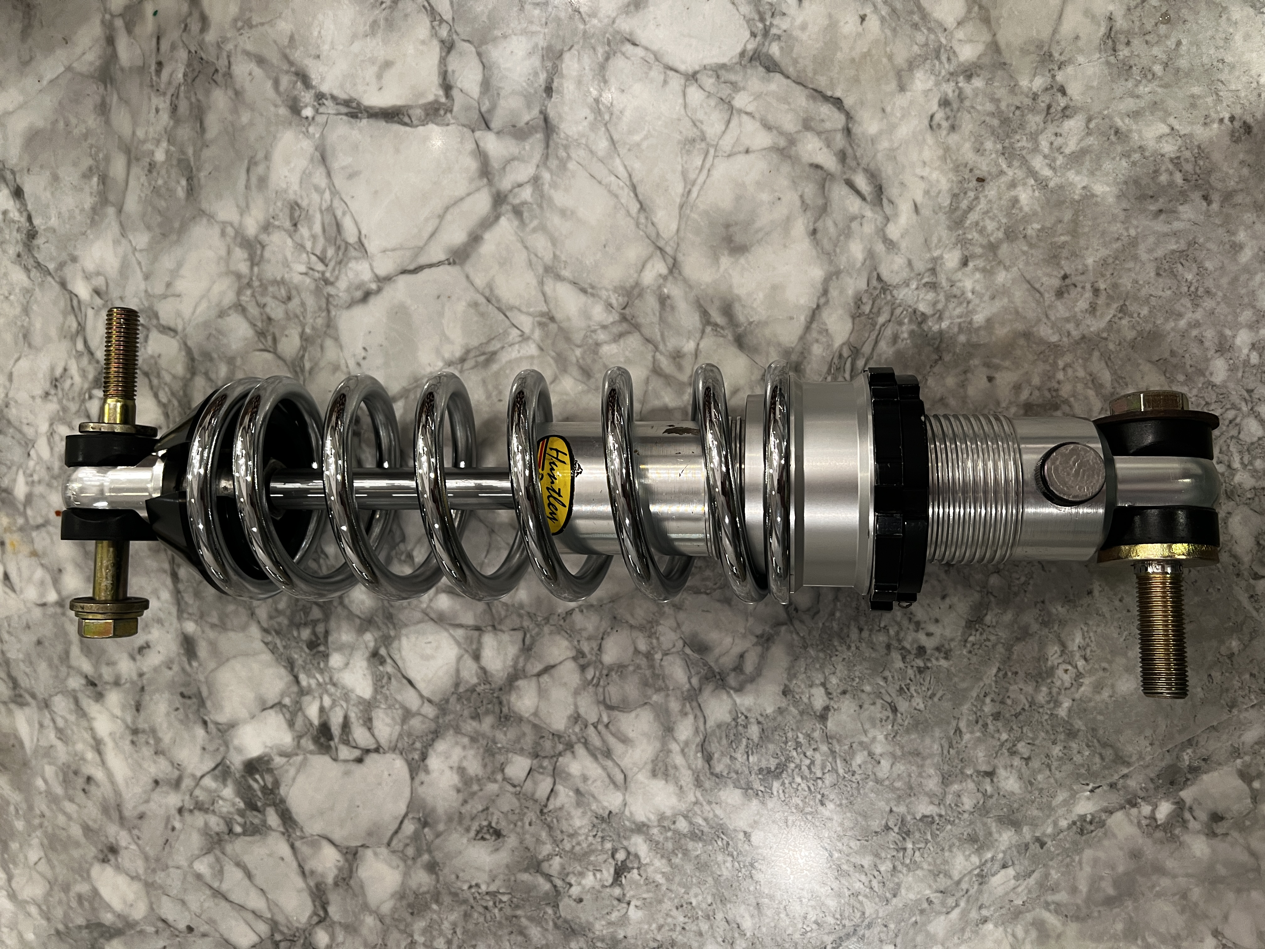

I purchased these Huntley Racing adjustable coilovers cheap years ago. They seem to be in very solid condition. They look barely used to be honest. The adjuster seems to work well, I can adjust to where I can’t move the damper to easyly moving it. I know I can purchase needed hardware and springs. (Will figure out spring rates when I cross that bridge).
To be clear, I’m not looking for performance or even an improvement in the current suspension setup. This is my daily. If the rear feels the same then I’m happy. My only goal is to get out of dealing with the torsion bars when putting everything back together.

I ditched my torsion bars and have been very happy with the decision. But, if you are renewing the bushings, the spring plate rubber is a challenge to remove, though it is much easier than re-indexing the torsion bars. For a street car, I would recommend the Racers Edge Delrin spring plate bushings instead of the ER polybronze. The grease in the polybronze attracts every piece of grit flying along under the car. Not a problem on the track, but requires regular attention on a street car. I have the ER polybronze spring plate bushings on a street car and this has been my experience..

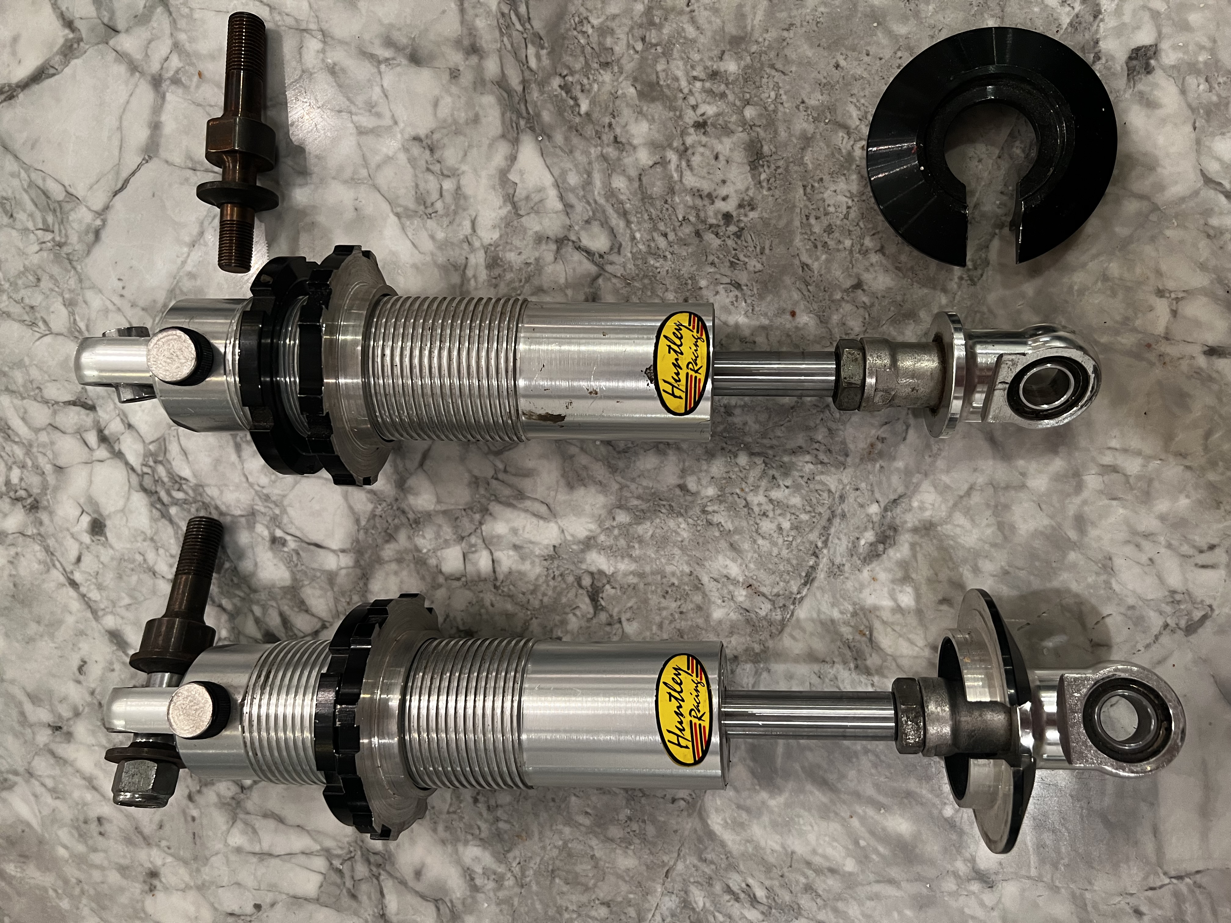

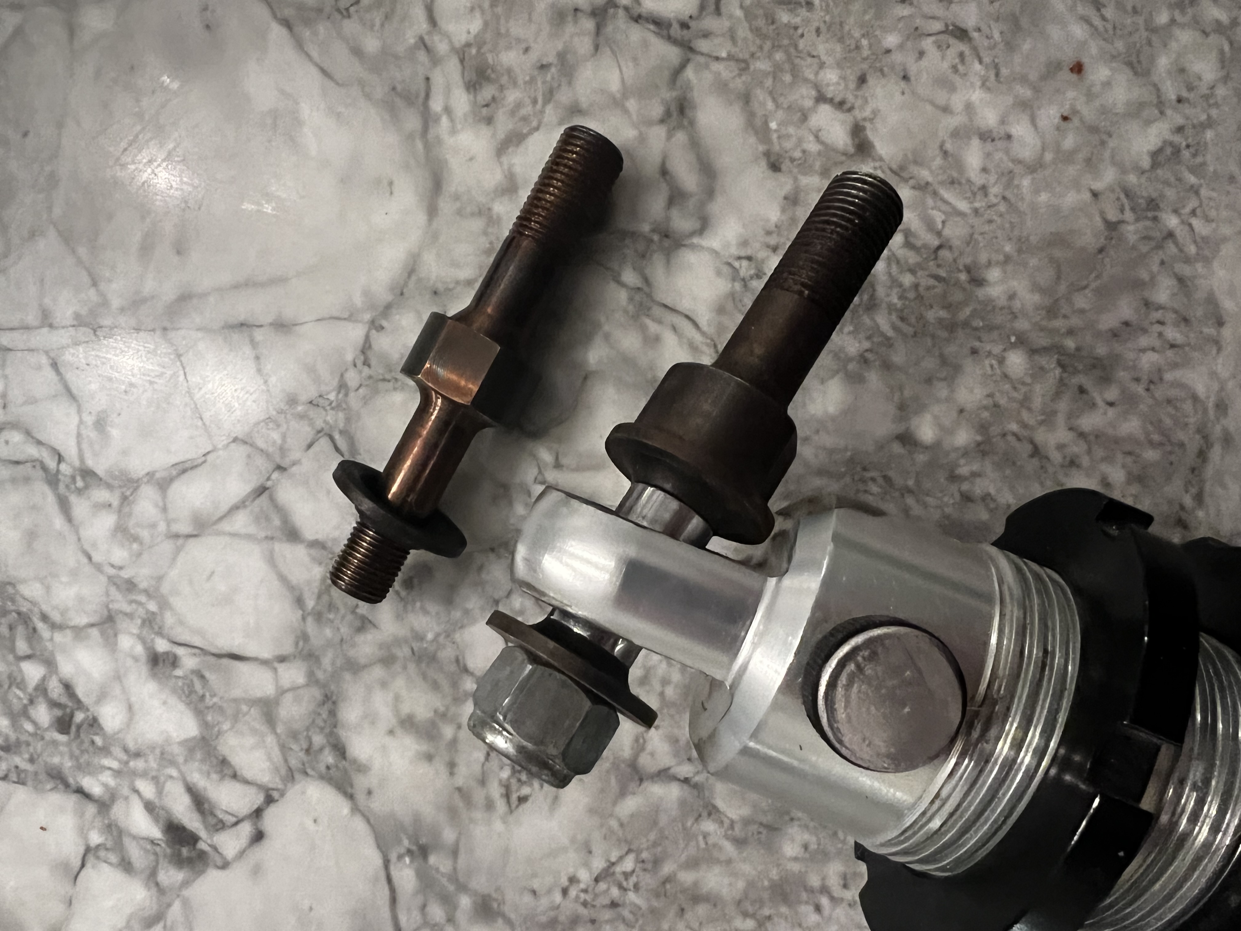

The mounts you are showing in the photo actually go on the opposite end of the shocks and bolt into the control arm. You should buy a matched set of adaptors, and measure the depth of the threads and adjust with washers to avoid bottoming out the adaptors. You can get new lower adaptors from Racers Edge or Paragon Products and probably some others. Do you have the rest of the hardware?

No, that is all the hardware I have. I know it’s not complete. I saw the racers edge bolts I need to buy.

If this is a street car, I would advise against those rear coilover shocks that have been sitting for 20+ years. I can almost guarantee they will be too stiff and you will spend a lot of time and effort dialing in the ride height and damper settings. The lower mounting bolts also look puny and suspect, would not trust them if deleting the torsion bars. Racer's Edge sells a much better mounting system for the rear lower part of the dampers:

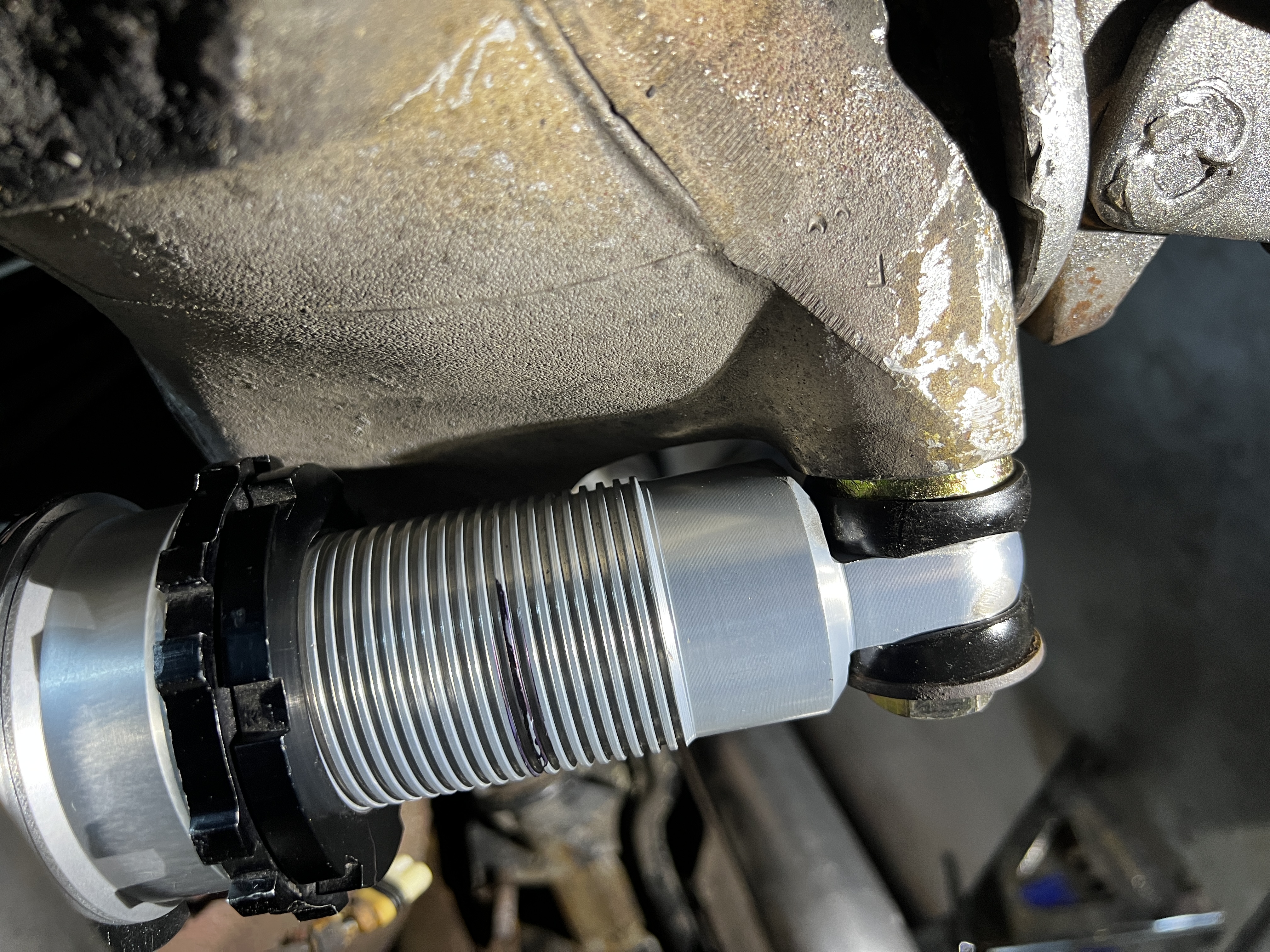

Welp, I couldn’t help myself. After some more research I ended up installing the coilovers.
To recap, I replaced all my rubber bushings in the rear suspension. This called for removing the torsion bars. I miscalculated the TB install and the car sat to low, sitting at about 12 3/4” inches from hub to bottom of fender. The tire would hit the fender wells in certain situations, not good. In addition, I installed new yellow Koni shocks. They are to firm for my liking, not bad but just to firm.
To be clear, I am too lazy to remove the TBs again and raise the car. Plus I was just curious to try the Huntley coilovers. With that out of the way…..
I figured that I basically reindexed the TBs as needed to install coilovers so might as well try them. My thought is worse case scenario if they fail the TBs are still in place and I could still drive the car.

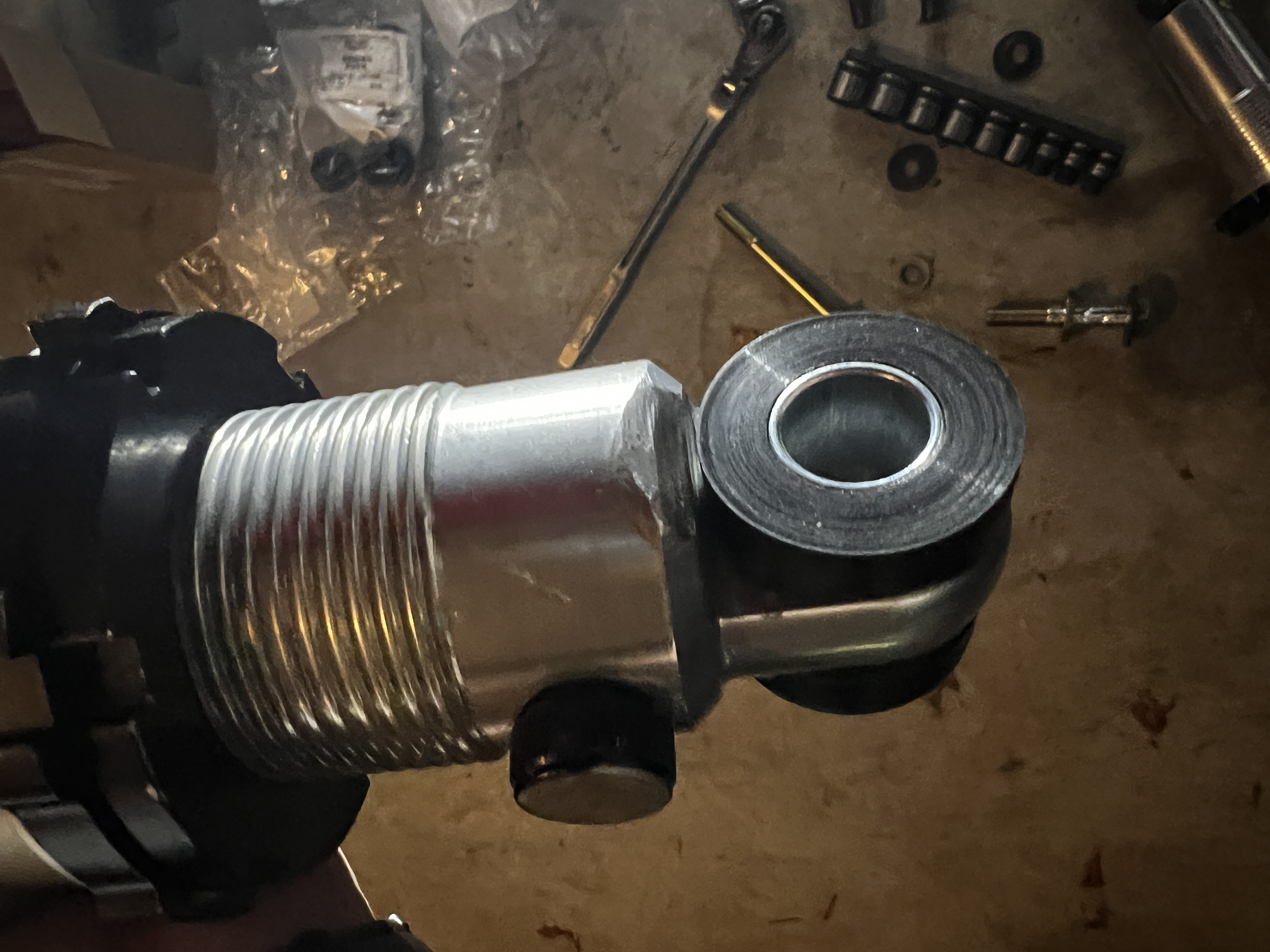

I found a few old posts on how to install QA1 coilovers. It was great advice and it worked for me. I did add 4 things that are sold by QA1. First, a 2” top hat, which gave me more clearance at the top mount, 8” inch 200lbs springs, a 2” spacer that goes at the bottom of the spring, and poly bushings. I also purchased 10.9 zinc plated lower mounting 5mm longer bolts for extra strength. See pic below.

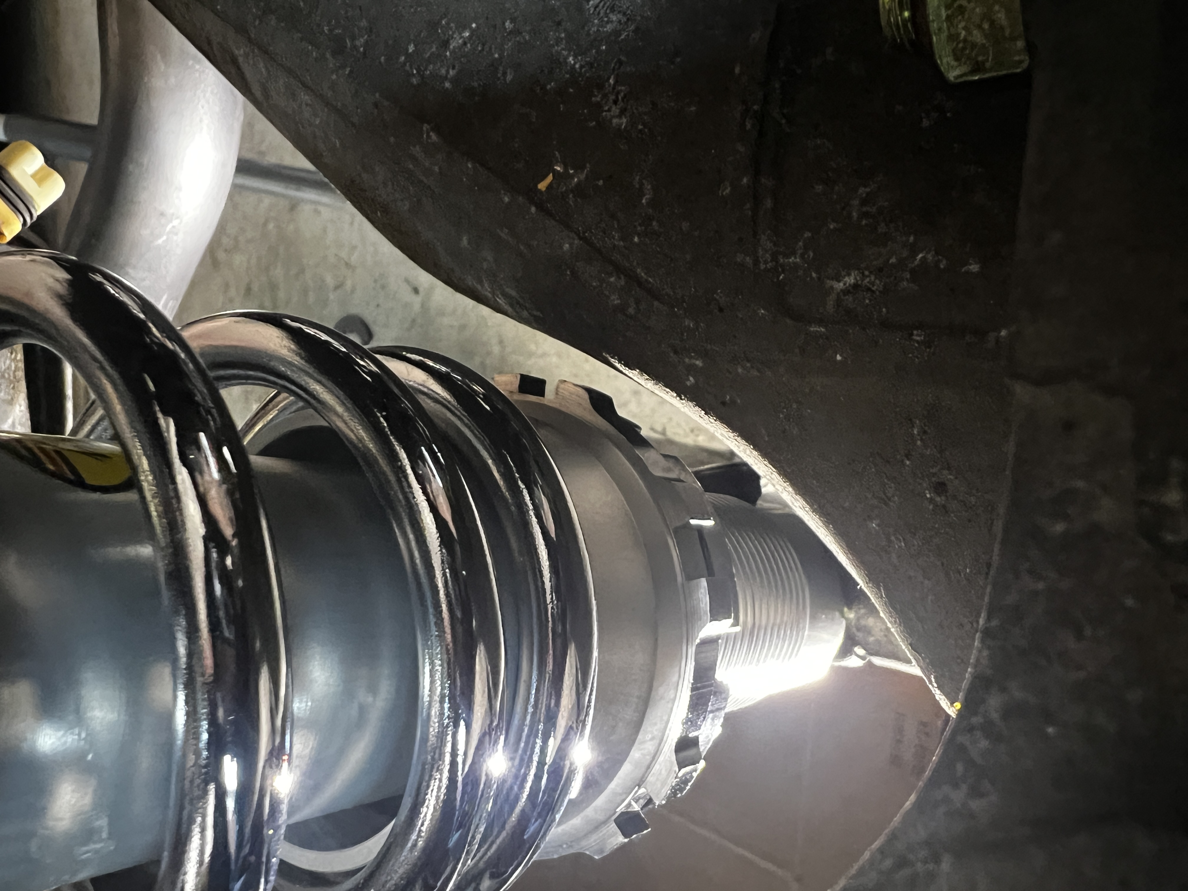

Drove the car first time and it felt very good. The Huntleys have 12 positions dial to adjust damper. It works very well and I can reach it and adjust without having to lift the car. A big plus. I started with 1 click at softest setting but it felt a bit to “bouncy” so went to 4 clicks. That felt much better. Firm but not jarring like the Koni’s. I will probably play around with it and try other settings.
The height is now at about 14” (hub to bottom fender lip). I can probably lower another half inch. Will try that later. The springs have about 1” to 1 1/2” of preload. I believe the spring has enough preload so that it doesn’t move or rattle when unloaded.
