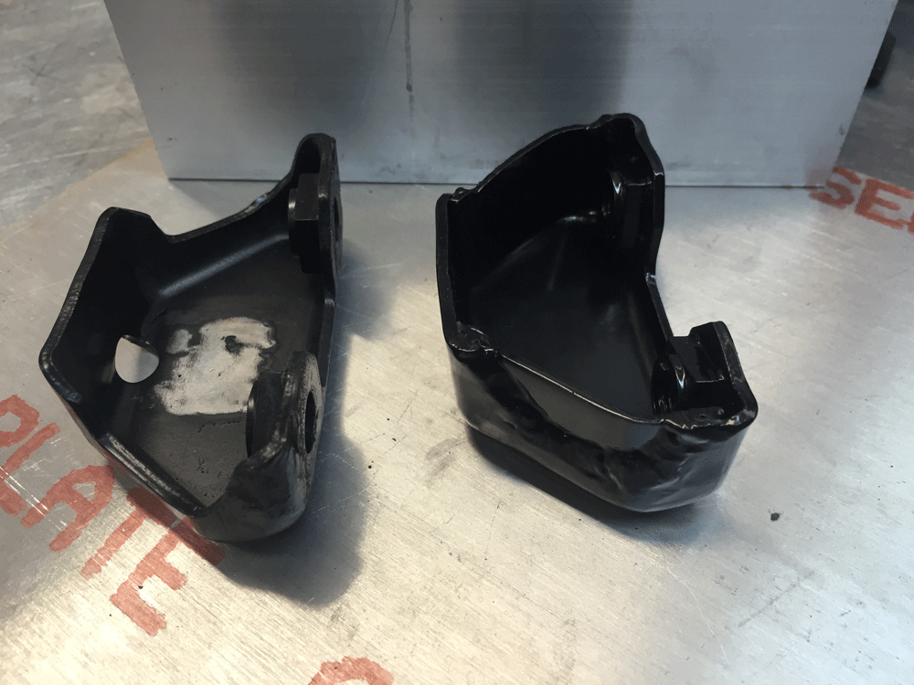

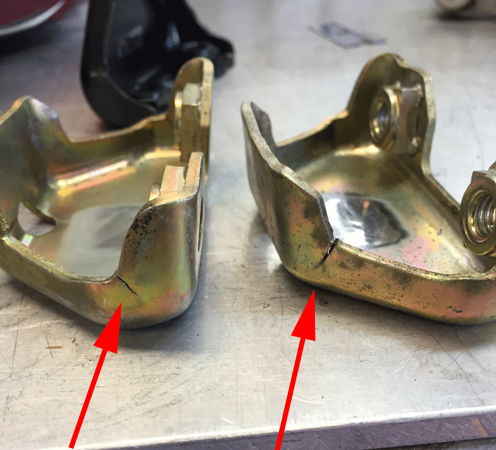

Also be sure to check the mount for cracks. When they get old and the tranny starts moving side to side, the mounts can develop crack, which allows the tranny to swing back and forth even more. I welded mine up, and then boxed them in with an additional metal side, since the factory C-shape is vulnerable to pulling apart and cracking.
