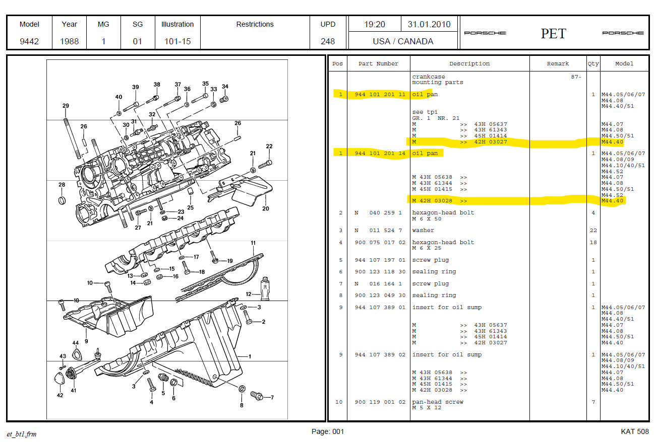

With my '87 S, I had the same thought as you, that my oil pan must have been changed as it did not have the oil level sensor bung. It gnawed on me though, as there was nothing else about the car that suggested it had been opened up to that degree.
Eventually, I realized that the new pan was actually a running change in 1987. PET shows that for S engine numbers below 42H 03027, the pan is 944 101 201 11, which is the old style pan. My engine number is 42H 01802, so the old pan makes sense after all. However, the wiring harness did have the connector for the sensor. I think what likely happened is that Porsche elected to first use up the stock of old design pans, which I guess makes sense, as they certainly must be one of the more expensive oil pans out there!

500 wrote: Wed Mar 20, 2024 1:46 pm With my '87 S, I had the same thought as you, that my oil pan must have been changed as it did not have the oil level sensor bung. It gnawed on me though, as there was nothing else about the car that suggested it had been opened up to that degree.
Holy cow that answers a lot of questions. I just assumed because I had the connector for the oil level sensor that someone swapped in another pan.

500 wrote: Wed Mar 20, 2024 1:46 pm Eventually, I realized that the new pan was actually a running change in 1987...the wiring harness did have the connector for the sensor. I think what likely happened is that Porsche elected to first use up the stock of old design pans, which I guess makes sense, as they certainly must be one of the more expensive oil pans out there!
The harness update happened late MY86. I've seen more than one MY86 with the wiring for a oil pan level sensor.
