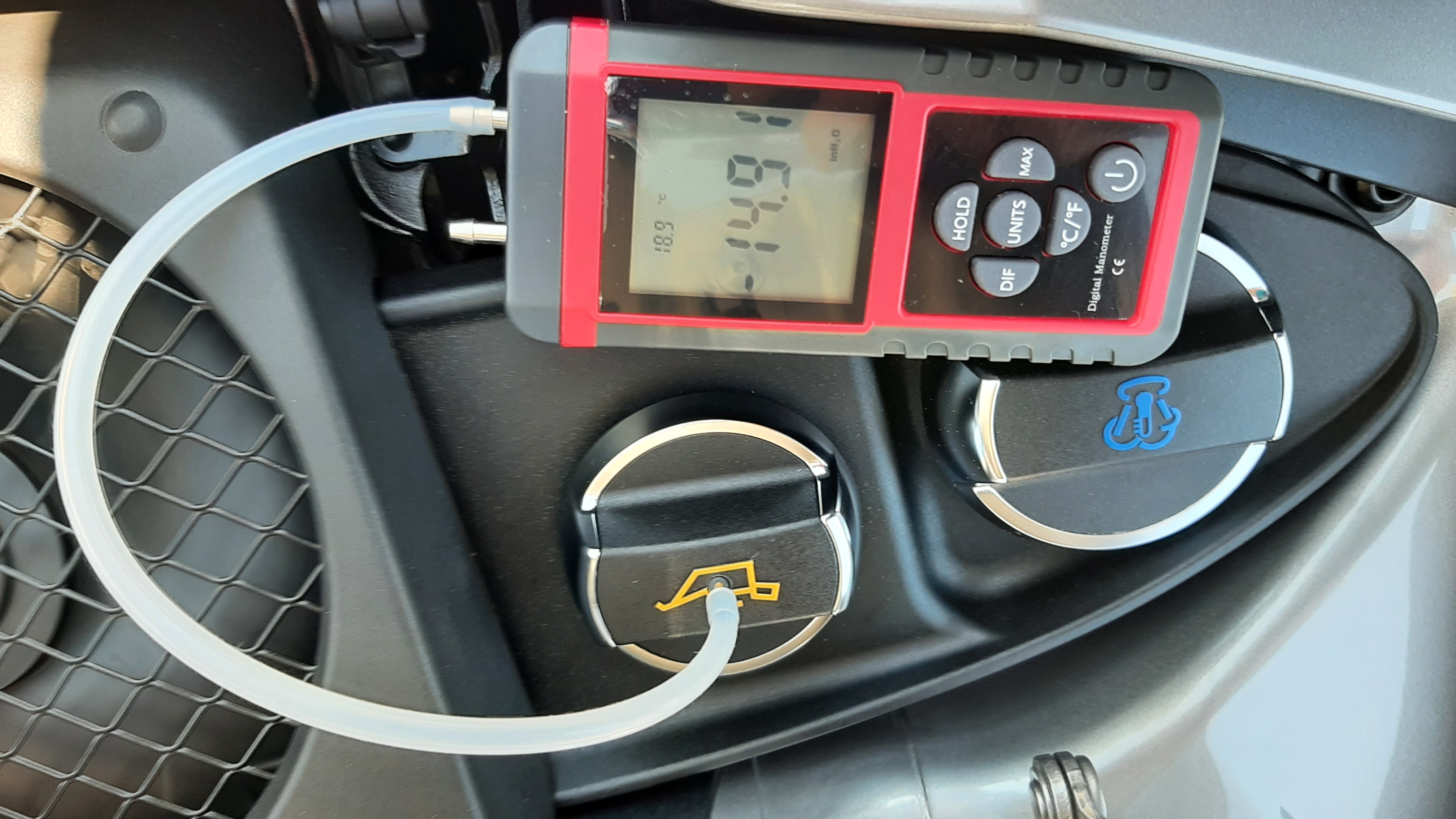

Not worried about my AOS and because my 991 has ultra low mileage, I assume it works as it did the day it left the factory.
So I would expect to see ~15 inches of water column (according to the LN "AOS UNDERSTANDING THE PCV AND AOS SYSTEMS ON PORSCHE BOXSTER, CAYMAN, AND 911 MODELS" article.
I have the manometer but needed an oil cap with an attached fitting...

Went for a drive and tested the AOS upon return.
-14.91...close enough to -15.0.
