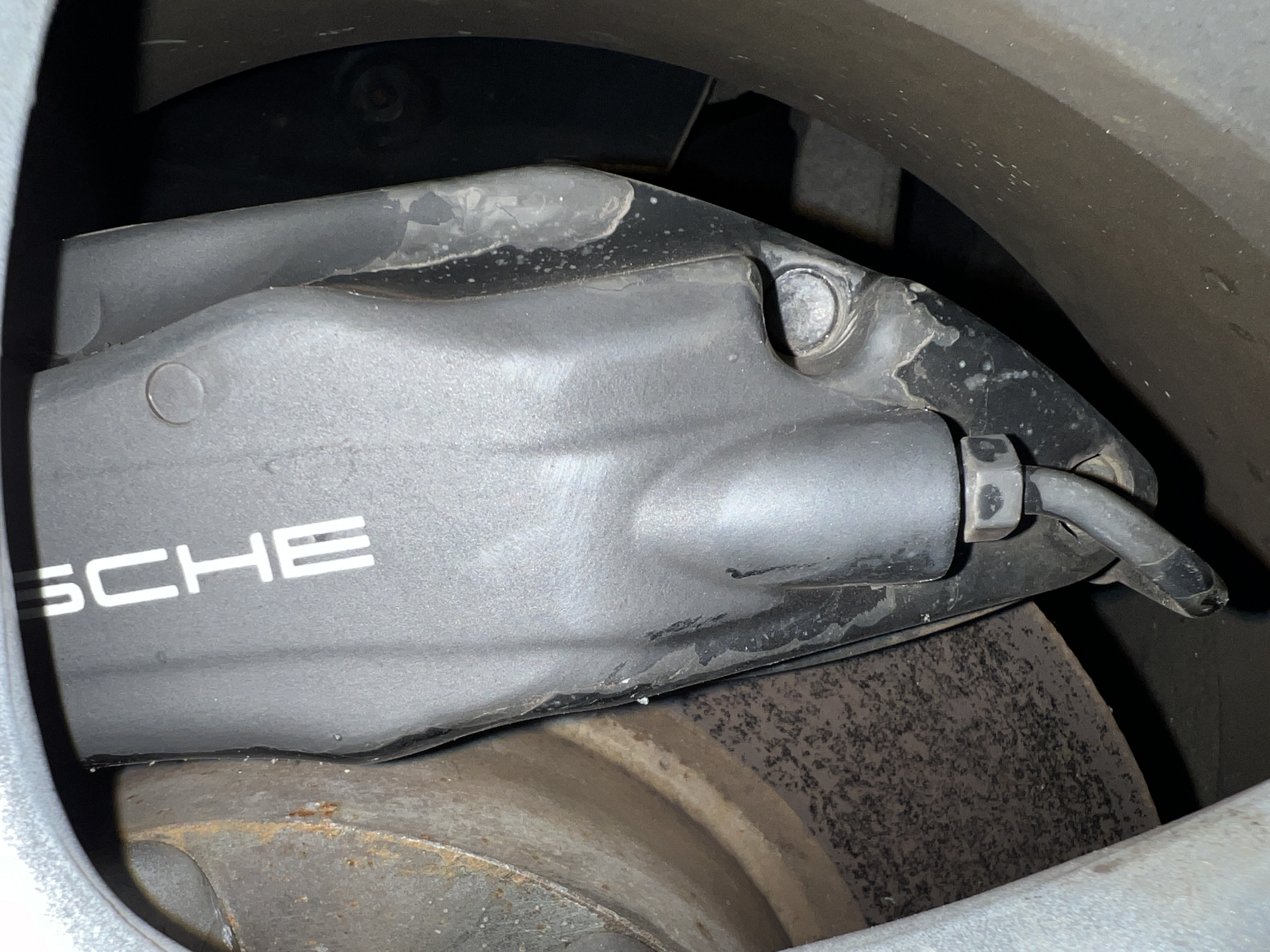

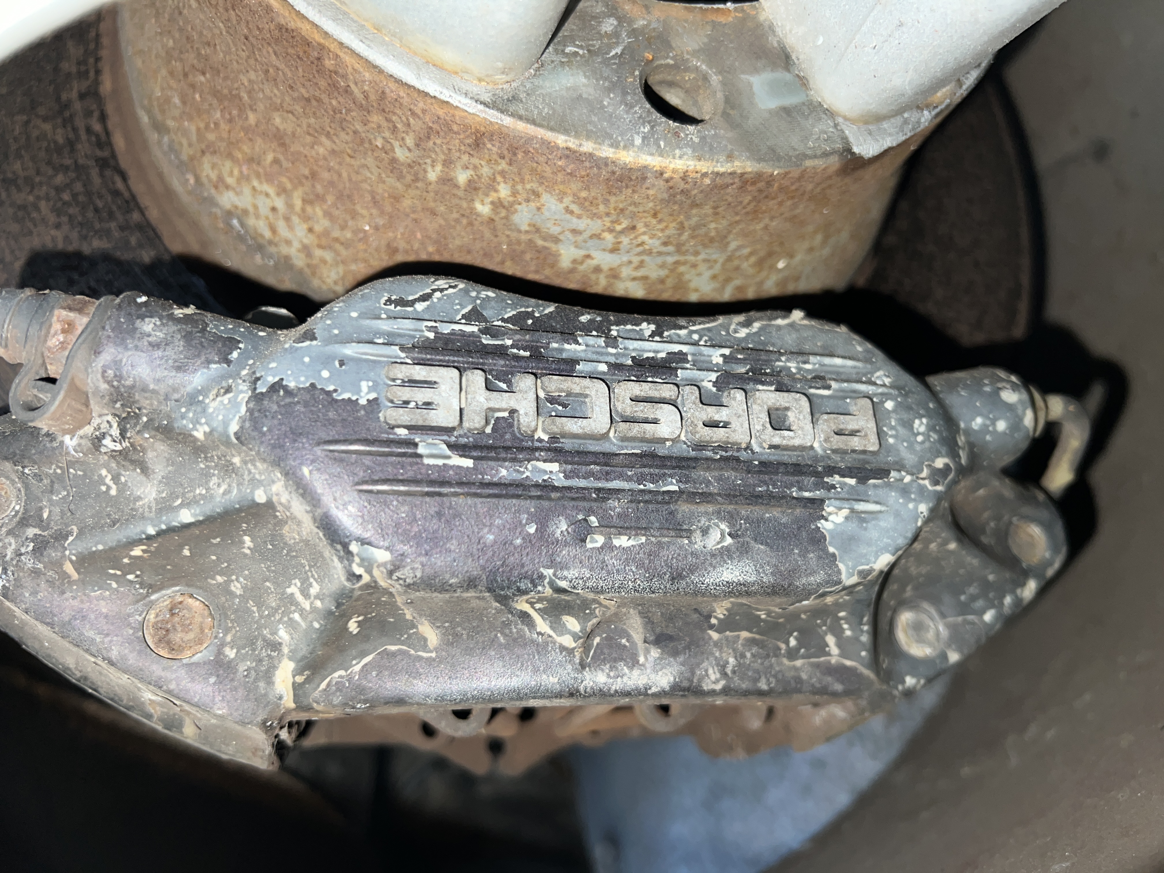

I just noticed my Front L caliper is mismatched from the other 3.
Pics attached of my R Rear caliper with Porsche letters cast in metal, and the "new" Front L caliper with the Porsche sticker.
I read the 88 Turbo S supposedly had brake calipers from the 928 S4.
Can someone tell me more about the calipers on the Turbo S?

The smoother one looks very much like my 993 calipers, from memory these came on the later 928s as well. Piston sizes are the same as the 88+ M030/Turbo S/S4 calipers.

OP's second photo shows what looks like standard 944 turbo brakes. I have them in my 86.

Belgian951 wrote: Sun Mar 10, 2024 11:20 pm OP's second photo shows what looks like standard 944 turbo brakes. I have them in my 86.
They are supposed to be upgraded from standard 944 turbo on the 1988 Turbo S and 1989+ turbos (M030).
I’m wondering what the part number is so I can get the original one to swap back to.

Don't take this too much to heart: I have a dusty memory of reading that replacement calipers came with painted letters. Probably just what Brembo had for continuing stock once the 944 line ended...
