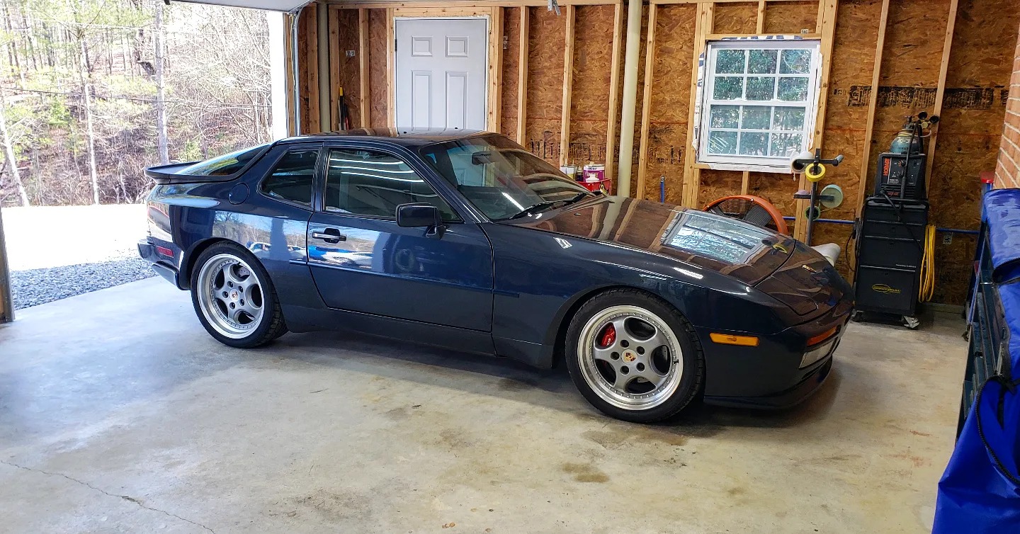

Before:
IMG_4741 copy.jpg (564.87 KiB) Viewed 3391 times

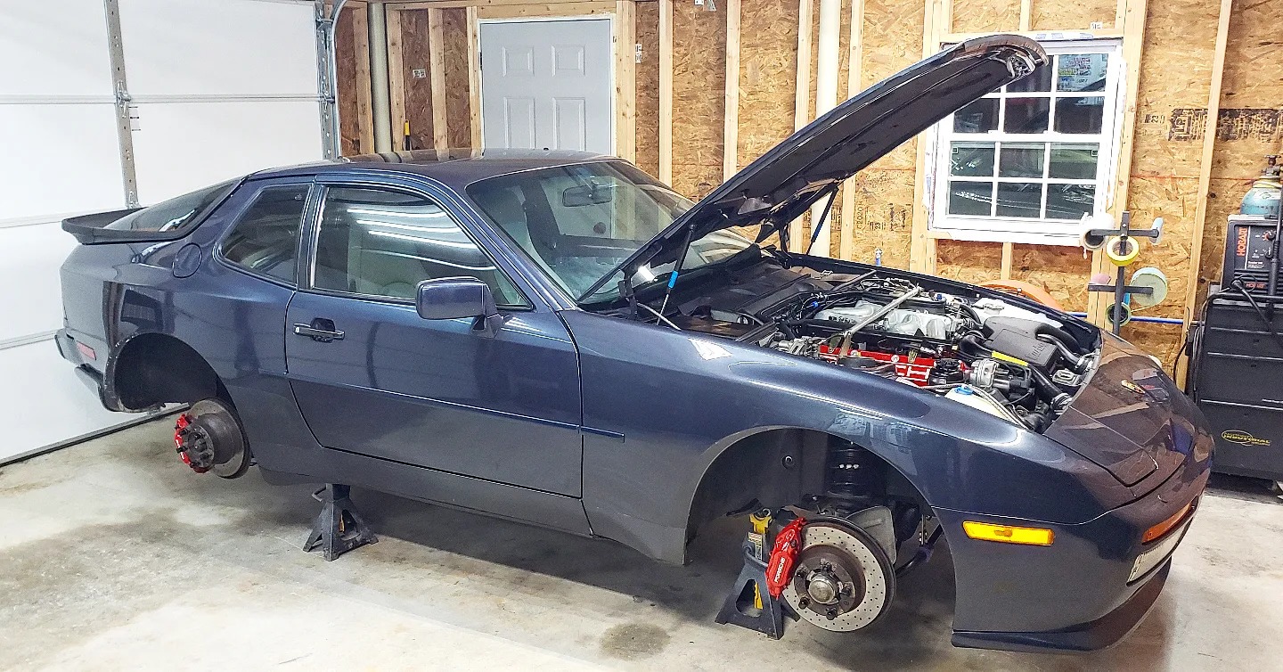

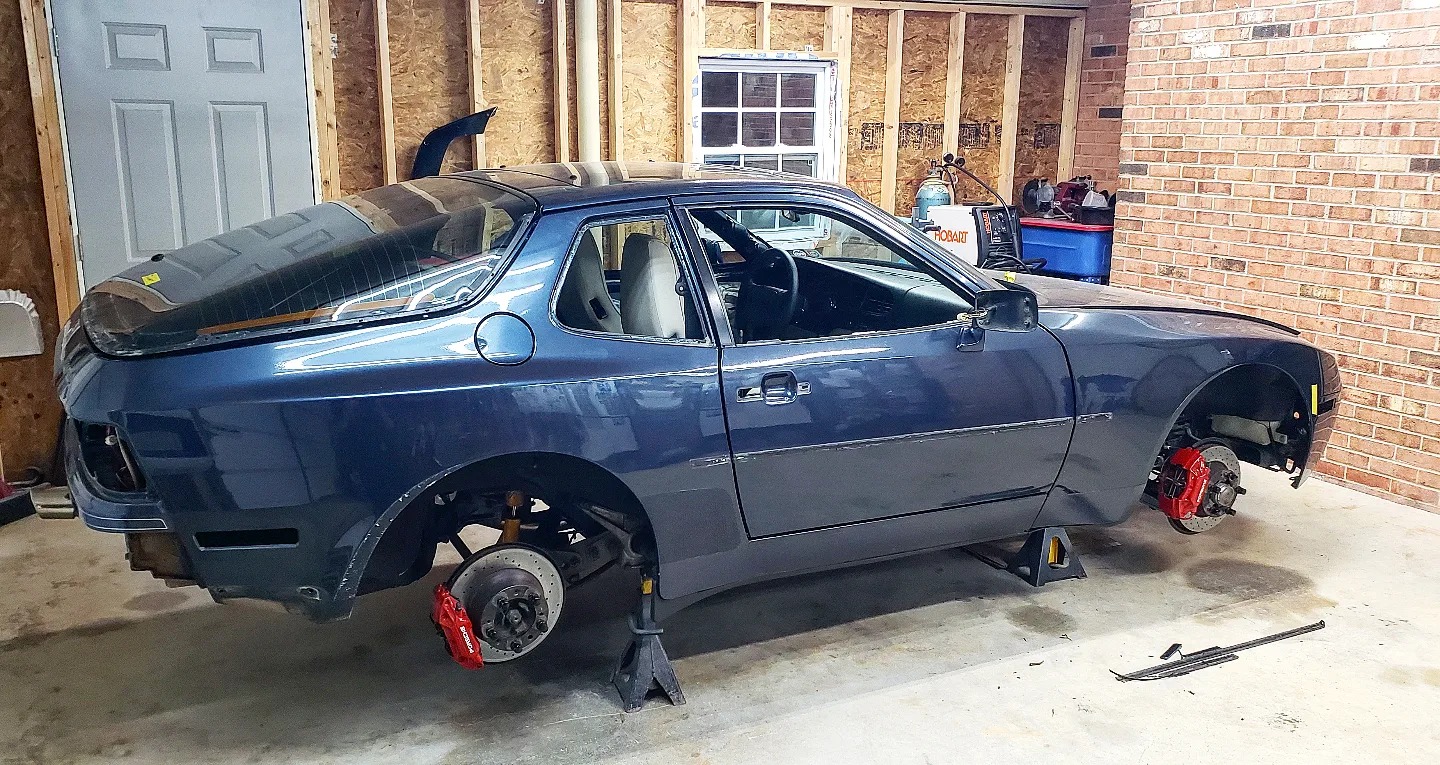

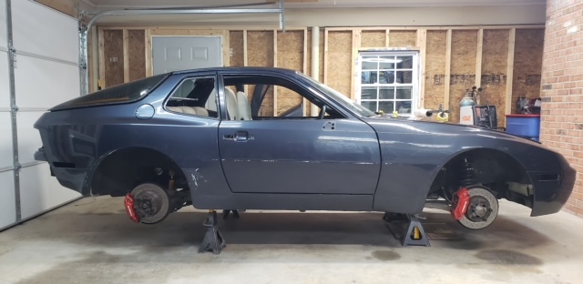

Disassembly begins...
Respray_Dissassembly Begins.jpeg (439.96 KiB) Viewed 3385 times

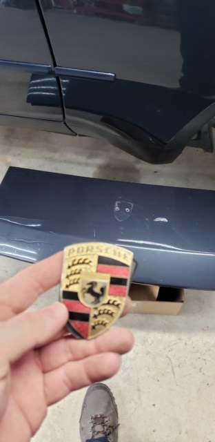

Off with the old badge - this will go to the S, which is more faded. The turbo is getting a brand new crest and gasket.
Respray_Badge Off.JPEG (51.52 KiB) Viewed 3384 times

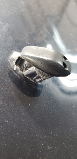

Wiper spray nozzles getting replaced with brand new ones.
Respray_Wiper Jet.JPEG (67.82 KiB) Viewed 3384 times

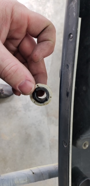

The car doesn't have headlight washers and the original plugs are degrading - new ones will be going on
Respray_Bumper Plug Bad.JPEG (51.67 KiB) Viewed 3384 times

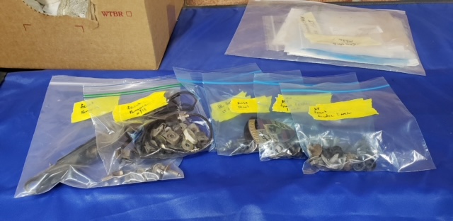

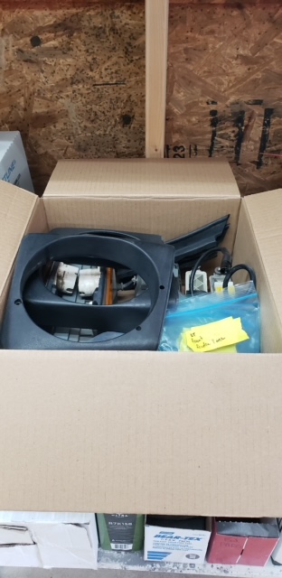

All hardware and parts are bagged, tagged and boxed for safe keeping
Respray_Boxed Up.JPEG (72.09 KiB) Viewed 3384 times

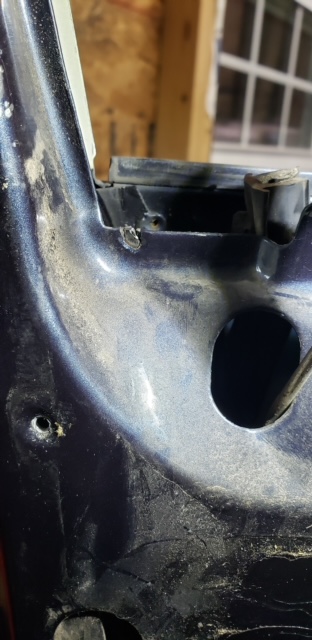

Driver's side has the typical skin crack due to broken welds on the window support. That will be re-welded so it won't crack again.
Respray_Door Skin Crack.JPEG (67.4 KiB) Viewed 3383 times
Respray_Window Channel Crack.JPEG (81.75 KiB) Viewed 3383 times

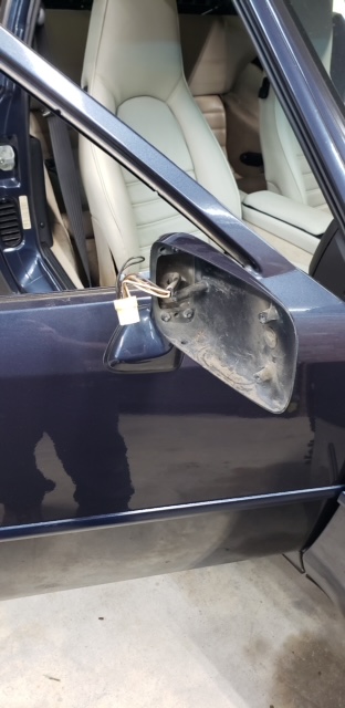

Door handles and mirrors coming off. Will have all new gaskets.
Respray_Mirror Disassembly.JPEG (69.77 KiB) Viewed 3383 times

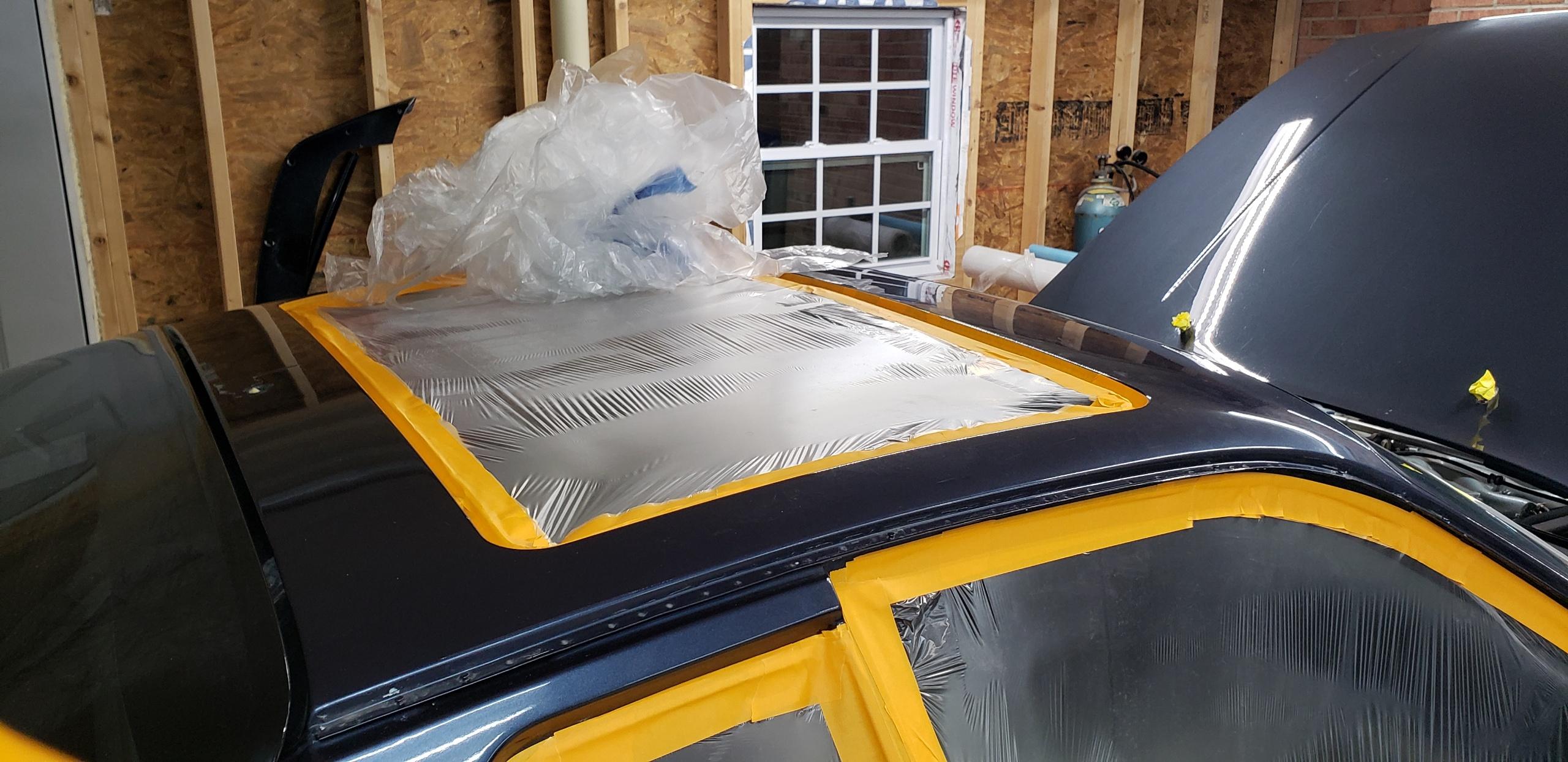

Taping up to get ready for bodywork!
Respray_Taping 2.JPG (355.04 KiB) Viewed 3383 times

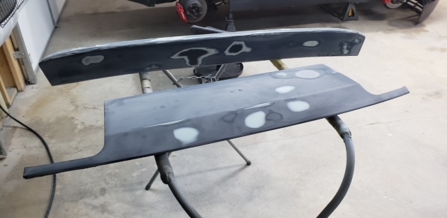

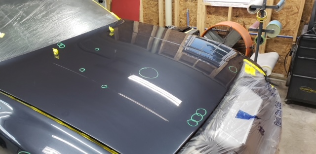

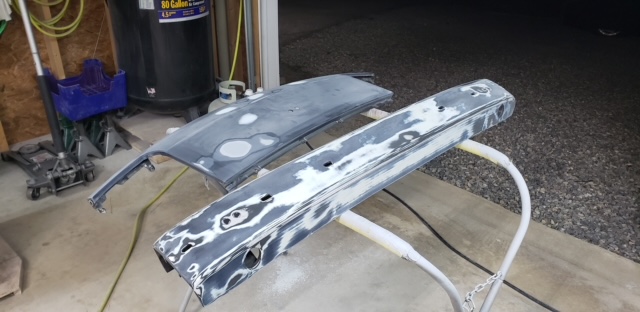

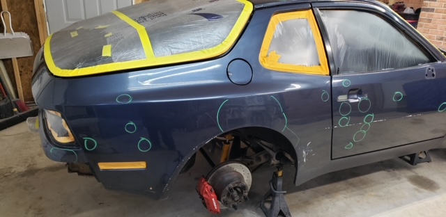

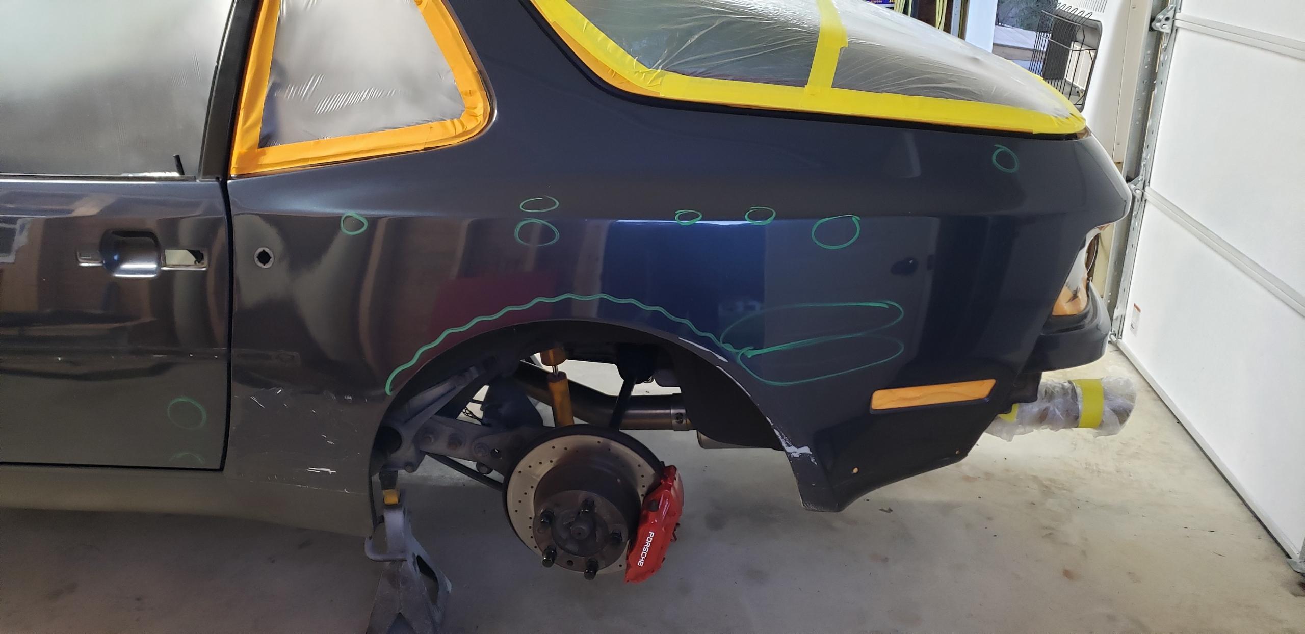

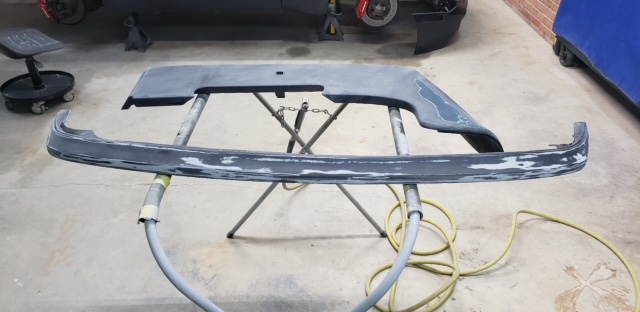

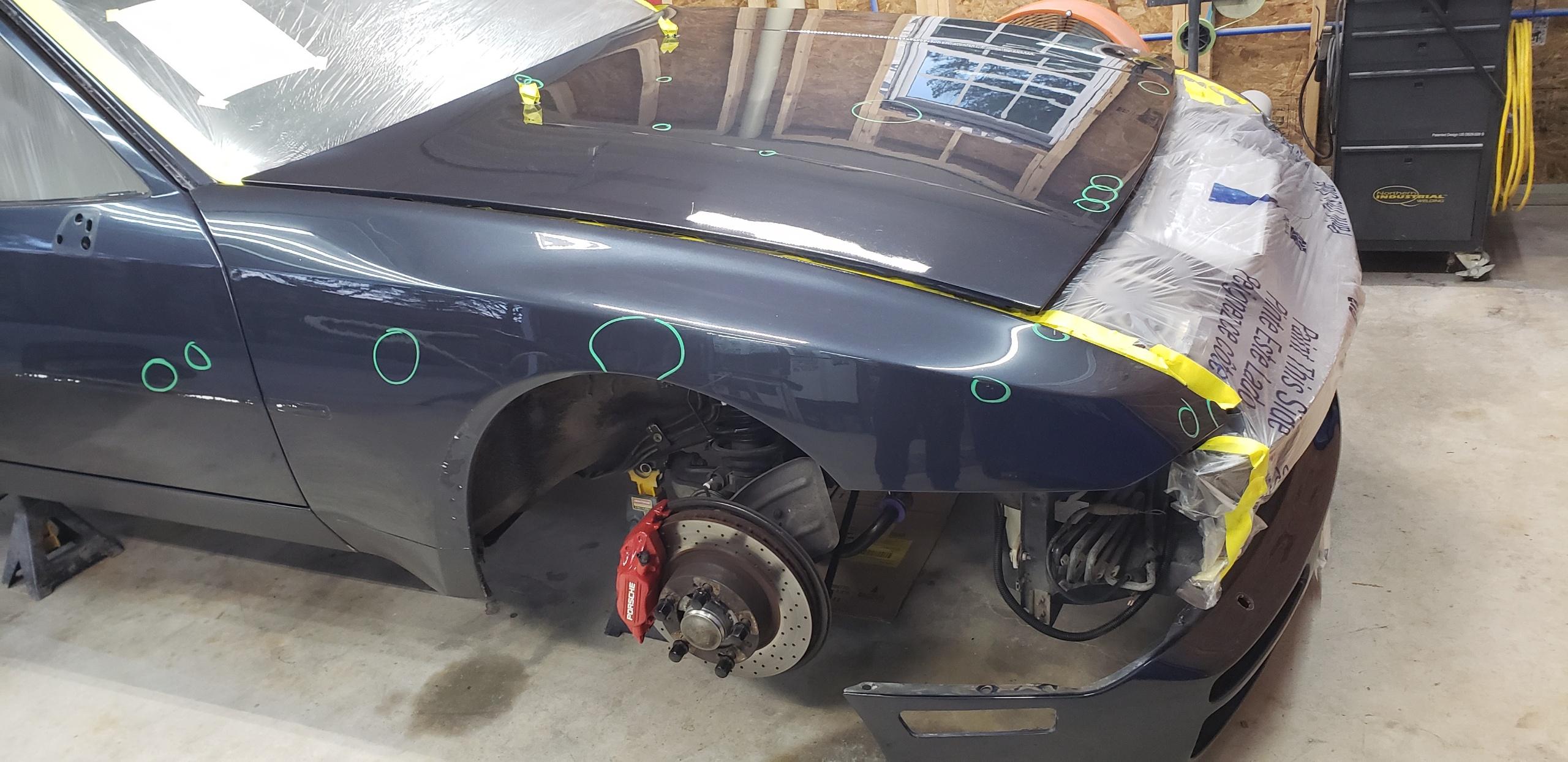

I have the latest from Javelin Motor Cars. I knew the car, despite it's 10 ft away shine, had many flaws that were not noticeable until you REALLY looked for them. These are often unnoticed when gawking at your car in a garage. However, when you take it into the sunlight or put the LED lights to it.....the horror reveals itself...
The small dents in the front of the hood look to be from 30+ years of using knuckles to latch the hood
This is why parking lots are the devil.
The large area under the fuel filler cap is from years of gas not being cleaned up after refueling. Don't forget to give your nozzle the 2 shake jingle when you're done!
I rolled the fenders (Eastwood roller) to accommodate the 275/35/18's on the rear. There was no rubbing on the passenger side, but the drivers side would rub under hard acceleration. The rolling did leave some waviness in the fender lip, which Ron is going to correct.
Parts are now being prepped for primer!
PrimerPrep 2.JPEG (79.53 KiB) Viewed 3139 times
