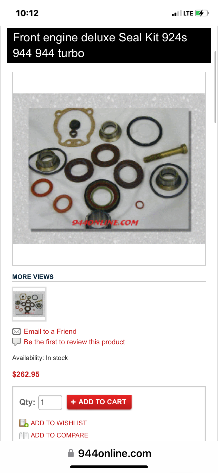

In additional to timing and balance shaft belts, and all associated rollers and seals, I'd be sure to get a LASO (or PCNA) water pump, as some of the cheaper versions have had short lives in the past. The rear balance shaft seals (o-rings) are common leakers, so worth considering. You'll also need loctite 574 if you remove the b/s cover to replace those seals. Be sure to replace the main thermostat too, and consider a lower temp thermostat/fan switch combo. Also be sure to get the tiny second thermostat, its plastic housing, and o-ring for the turbo coolant circuit. If there are any signs of oil seepage, etc., consider changing the cam seals and front oil crank seal. See diagrams and part numbers in the pics below. Good time to change the cap/rotor/wires/plugs too.

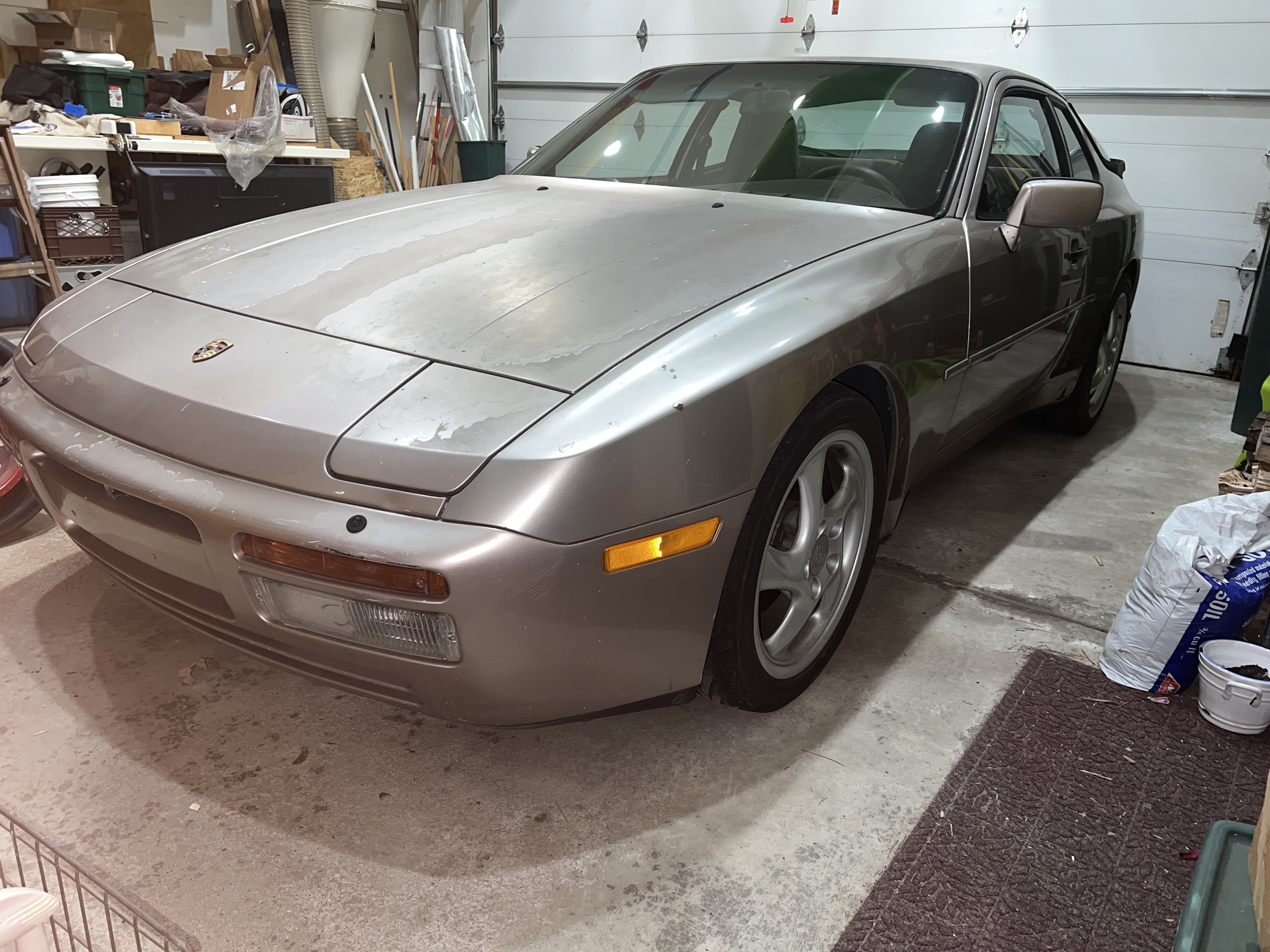

- Yes, a Silver Rose. It was repainted (supposedly in the same color), but the 2nd job was poor and has faded along with peeling clearcoat from sitting outside.) I was replacing the rear hatch seal yesterday and found a spot with the beautiful original color underneath.
Though not completely original, it came with documentation going back to new. Thus, I am bringing it back to its original spec, including the awesome plaid interior.
