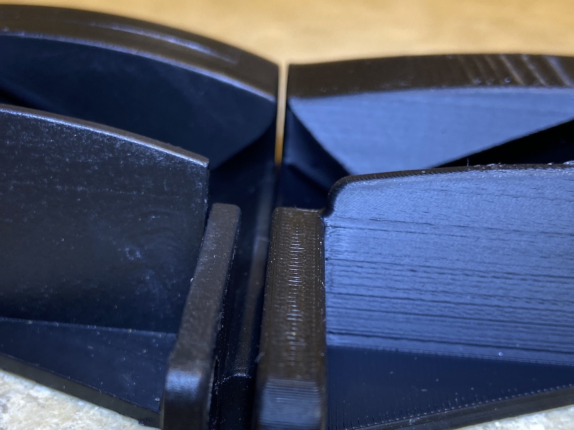

Found a solution to my problem. Returned the Porsche branded parts that were molded slightly differently than my original 1986 covers and went with the 3D printed lift arm covers at https://www.etsy.com/listing/1593451005 ... ht-sunroof. Perfect fit and operated properly without any additional fitting/adjusting on my part. Simply installed them and they worked! The photo shows the 3D printed part on the right versus the original Porsche OEM replacement part on the left.

I just replaced mine with cheapo 3D printed parts and, after a little screw hole elongation and some minor filing/trimming for a perfect fit, they work great! Only time will tell how long they last but so far so good.
