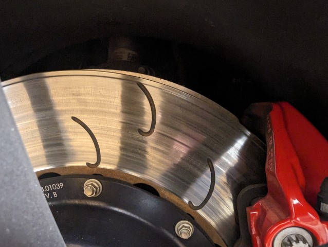

I prefer AP Racing Competition J-Hook slotted. They are not cheap but the performance when paired with Ferodo DS3.12 pads is unbelievable.

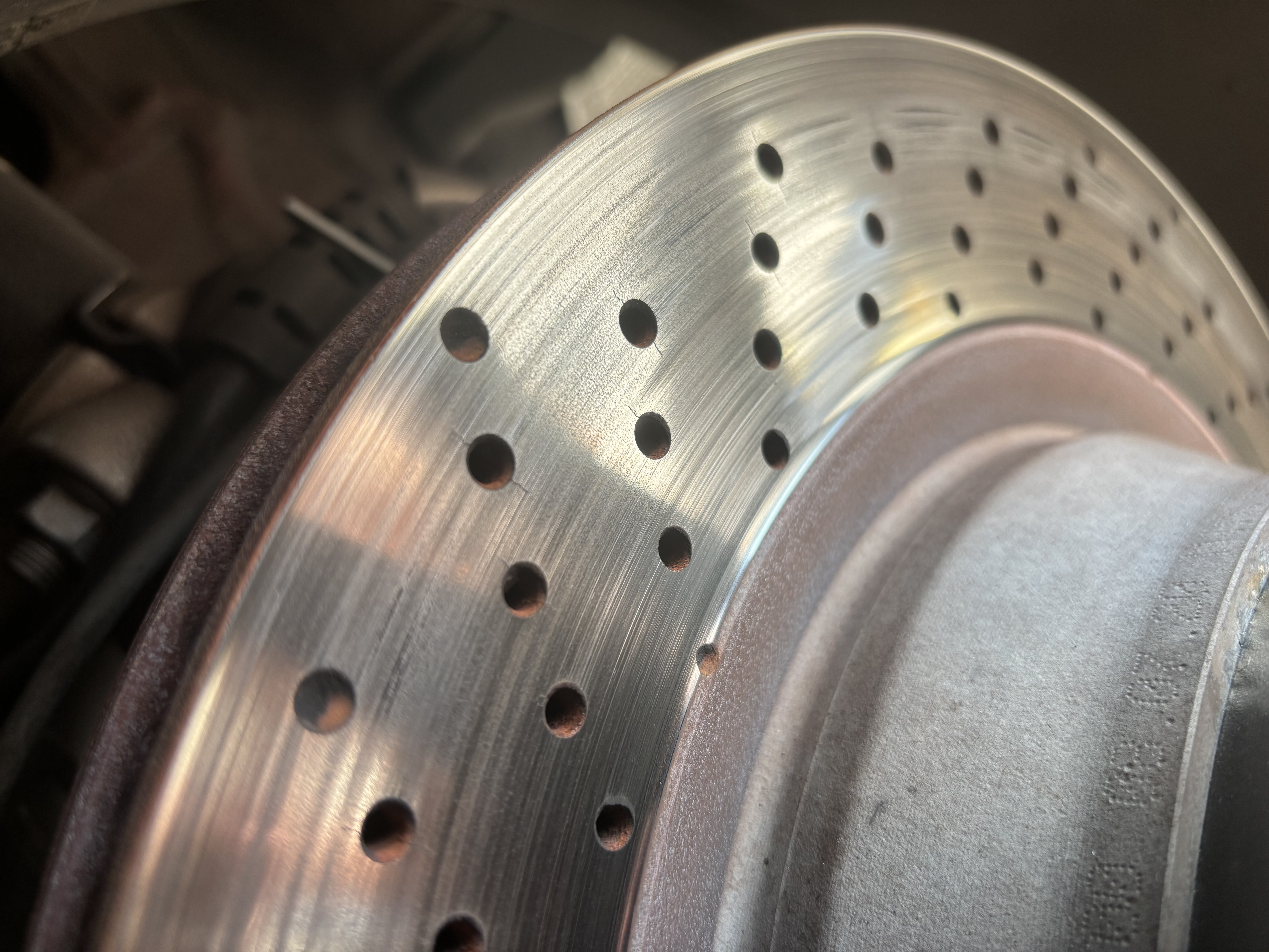

I had a hard time getting these to show well in the picture but here is one of my rear rotors right now. Note that I am not in a hurry to change these yet but am keeping on eye on them.

Thanks for the pic. I can see quite clearly, the cracks emanating from the holes.

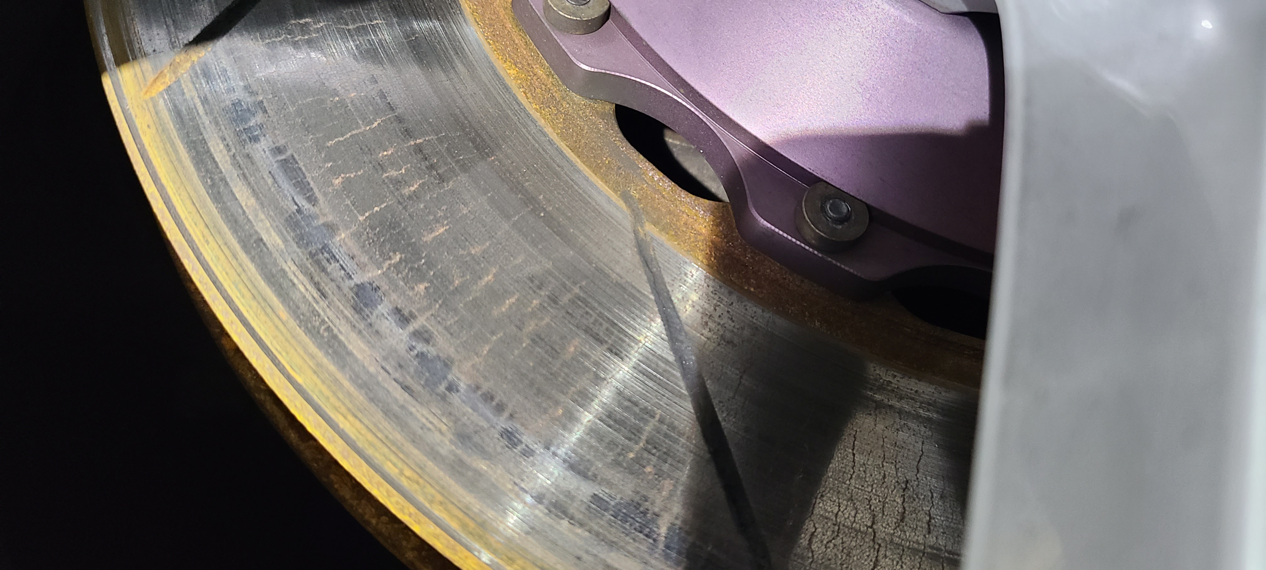

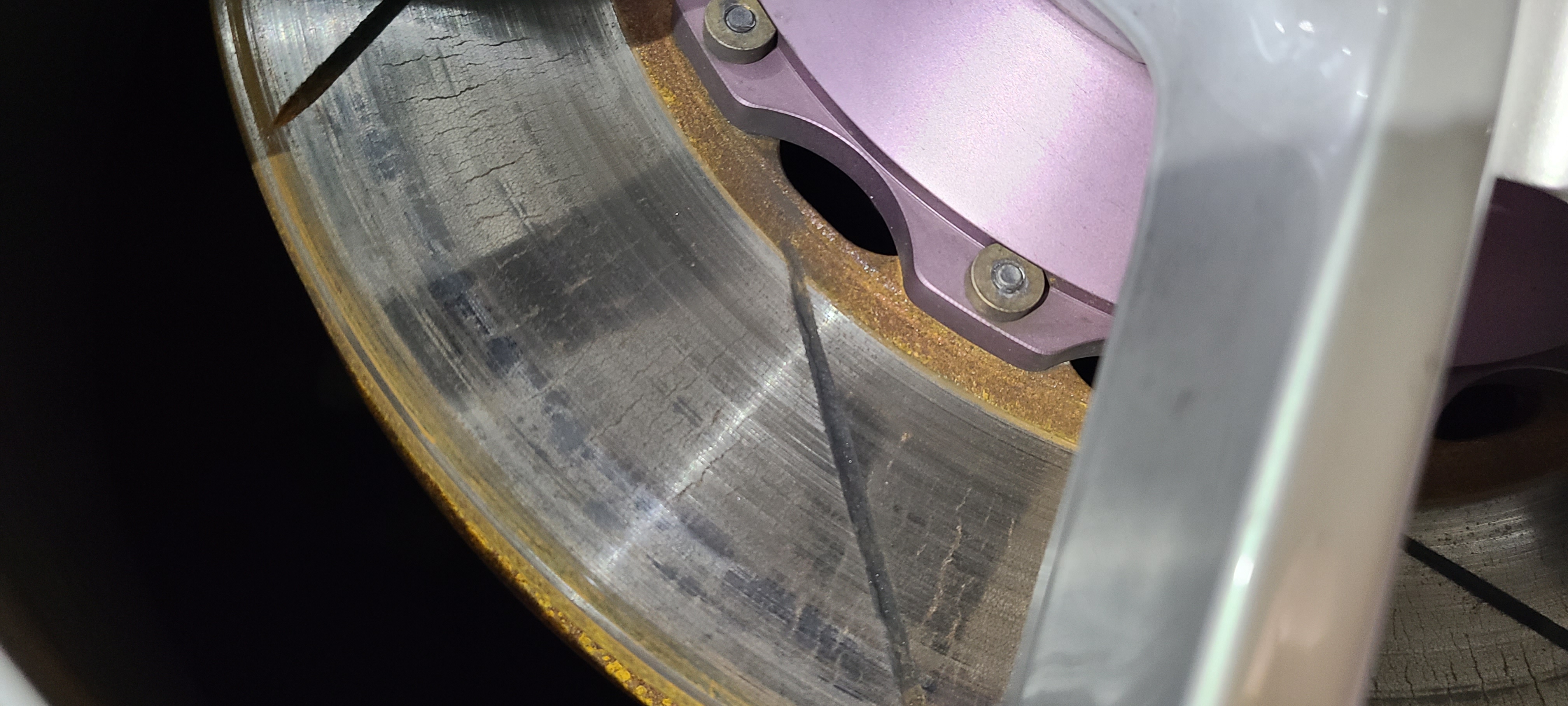

Here a couple of shots of my front rotors. They are GiroDiscs. I ordered another set of replacements rim discs and I will just remove the caps from the old discs and put the new (outer) rim discs on. Cost was $1000/pair.

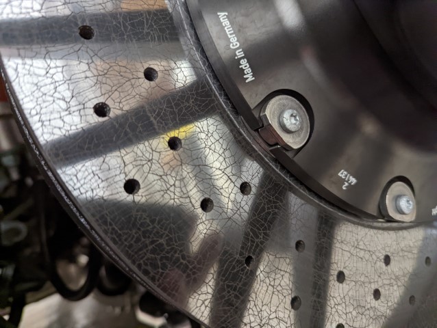

First pic is of one of my 2021 GT4's factory rotors (front) taken in May 2022 after approx 6,200 miles were on the odometer, of which 1,035 were on track using Ferodo DS3.12 pads for all of those track miles. (The Ferodo pads were installed prior to the car's initial track use at approx 2,200 miles on the odometer.)
The front rotors were obviously shot after the 1,035 track miles. In addition, I measured the thickness of the front and rear OEM rotors when new vs the thickness when the photo below was taken. The fronts were already worn to the minimum safe street thickness per Porsche. The rear rotors were mostly ok. However, both the front and rear OEM rotors wore a lot more and a lot faster than I had expected. (For reference, I have roughly 14,400 total miles on the car since I purchased it new. Approx 3,200 of those are track miles. )

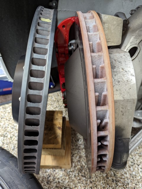

This 2nd pic compares engineering design of the OEM to AP Racing's 2-piece Competition J-Hook rotors. There really is no comparison to OEM - the vane design along with everything else on the AP rotor is vastly superior to OEM and it's apparent when on track. There's a massive increase in airflow, cooling capacity, and durability. The metallurgy has been specifically designed to handle the temps typically seen on track.

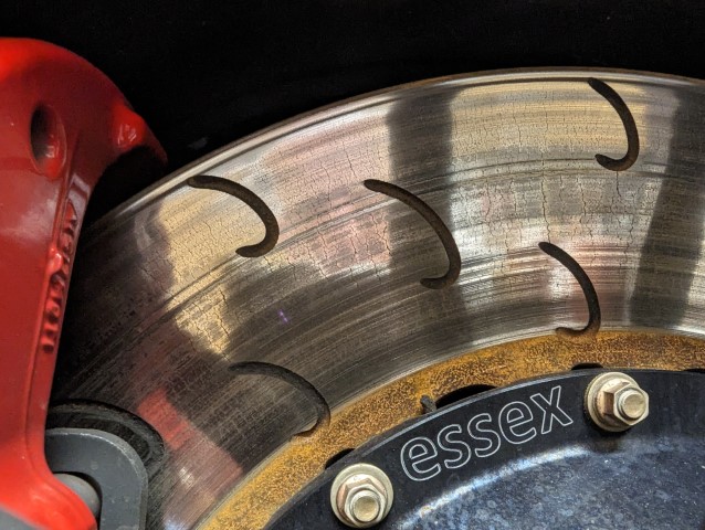

The 3rd and 4th pics are of the AP Racing rotors front and rear after 2,153 track miles on the AP rotors. (8,050 miles counting street driving on the AP's). All miles using Ferodo DS3.12 pads.
The fronts are showing small crazing but they still have life. As expected, the rears are in better condition.
What's most interesting are the rotors' thicknesses now. AP Racing rotors new are 34mm front and 30mm rear and the wear since has been minimal with the fronts currently at 33.4 mm - 33.6 mm and the rears at 29.6 mm to 29.7 mm. They have a long service life for hard track driving.
