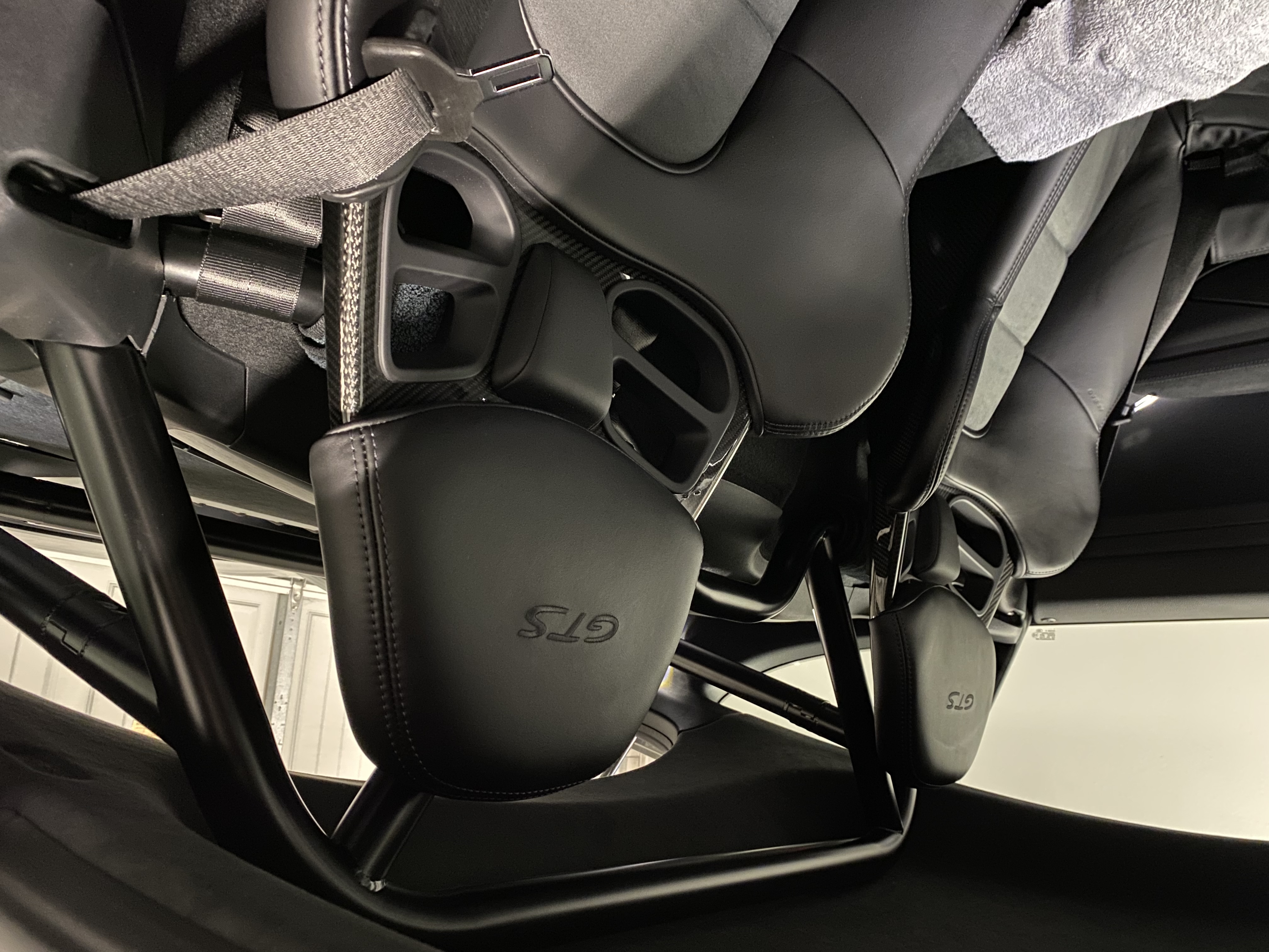

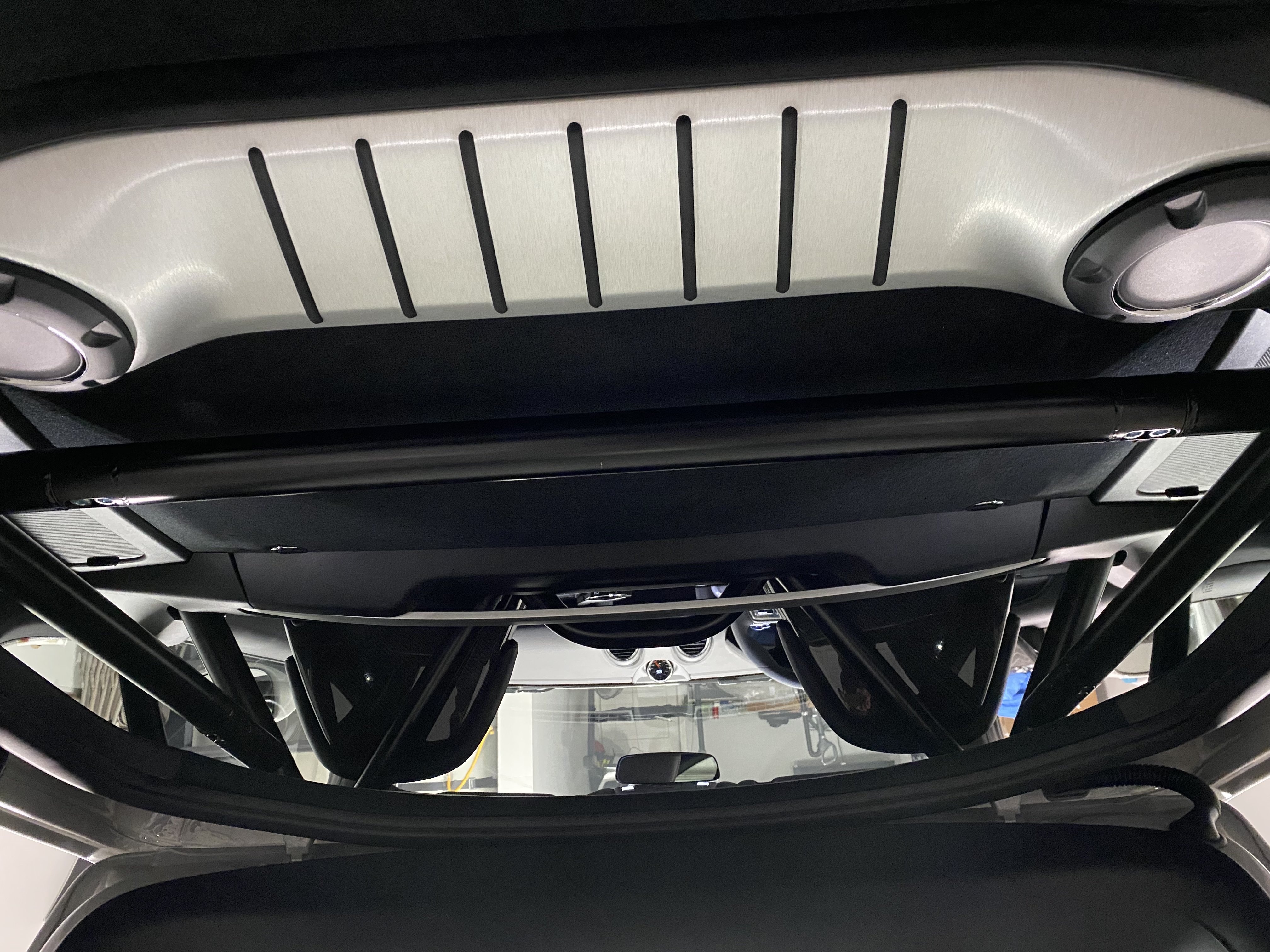

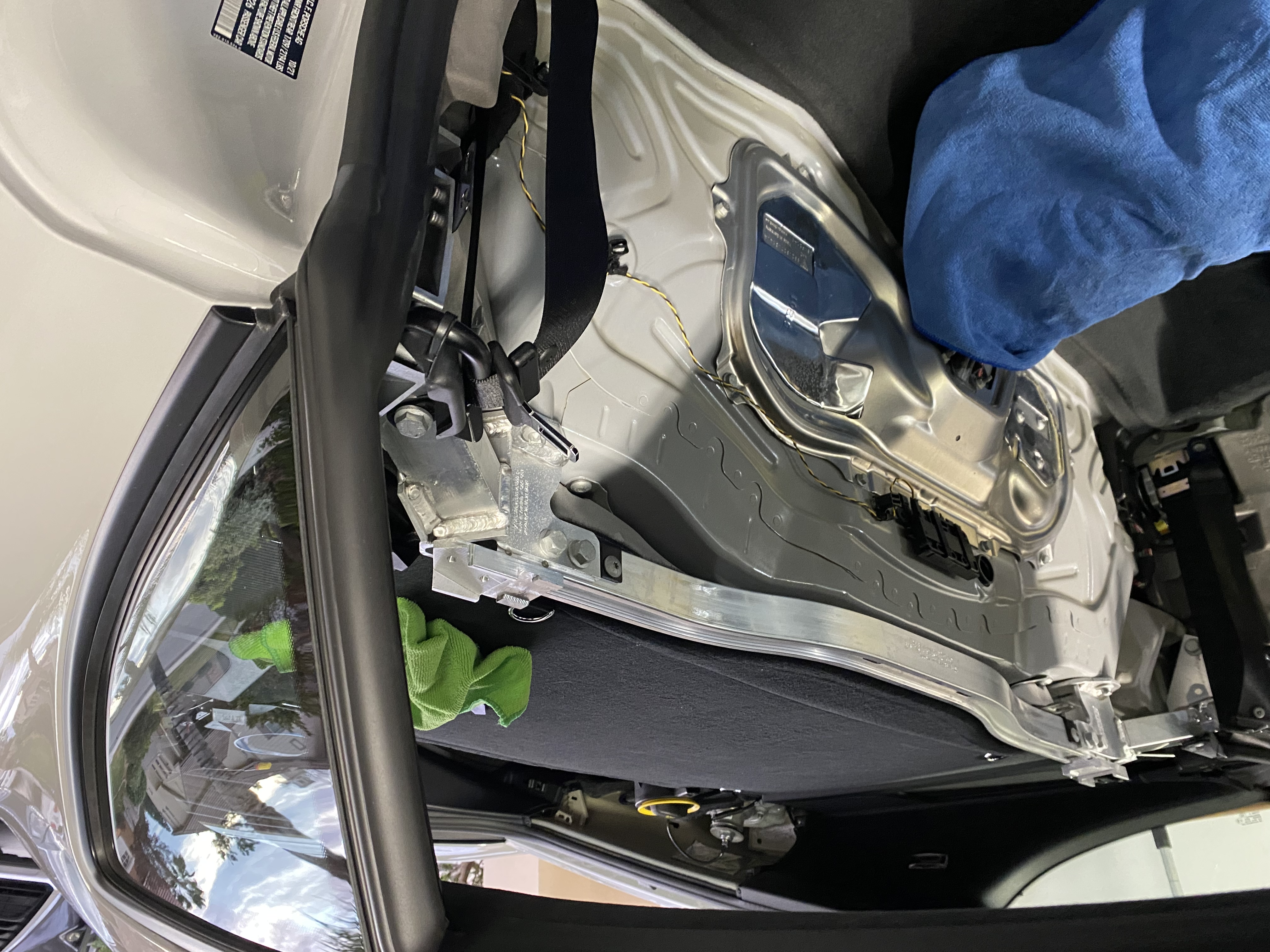

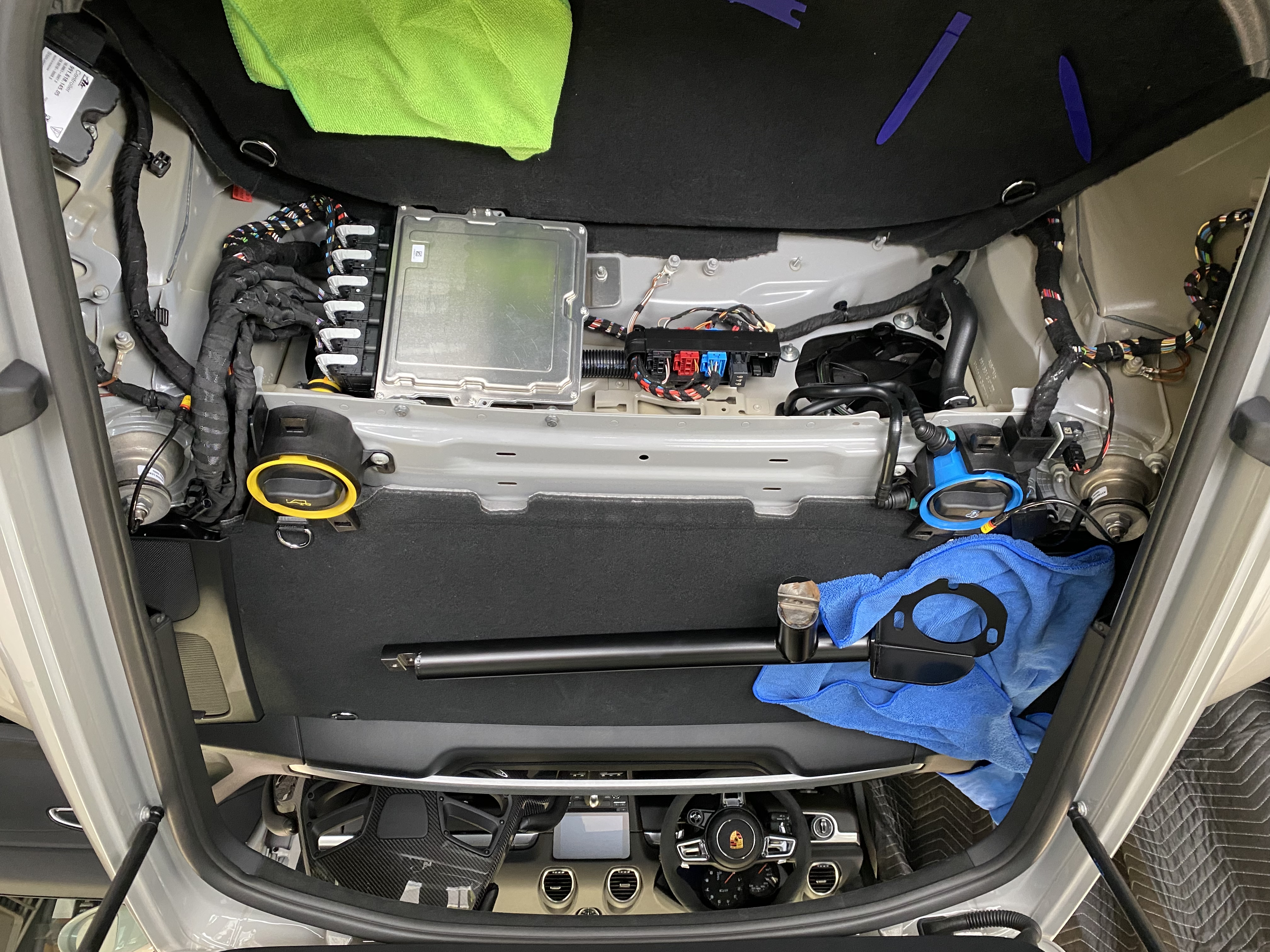

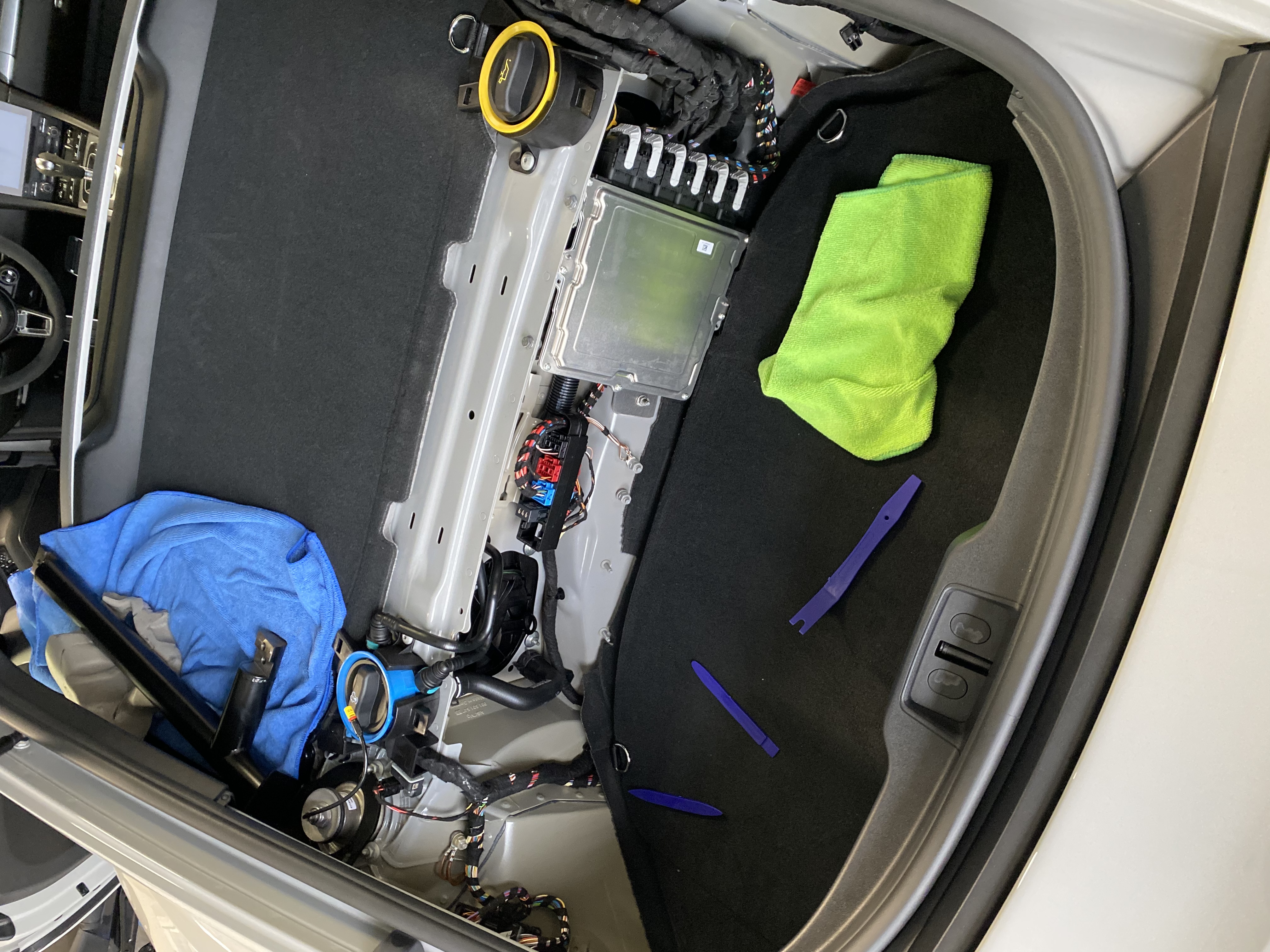

I finally installed harness bar and 6 point. I would say it took me about 10 hours total. Took my time. Spent a lot of time removing panels carefully.
This is a competition Motorsports roll bar. The harness are the Porsche specific schroth 6 point. I also purchased the anti sub bar from CMS.
Overall quality parts. Critique include the seat does not recline all the way back anymore. Maybe lose a click or two . Also the anti sub bar was easy to install but it makes the seat make a loud click sound at a certain point mid way up, when you move the seat up or down with the power button. I was worried and uninstalled and installed again. When I removed the anti sub bar, noise went away, installed again to be able to run the belts, noise came back. Either way I won’t be moving the seat often since I’m the one that drives it 99% of the time.
