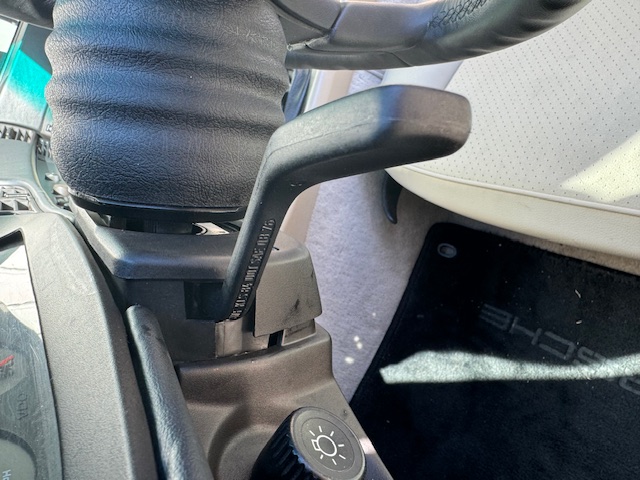

Here you go. This is the closest I could go without getting the scraping sound and still allowing the horn to work.

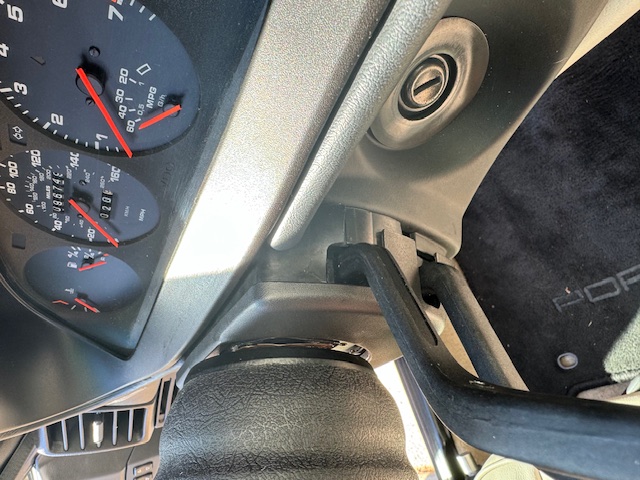

Looks pretty much like mine. I think it's pretty normal, no? When mine started making a scraping noise, I 'polished' both pieces with fine sandpaper, then new electrical grease, and that quieted things down. Here's mine:
Re: New turn signal/wiper/cruise control assembly Issue
Posted: Mon Jan 22, 2024 11:37 am
by NCGermerican
Tom wrote: Mon Jan 22, 2024 11:27 am Looks pretty much like mine. I think it's pretty normal, no? When mine started making a scraping noise, I 'polished' both pieces with fine sandpaper, then new electrical grease, and that quieted things down.
That makes me feel much better and exactly why I posted the question on Carpokes! I didn't sand the contacting surfaces, but I did use some dialetric grease to see if that would help.

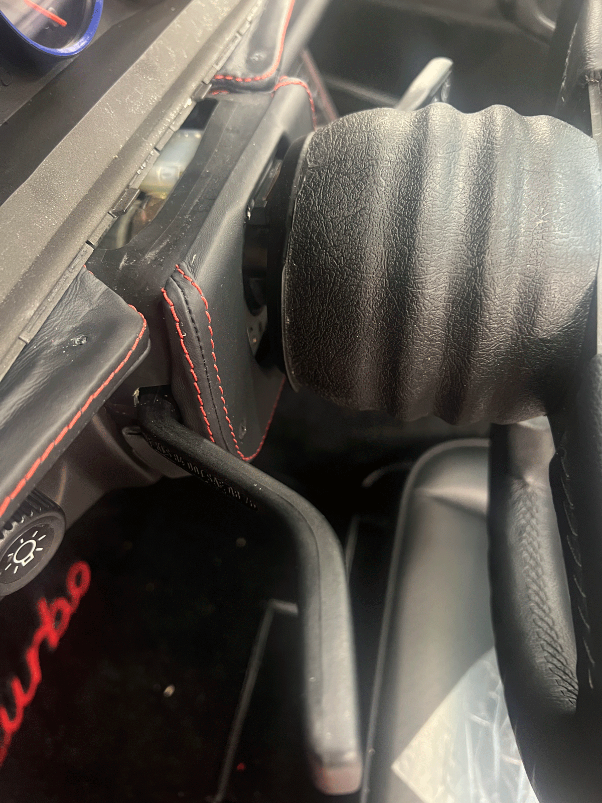

FWIW, I have the 968 CS wheel on both my '89 944 Turbo and '90 944 S2. Both of these cars originally had airbags. The CS wheel fits perfectly with the stock airbag clockspring cover. Maybe this cover and rubber bellows could be retrofitted to the non-airbag cars? But that might require a different signal/wiper/cruise switch since the newer ones have tapped holes for the four screws in the plastic cover, and I think the earlier version has the two top corners clipped.
Here's the best picture I have handy of mine installed.

Latitude48 wrote: Mon Feb 05, 2024 6:27 pm FWIW, I have the 968 CS wheel on both my '89 944 Turbo and '90 944 S2. Both of these cars originally had airbags. The CS wheel fits perfectly with the stock airbag clockspring cover. Maybe this cover and rubber bellows could be retrofitted to the non-airbag cars? But that might require a different signal/wiper/cruise switch since the newer ones have tapped holes for the four screws in the plastic cover, and I think the earlier version has the two top corners clipped.
I bet you just solved the mystery. I didn't even think about how the clockspring covers different than the non-airbag cars. I know that the screw holes are in different locations when comparing my 87 S (non airbag) and 87 turbo (airbag).
