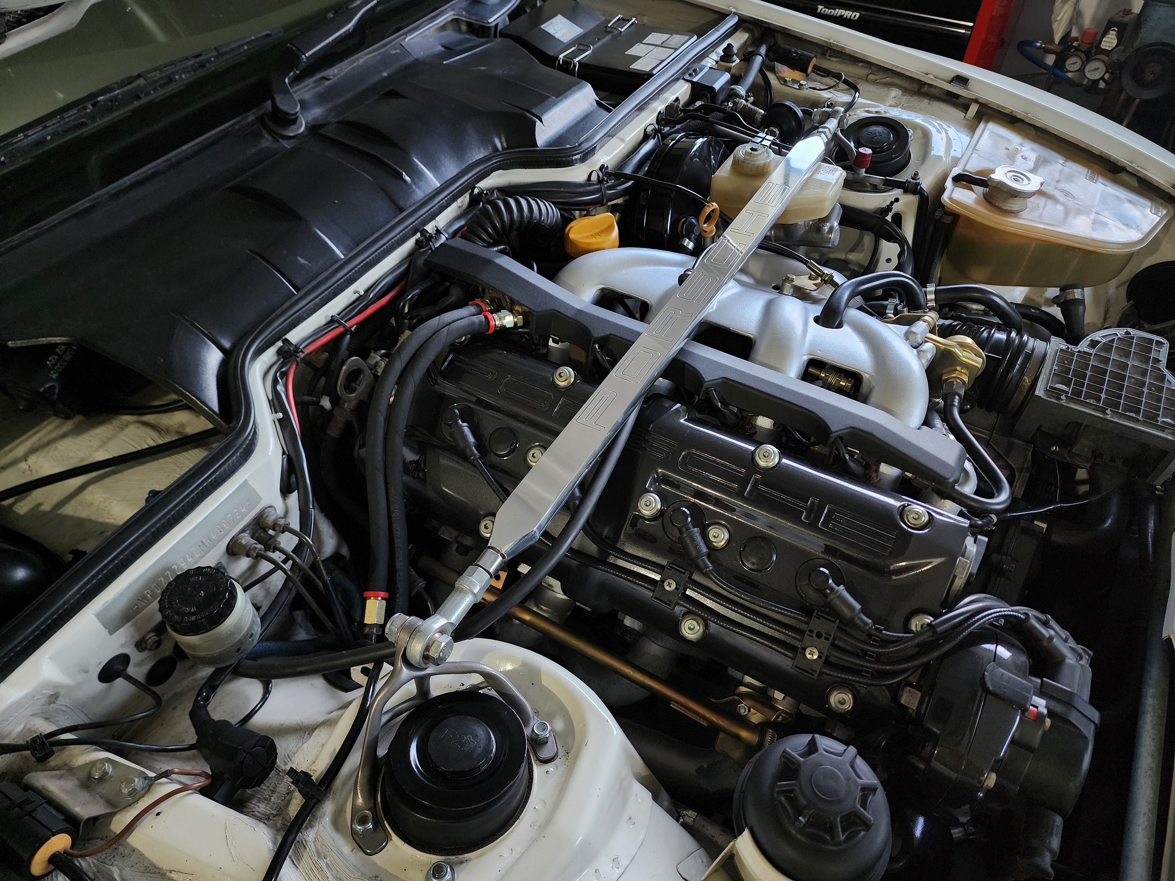

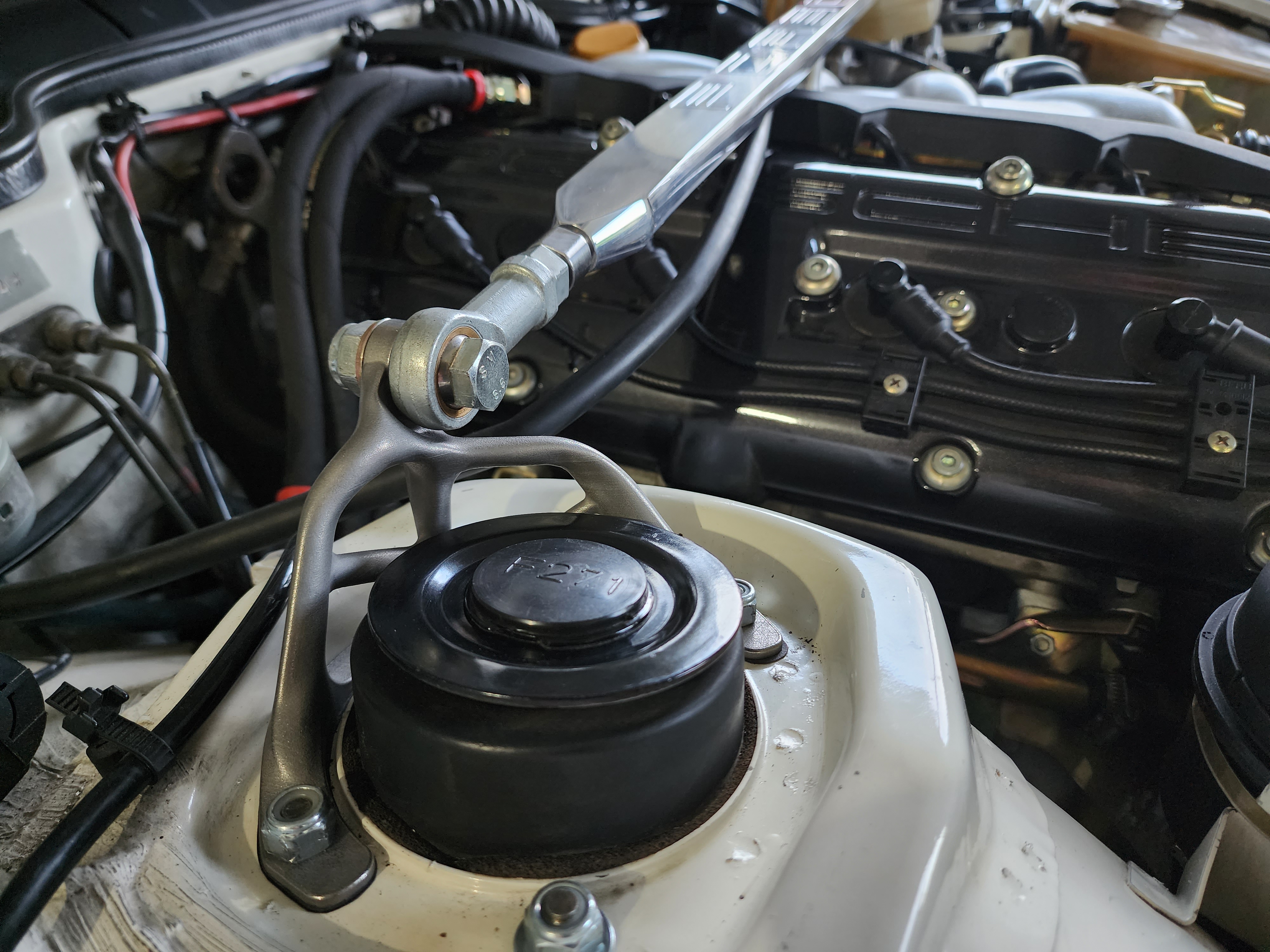

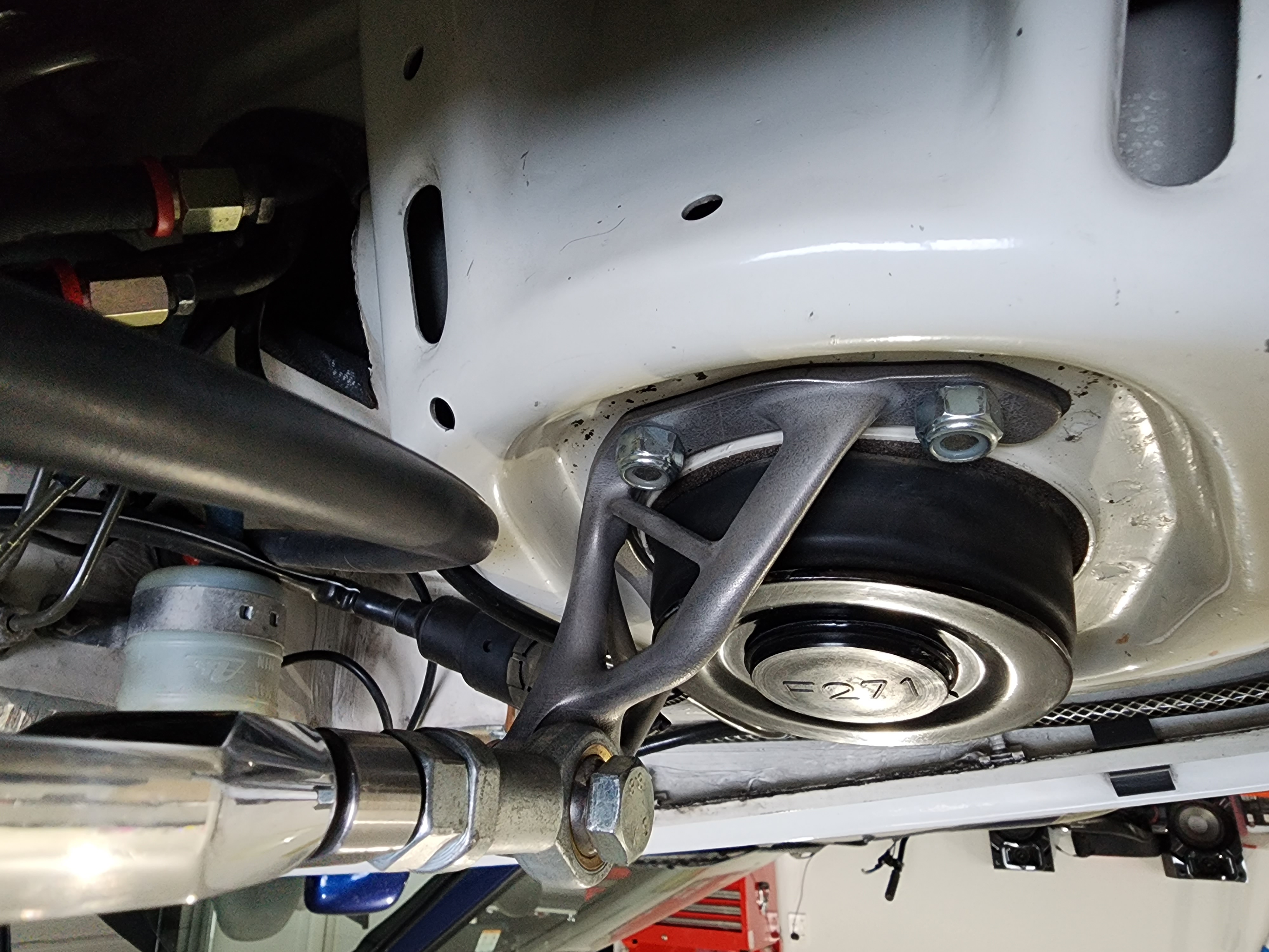

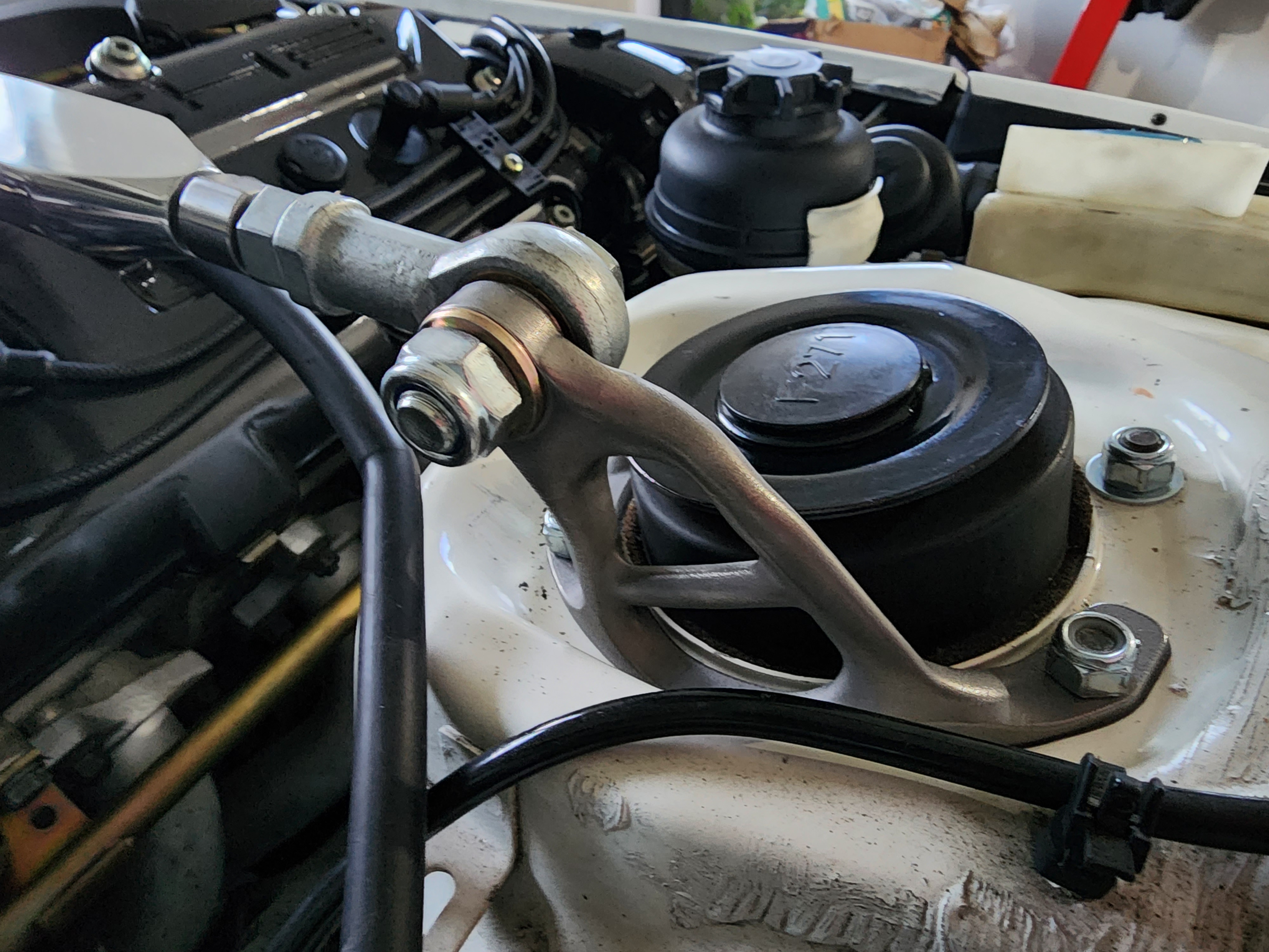

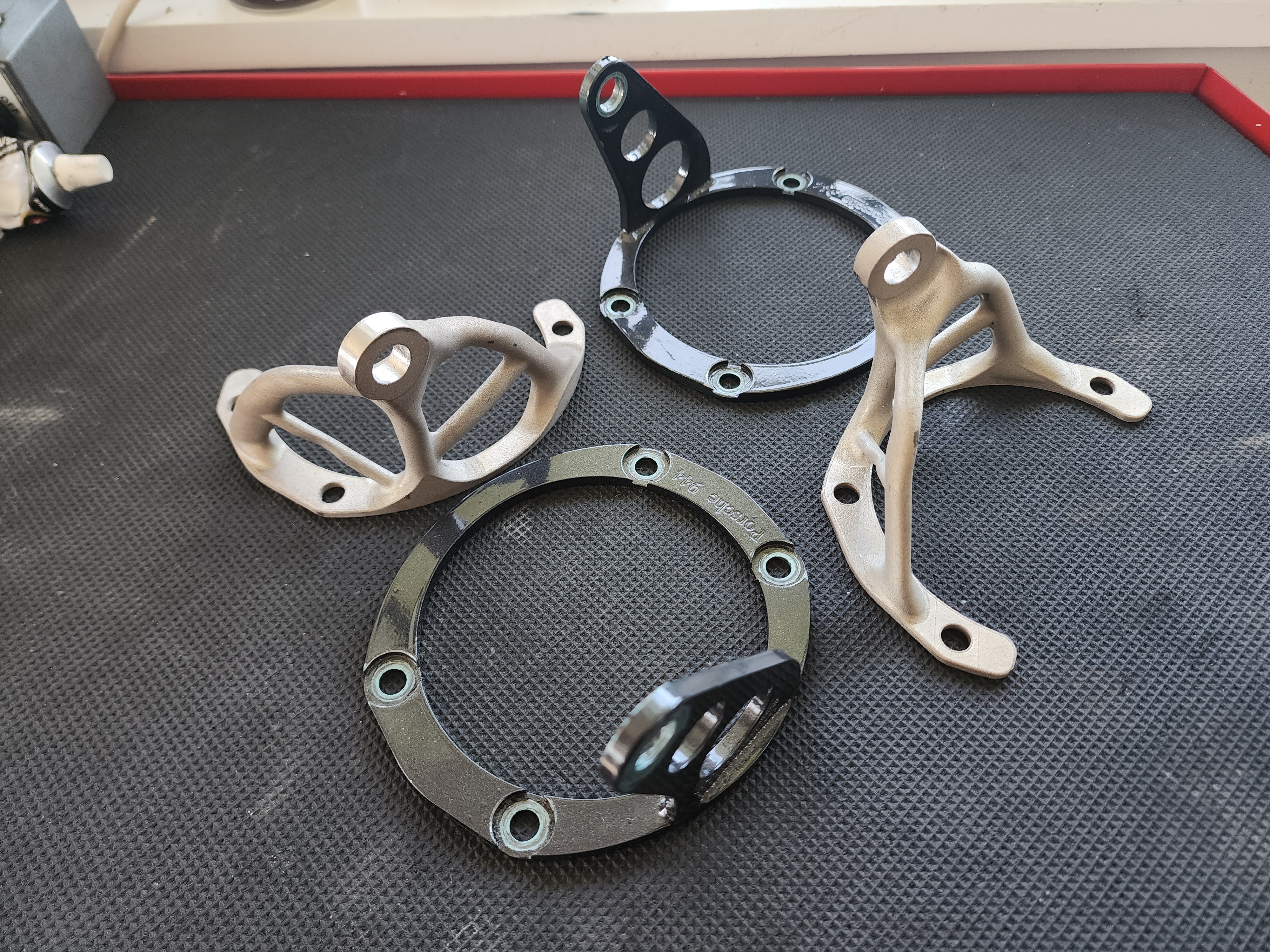

I have noticed a bunch of interest regarding the process of 3d printed manufacturing . So I thought it might be a good idea to share something I have finished working on for my car .
These are titanium 3D printed strut bar mounts to replace fabricated ones I had designed for a friend and myself that later got demand and was manufactured and sold to a few other community members.
(Excuse the ridiculously tall lockouts that appear not to be in safety)
Excessive? Yes .
Over priced for function ? Yes.
Cool? I like to think so .

I would have to dig back through the generative study parameters for an exact answer. But if I remember correctly it was something like 3500N with a 15% safety factor.Jay Wellwood wrote: Wed Jan 03, 2024 3:13 pm Whoa....holy strut mount Batman. Very cool.
What kind of tensile/torsional stresses can these withstand?
The actual tensile strength of printed Ti is pretty impressive. Once again I have the numbers somewhere but would require some digging.
