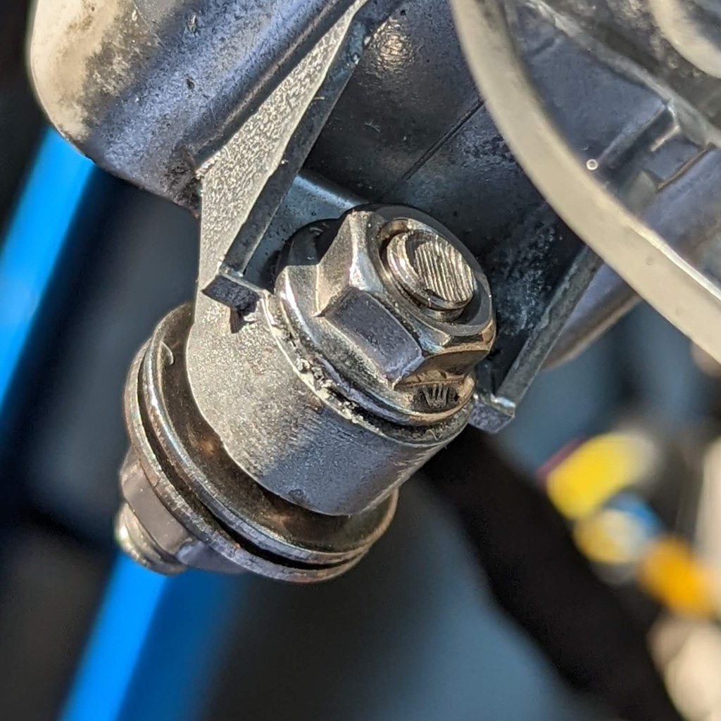

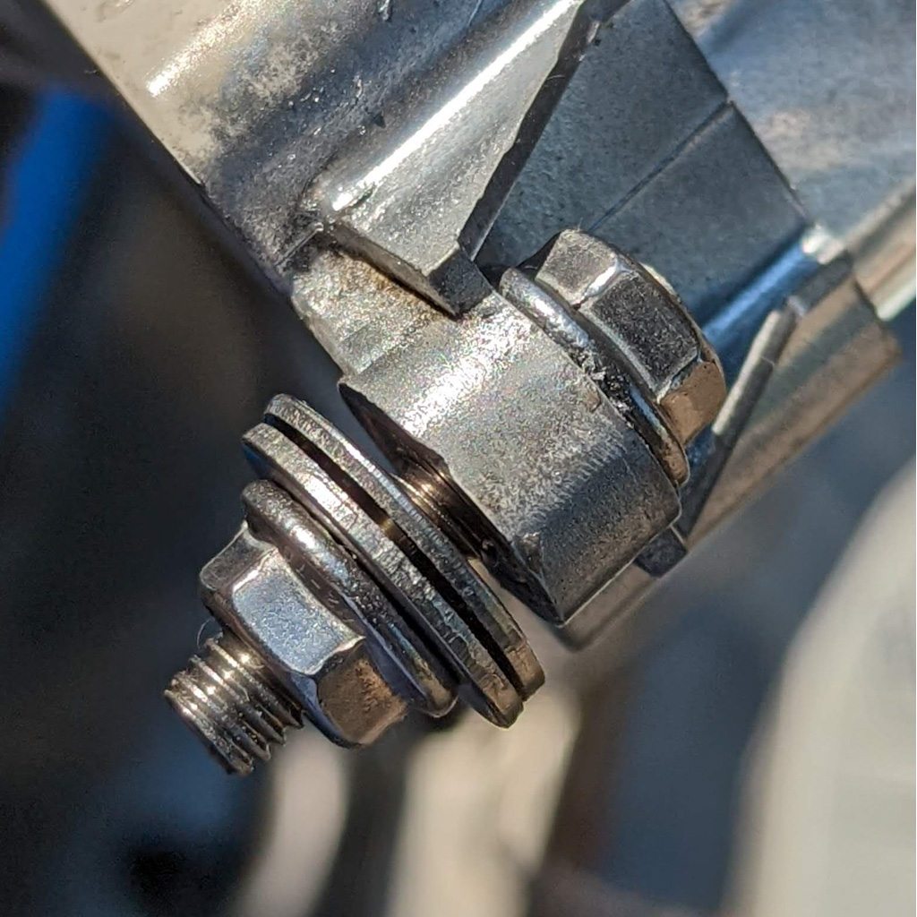

I ended up making my own. Took the bumper cover off for adequate access to the back side of the fastener. Used the exact same approach for the fog lights.
I used red loctite on the forward-facing flange nuts. The washers sandwiched the bumper material. Installed everything with the bumper cover removed, then attached the bumper cover to the car.
M6 threaded studs (25mm) with corresponding flange nuts and fender washers, all in 304 stainless iirc.

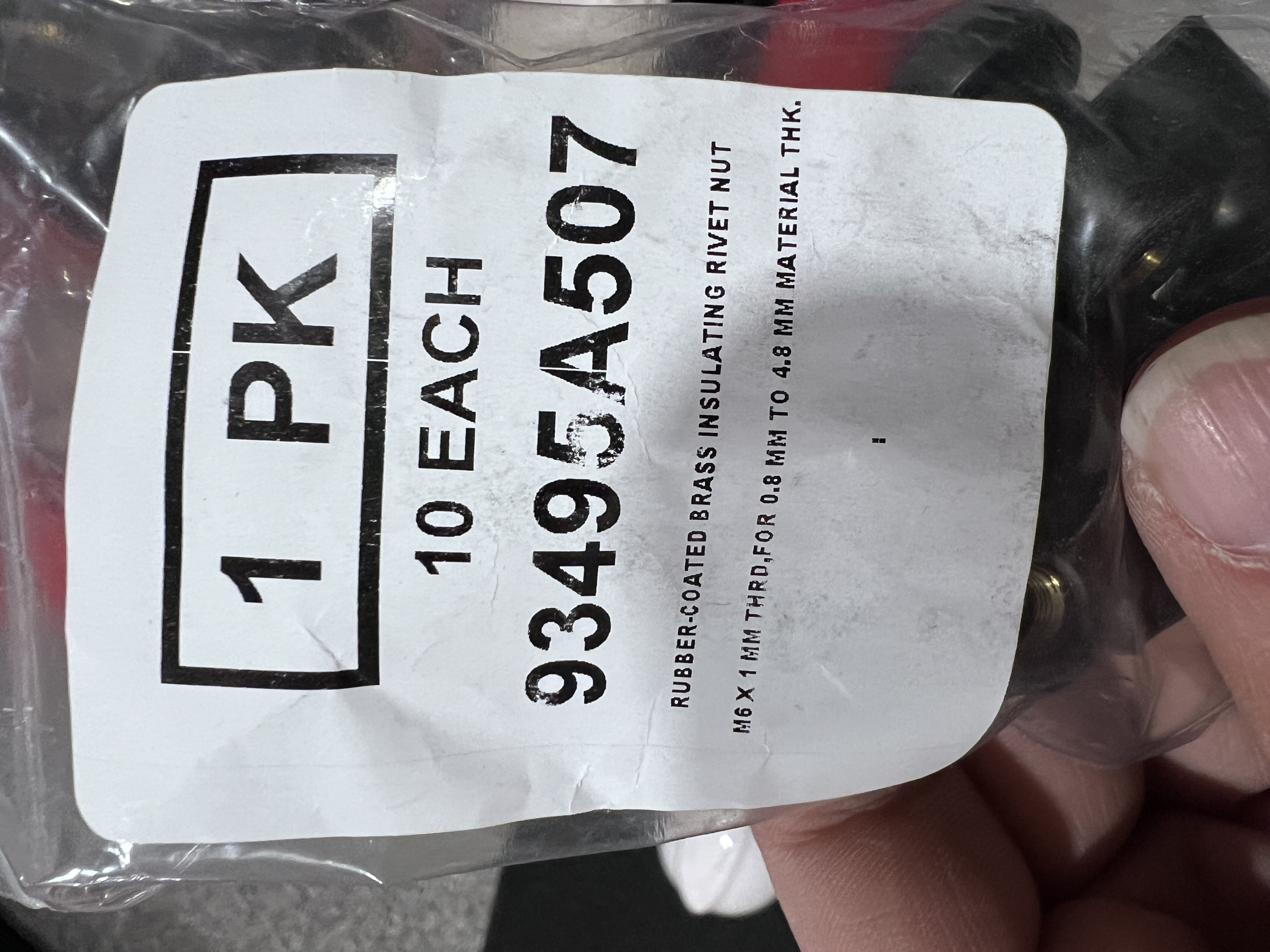

For anyone looking, I bought these from McMaster Car and they fit pretty snug in the existing holes. I don’t have the right size washer to fit an m6 screw, but waiting on a new(used) assembly anyway.

Good deal. Glad you found some.
