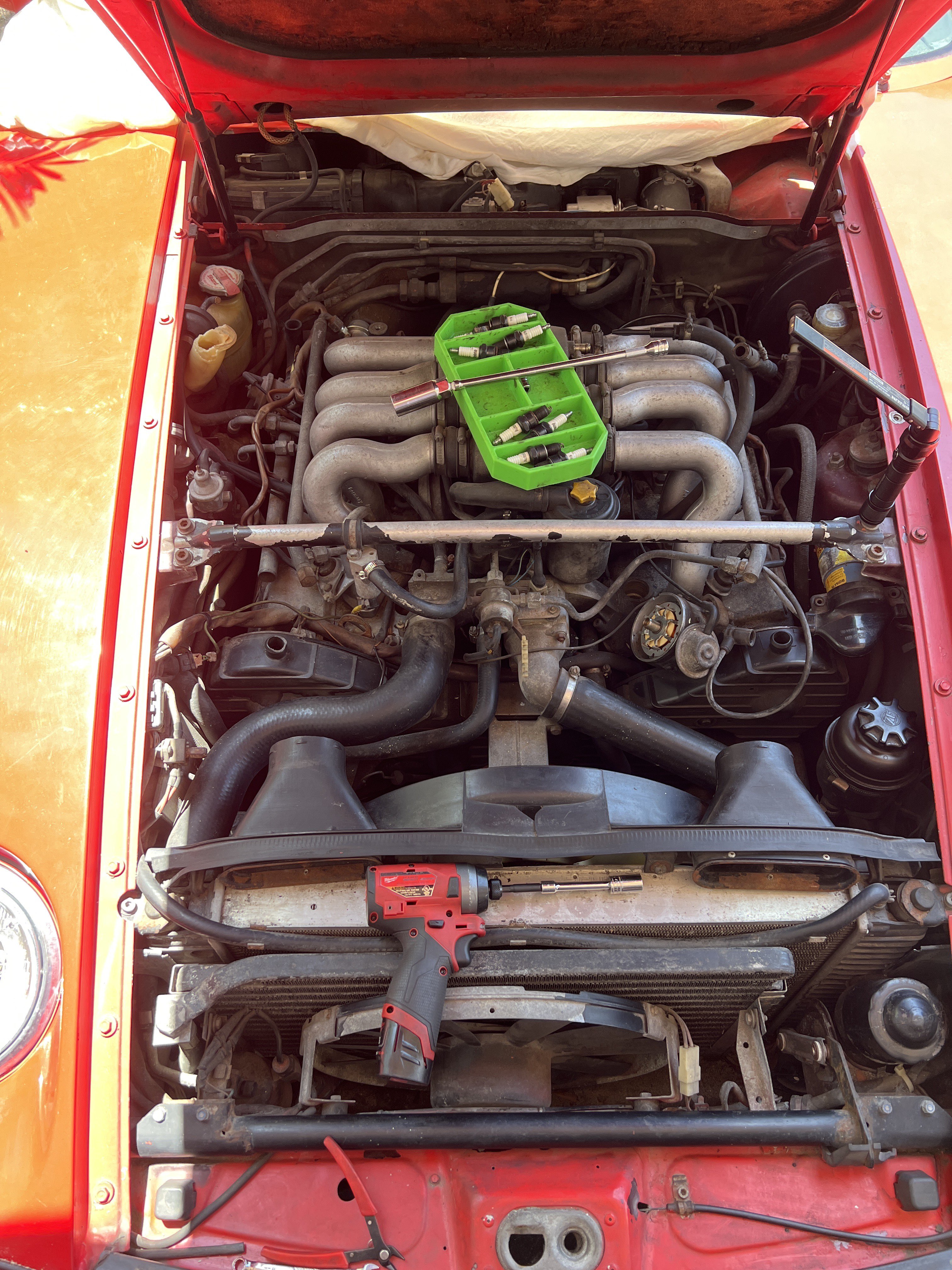

The car didn't really run super great, it felt like it had a constant misfire. There's a random part in the back which screams to me like *some* work was clearly done, as the car sat dormant for a decade, and several people were floating the title pawning it off to one another.
So first things first, I pull the spark plugs and see what they are, and cross reference them with what was original. Aaaaaand these garbage Autolites are two heat ranges off, and that's probably one reason it runs so poorly...
So I manage to find some NGKs locally that are equivalent to the original Bosch plugs, and 8 in stock. I place the order for pick up and while we're waiting on that we decide to do a compression test.
Much to my amazement, with a mostly cold engine (as with it warm, the intake manifolds make it impossible to try and remove the plugs without burning myself). Yes, compression tests really don't say a whole lot, just a 'yes/no' if there's a problem, but what I did get was an almost perfectly. Taking a 9.3 C/R and multiplying by 14.7 (atmo) I get 136, which my goal. I end up with cylinders 2 and 4 making 135psi~, and every other cylinder making 140psi~.
The amount of STRESS that doing cylinder 4 and 8 gave me, being the back of each head, was insane. I was thrilled to see this come out perfect. I was expecting some loss, maybe carboned up exhaust valves, but it appears I have none of that which was awesome. 928 heads, from everything I understand, have to be removed with the engine out. Engine out work is what scares me the most about a 928, and I think I've got a car where I can avoid all of that stress.'
After my dad gets back with the new NGKs, I have to check/regap all of them, and I get them installed. Car immediately runs way better. We find the plug wires, cap, and rotor are original 1983 somehow, so I get a replacement set of plug wires ordered that evening (not the cap or rotor yet, which was a weird decision), as the wire for #4 is separting at the dizzy end, but it was ok enough to keep running the car.
I get my timing light out and set the dizzy timing, which is *really* aggressive BTDC (at high RPM) for 87 octane gas (which is what the fuel door says to use, to my surprise), but it starts to run a bit better.
With that stuff done, we're making progress, and can drive the car a bit more, which is starting to become really fun.

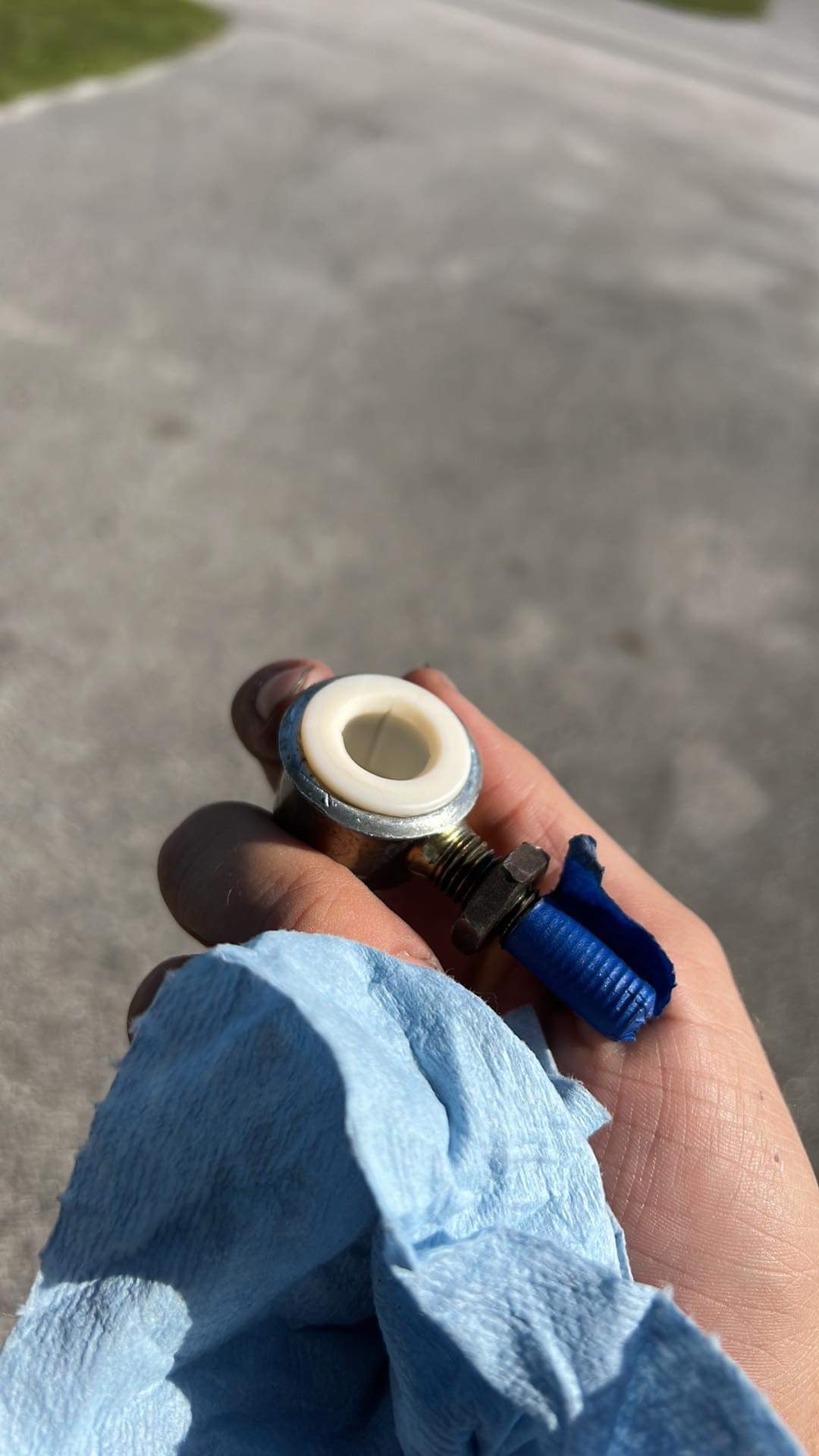

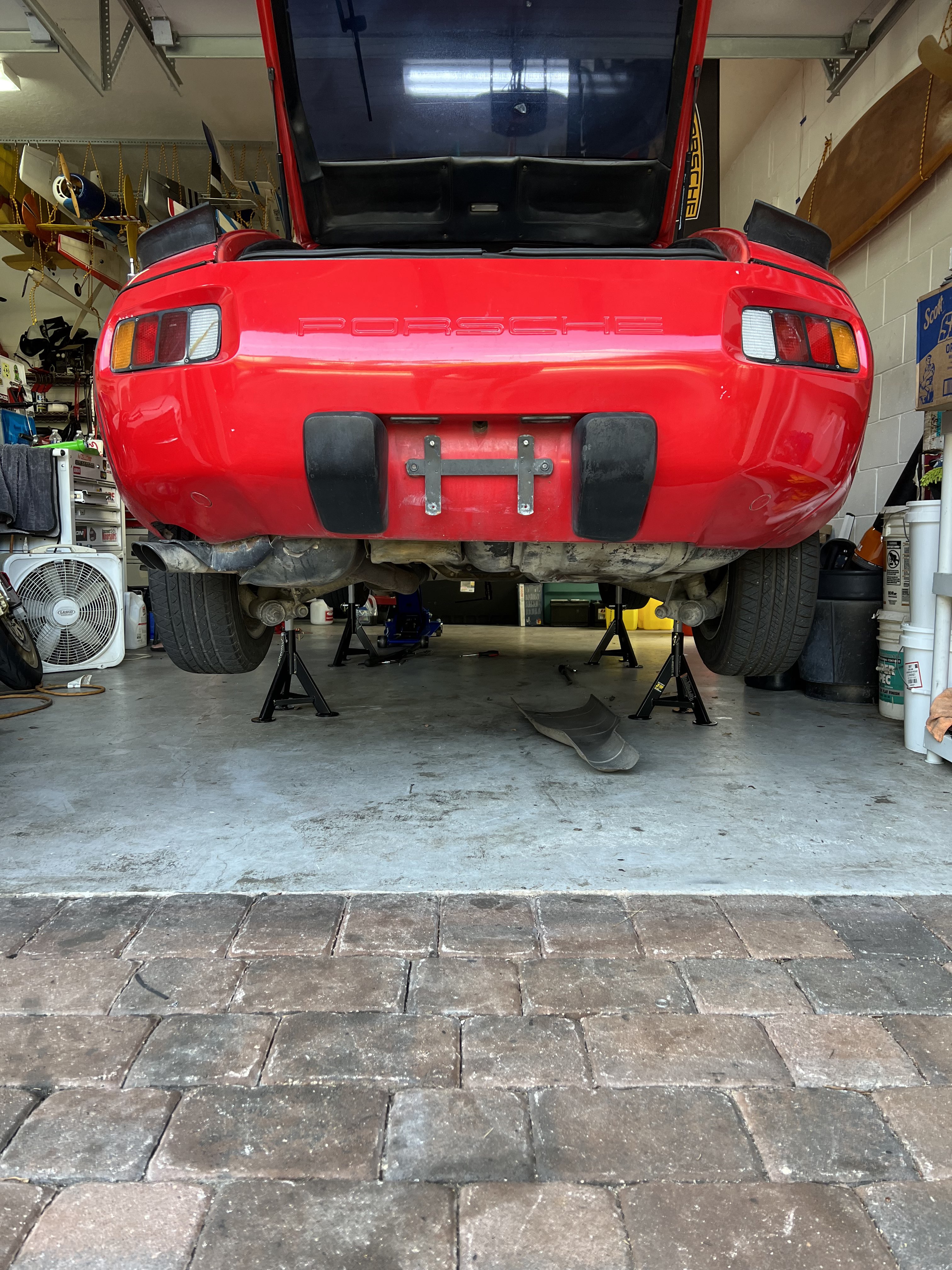

So with my fancy new jack stands we start to work on the shifter rebuild, now that I have the parts in hand. With it still outside I discover the shifter coupler at the transaxle side, the locking screw for it was backing out. I tightened that up and it immediately got way better, but there was a lot of slack in it. It also weirdly looked like a brand new from Porsche one?
I already had the 928srus bushings all around for the car, so we removed it. My dad worked on that by himself aaaand broke it. So after another week thanks to James Izzo I got an original that needed bushings, so perfect. Get that repaired (unfortunately, no pics), and work on the front cup, which I could not get fully seated in...but we sent it anyway.
Putting the shifter parts back in, without dropping the TT, we decide to use a ratchet strap around the end of the ball cup and TT to pull the cup back on. It worked, except I didn't get the ratchet in the right spot and bent the push rod. Somehow we were able to straighten in place, and fix it. With that, we got the shifter all back together and rebuilt. Putting the front and rear push rods back on the shifter lever itself was really fun. Huge PITA. Can't really describe it, but if you know you know.
Shifter being rebuilt now, the car is much more drive-able. It is honestly the *WORST* shifting Porsche I have ever driven, which apparently is how it is. Appears I got lucky and have a good transmission so that's good!
