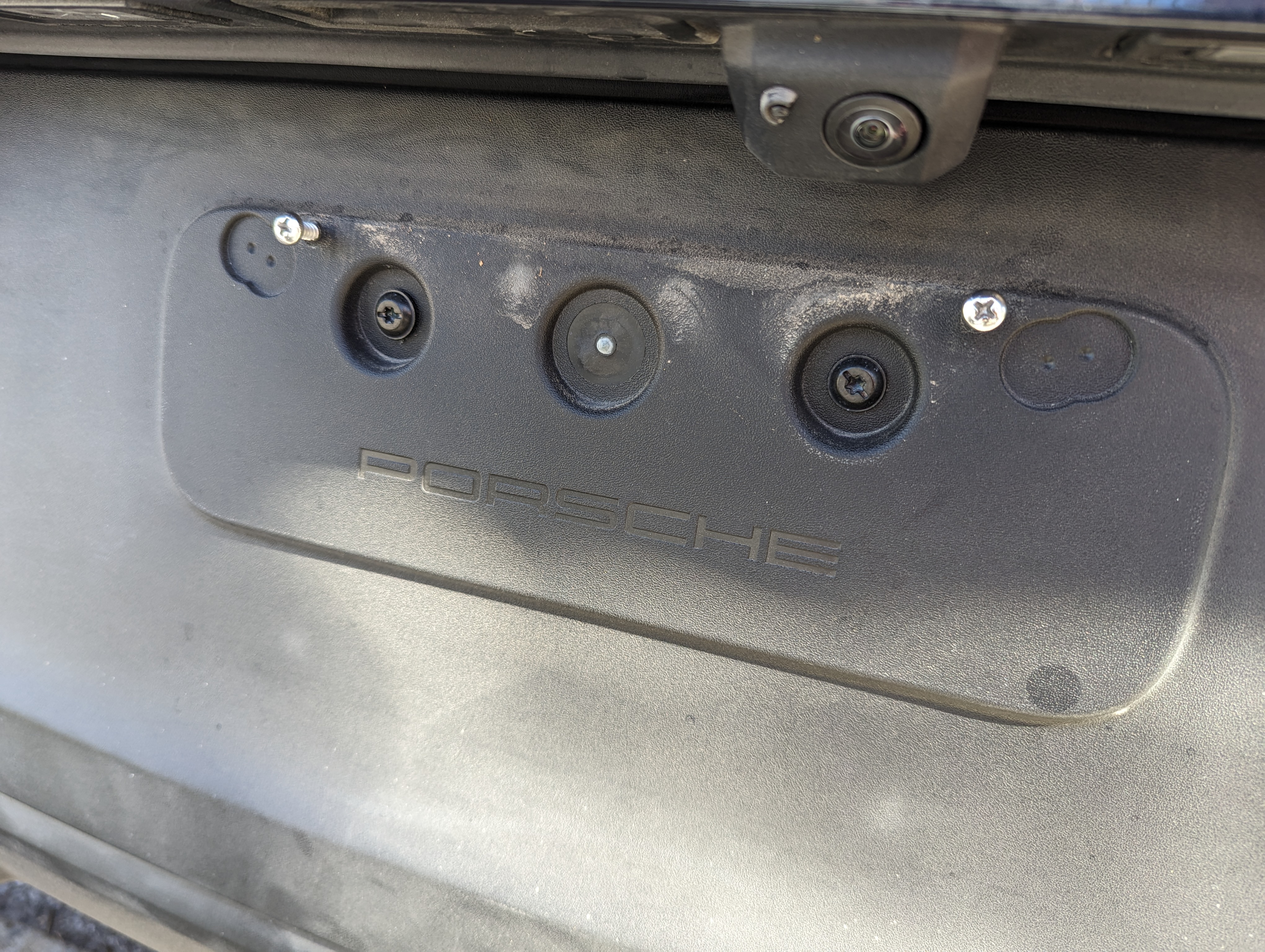

On another note, was trying to figure out if I could jury-rig your license plate mounts for the new Cayenne that is due in mid-Feb, so I looked at the rear plate area of one today and I don't see a way to make anything work. I guess it's drill time - the different dimples for various countries' different sized plates are there, so in that respect it's a "world" car I guess. Unfortunately, the surface as dimpled and oddly shaped - not much to stick to.
The Cayenne I looked at today has already been drilled and has screws in it. The material is thicker than that of 718's and 911's but it's still some kind of plastic material.

Some of the early base 992's had an unpainted, textured plastic like that for the license plates. My local dealer actually used our 992 mounts on that material, but I was never all that comfortable they'd stick with the same tenacity as they do on smooth paint. We could surely design a shape that could fit that area with 3M molding tape, but I'm interested in those two screws in the middle? If those are secured in metal, perhaps we could design a piece that secures to the bumper with those screws, and extends out where needed to offer threaded holes for the license plate?

My first thought yesterday was that they held were there to hold the raised portion but there are no seams around the edge - the raised area is molded with the rest of what's visible in the picture; they are one and the same. I have not figured out exactly what they are for. Maybe they are helping to secure the bigger piece?
I'll look into it further when I'm there today and take better pics. I'll get some measurements too.
