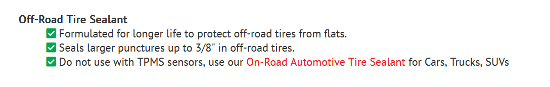

Tom wrote: Sat Nov 04, 2023 1:48 pm When I popped my tire on a curb (which materialized out of thin air), I used the goo that come in the frunk. The hole was too big and it leaked all over the ground. When I finally got to the dealer (on a flatbed), the shop manager told me never to use those tire sealants if you can avoid it -- he said often that stuff ruins the tire pressure sensor and, at least at the time, those sensors were in very short supply...
Very true. If you use that kind of sealer, your sensor will be shot.
Actually, the provided link says not to use that particular product if your car has tire pressure sensors. (The linked product is labeled for specifically for off-road vehicles.)
Rather, they say to use one of the kits they make that is designed to work with cars equipped with tire pressure sensors:
https://www.tireject.com/collections/au ... t-products
A quick glance at those kits look promising. They might be pretty good.
