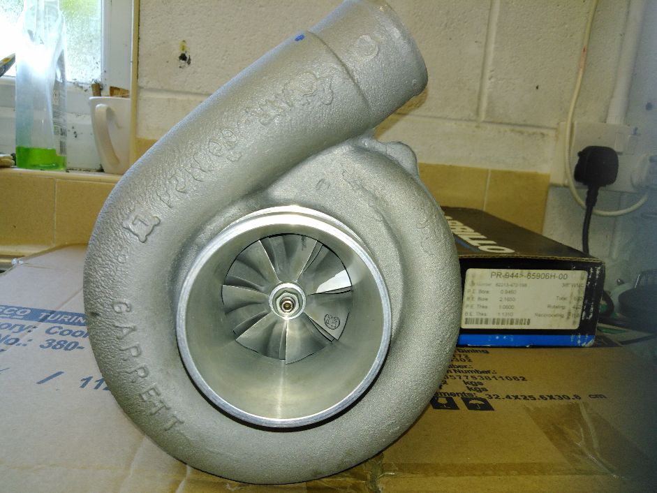

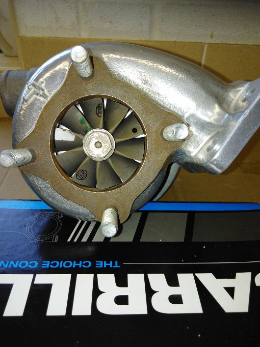

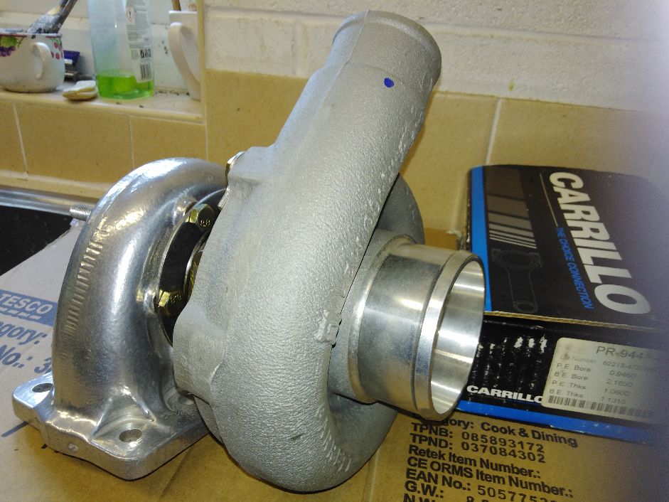

I've had this Lindsey turbo in a box for years. It has 10 written on, and stamped in the turbine housing. I think it's a 61-10, anyone else think differently?

blade7 wrote: Thu Nov 02, 2023 11:29 am Over 50 views, and no one knows.
I haven't a clue, but the Lindsey website does list the 'Super 61" as having the option of either a 8cm2 (#8) or 10 cm2 (#10) turbine housing. Maybe that matches to the "10" on yours? I didn't see that option on the others listed on the Super Series page.

GT3Twenty10
Posts: 161
Has thanked: 20 times
Been thanked: 98 times
I can’t read the markings…
Looks like a T60/1.

Had a quick measure, compressor inducer=70mm, exducer=45mm. Turbine exducer=63mm, inducer= 47mm. All approx.
GT3Twenty10
Posts: 161
Man it’s hard to know, but I’d guess T60/1 to T66

gruhsy
Posts: 534
Has thanked: 48 times
Been thanked: 83 times
It’s the 10cm housing.
Lindsey didn’t sell a T60/1
The 8cm or 10cm were the options
You could call Lindsey to get the definitive answer.
