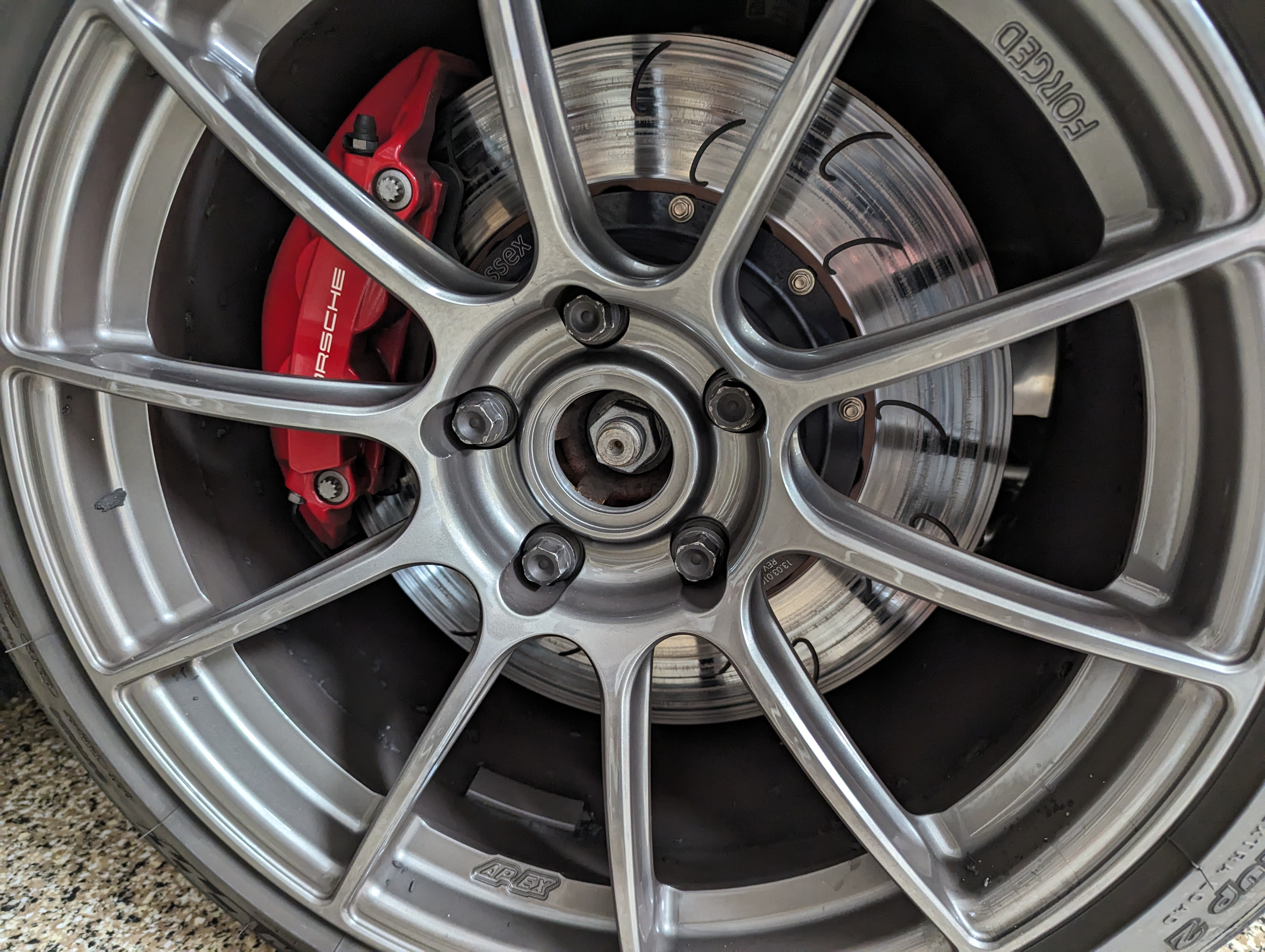

They are out now...
Apex sans center cap Oct 2023.jpg (2.63 MiB) Viewed 1688 times

Excuse my track naivete, but what are the sharpie marks on the rotor? Checking for wear patterns? And is it just the picture, or are those rotors pretty grooved up?
I have to say, I kind of like the no-cap look on that wheel. :)
Re: Melted Wheel Center Caps
Posted: Thu Oct 19, 2023 7:23 pm
In all fairness, the center caps are not designed to withstand the intense heat generated by serious on-track driving. Apex recommends removing the center caps for track use (something I overlooked!), so that's really on me.
The rotors are AP Racing's Competition J-Hook rotors and they are excellent track-oriented rotors. The "sharpie" marks are actually the J-hook shape of the heat dissipating slots on the rotors. Not drilled either - I don't like drilled rotors - they reduce strength, induce long cracks and don't add anything to the performance or heat dissipation of the rotor. It's more of a marketing angle - "Cross-drilled and slotted" sounds good.
Yes, some smooth grooves but also some of what you're seeing is the burnishing from the well-matched Ferodo DS3.12 race pads. These rotors have close to 2,000 hard track miles on them so, while they are still performing magnificently, they are showing their age. (Kind of like me ... :lol: ). However, still plenty of material and thickness and only tiny, short crazing. (New the thicknesses of the rotors are 34mm ft and 30mm rear.) It's an awesome brake setup for track.

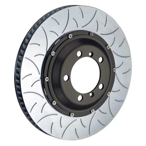

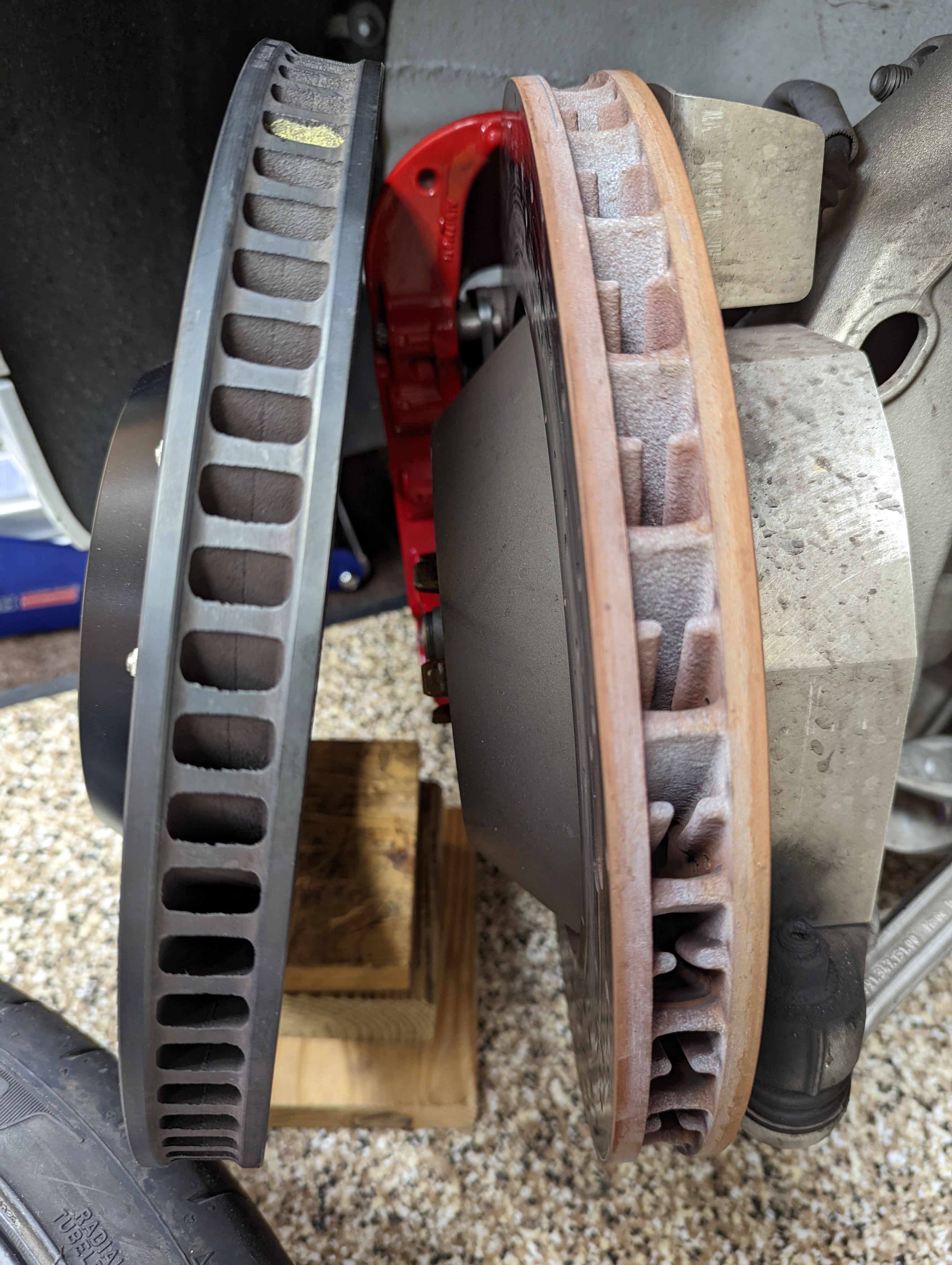

Photo of one of my AP Racing J-Hook 2-piece rotors when new before installation. The other pic is the new AP Racing rotor next to the GT4 Porsche OEM rotor. Huge difference in cooling fins (number and design), weight, rotor material, etc. The front OEM rotors were already shot at only about 1,000 track miles. They were below minimum thickness, were grooved, had unsafe cracks (long ones emanating from the drilled holes), etc.
OEM to AP Racing is night and day.
