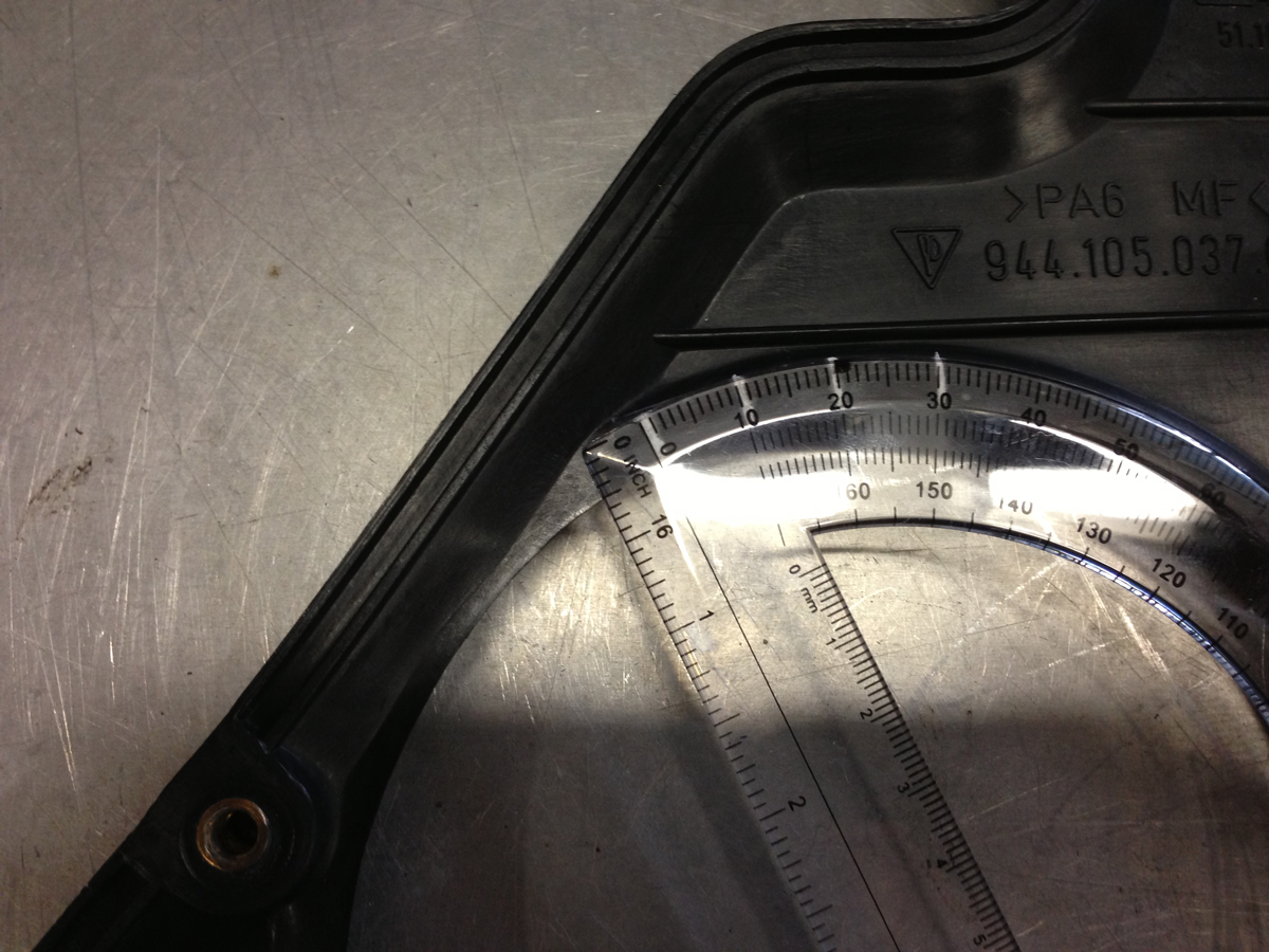

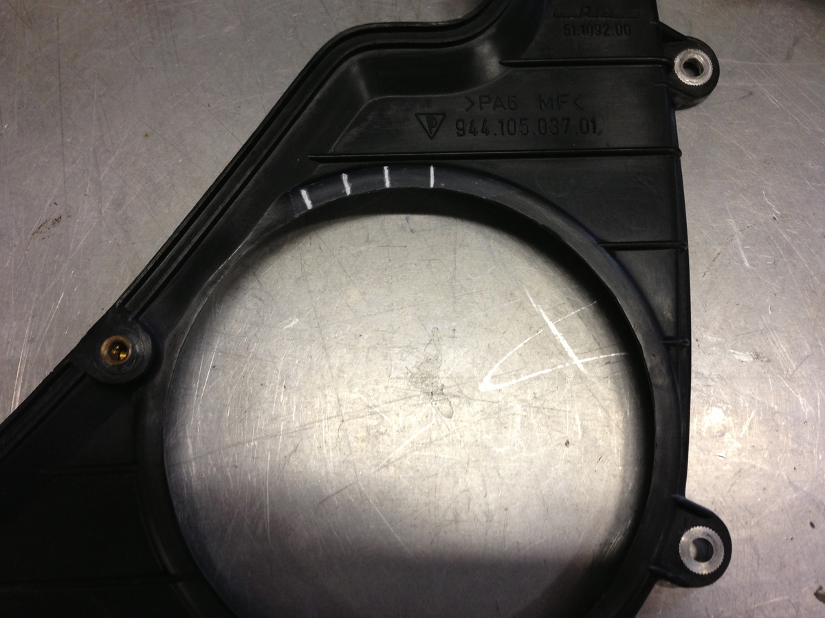

Before any of this, you should use a timing light to verify that actual ignition timing is what the MicroSquirt controller is showing. You can either make timing marks on the front cover like @Tom did, or you can use the OT mark on the flywheel if it is visible.
