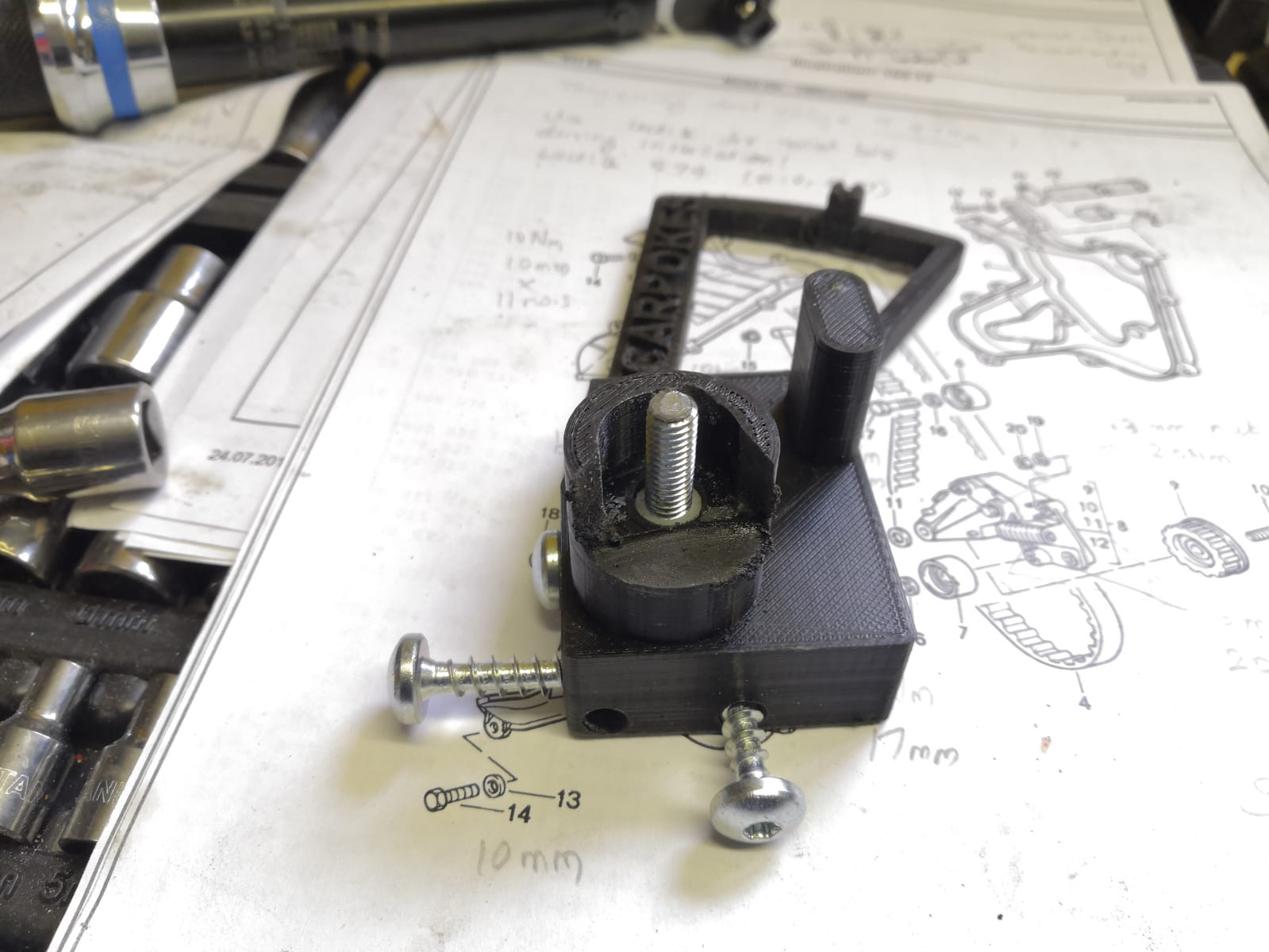

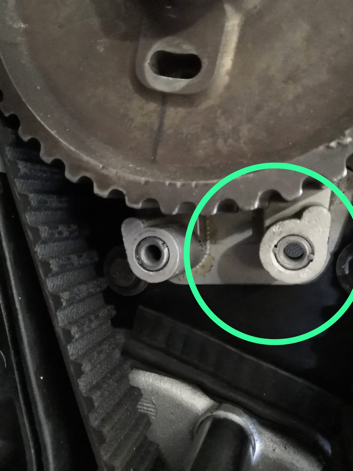

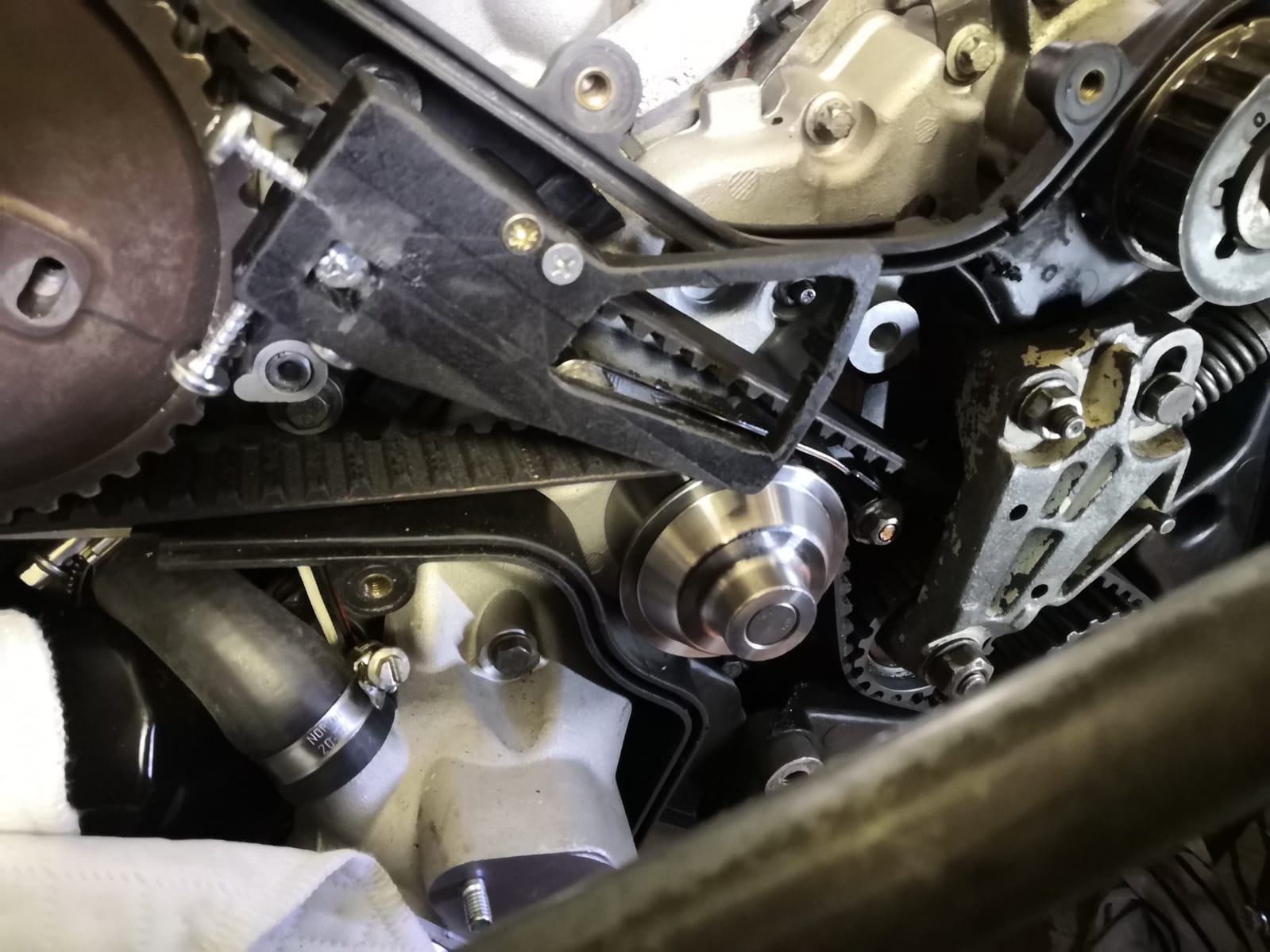

I own a 1987 944S 16V (M44.40) model and I found that the tensioning tool designed for the 8V already available does not work with the 16V model. It will be great if we can have one set up for the 16V models as well as when I tried modifying the current 3D printed tool it did not seem to work correct. Anyone who can lend a 16V motor to @Tom would be helpful for all of us.
Some reference images from my work.
Bigger boss under cam gear for 16V:
Modification to 3D printed model for 8V:
Placement after modification:

I should have checked for compatibility of the tool over a 16V engine well before printing it as another fellow member pointed out in their thread. But I decided then, not to think any more and just give it (3D printed tensioning tool for 8V) a try. Even though that was not a good idea, it made me motivated to do the job (not with perfect tension but good enough), which I completed yesterday (AUG 17).
Issue was that the cam gear and the timing belt for 944S (same for 944S2) are different from rest of the 944 engines. So the tool for 8V wont have the calibration for a 16V one.
That being said, if I had known this before I would have not dared taking this job up and doing it myself.
All good in the end.
Next week I'll take the car to Porsche center for checking tension and make it perfect.
So, a dedicated tool for the S models would be good to have as I'm not sure on buying a Porsche 9201/2 tool for a lot of money or wait till I get hands on a used 'Arnnworx' tool (not able to get new).
