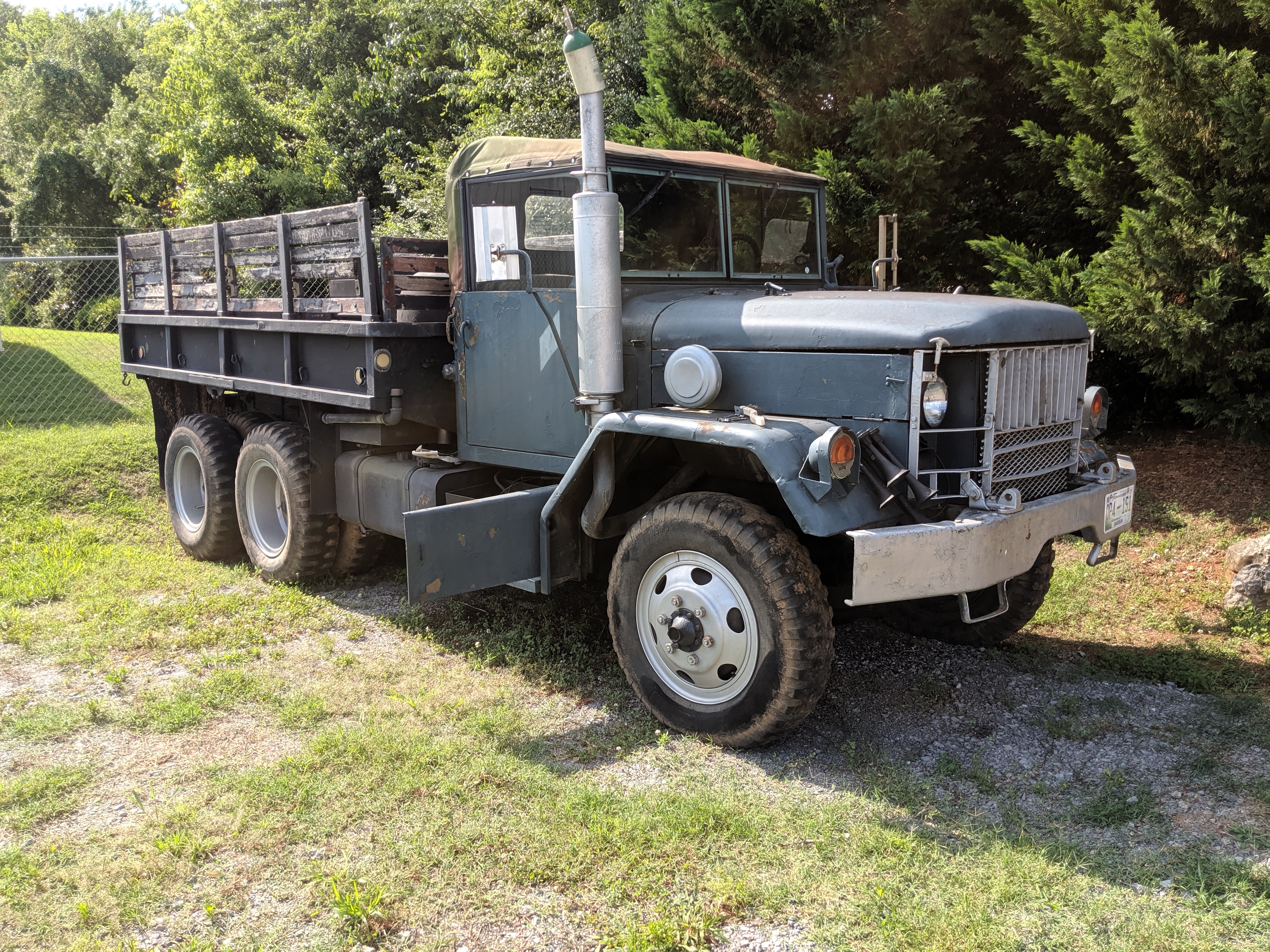

Meanwhile, get yourself one of these - I can assure you that there is no ACC! (This was mine for a few years. Was too much work and angst to drive so it sat! Lol.)
