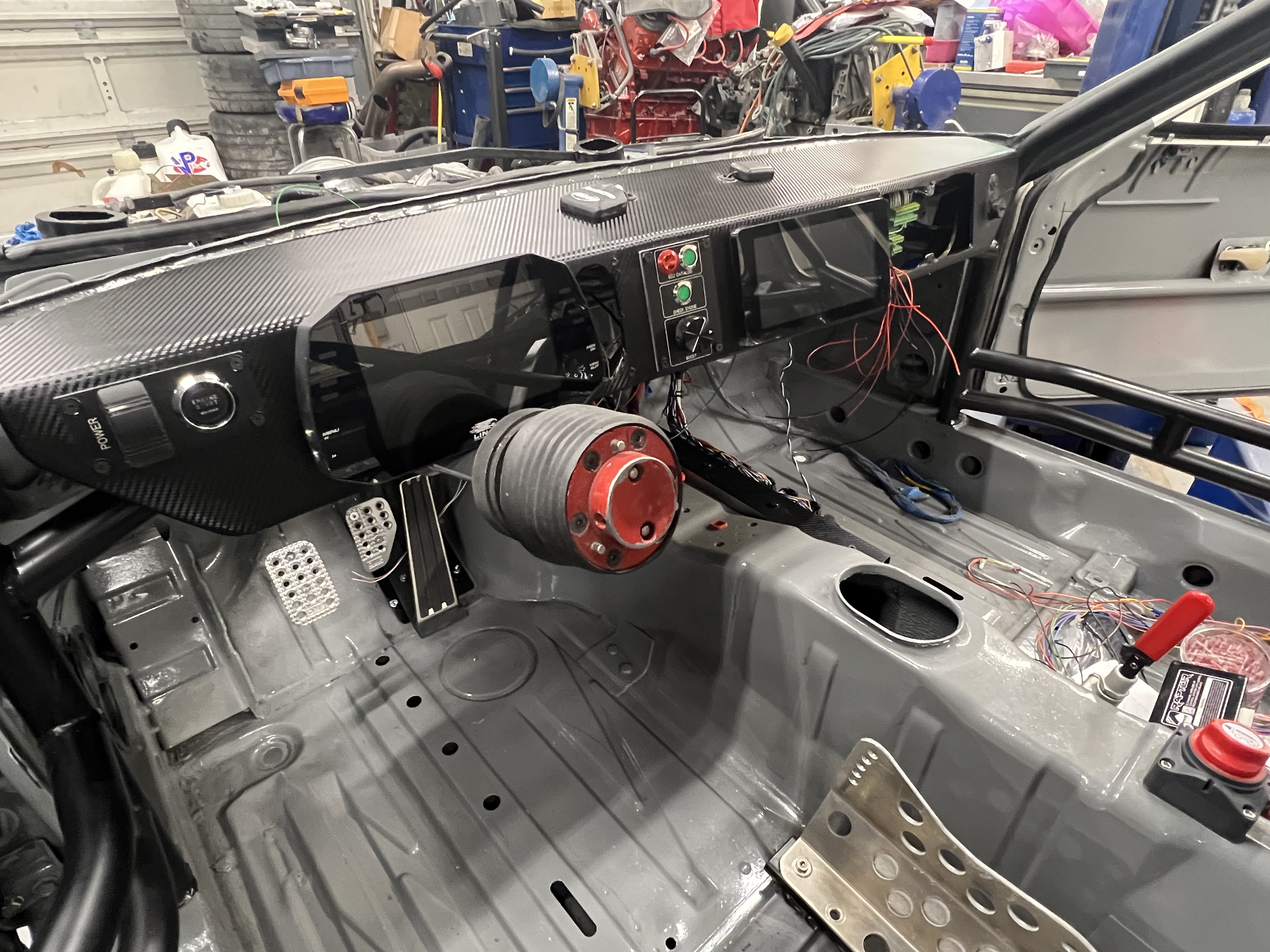

Progress is slow, vacation in Europe got in the way!

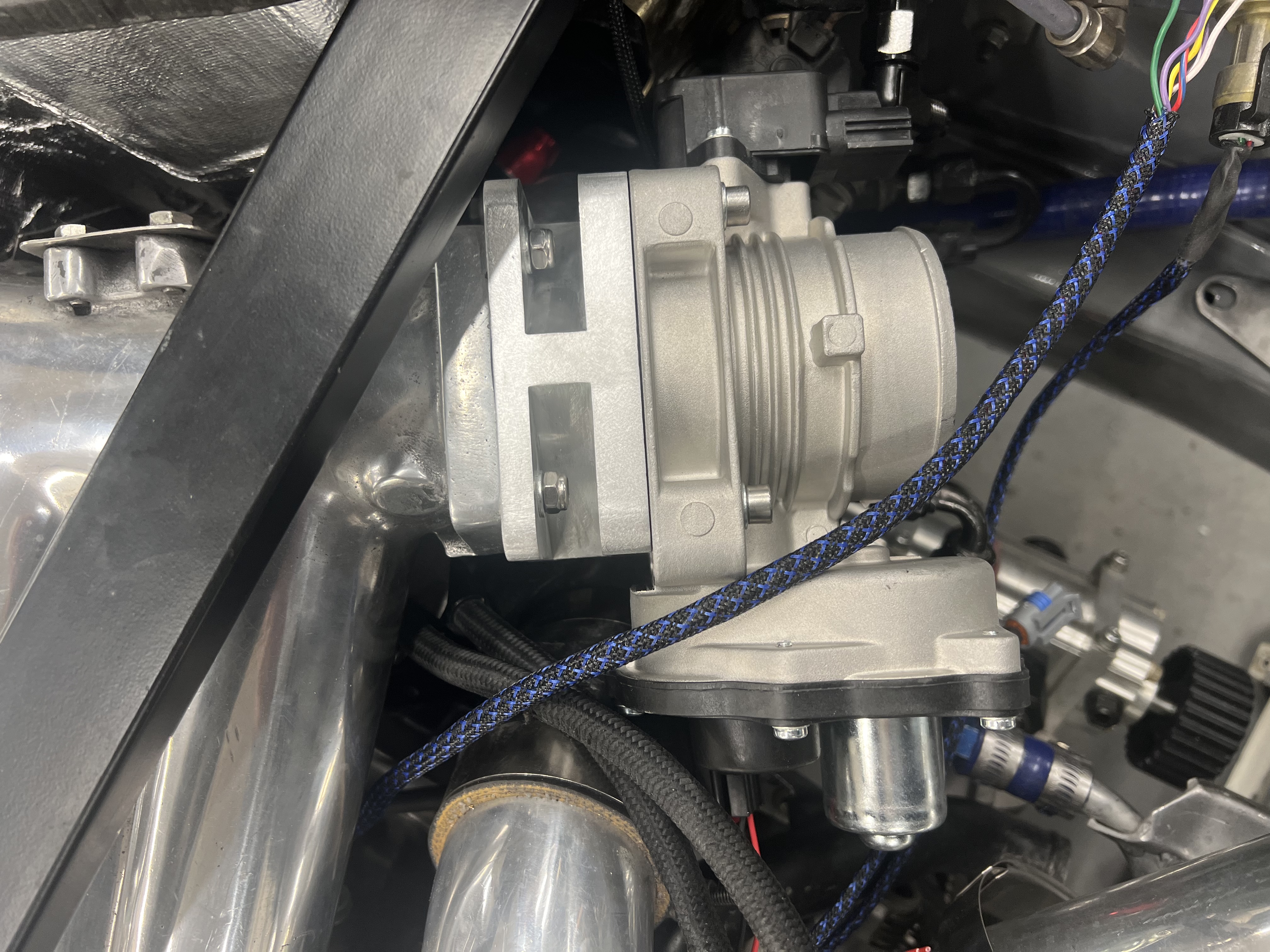

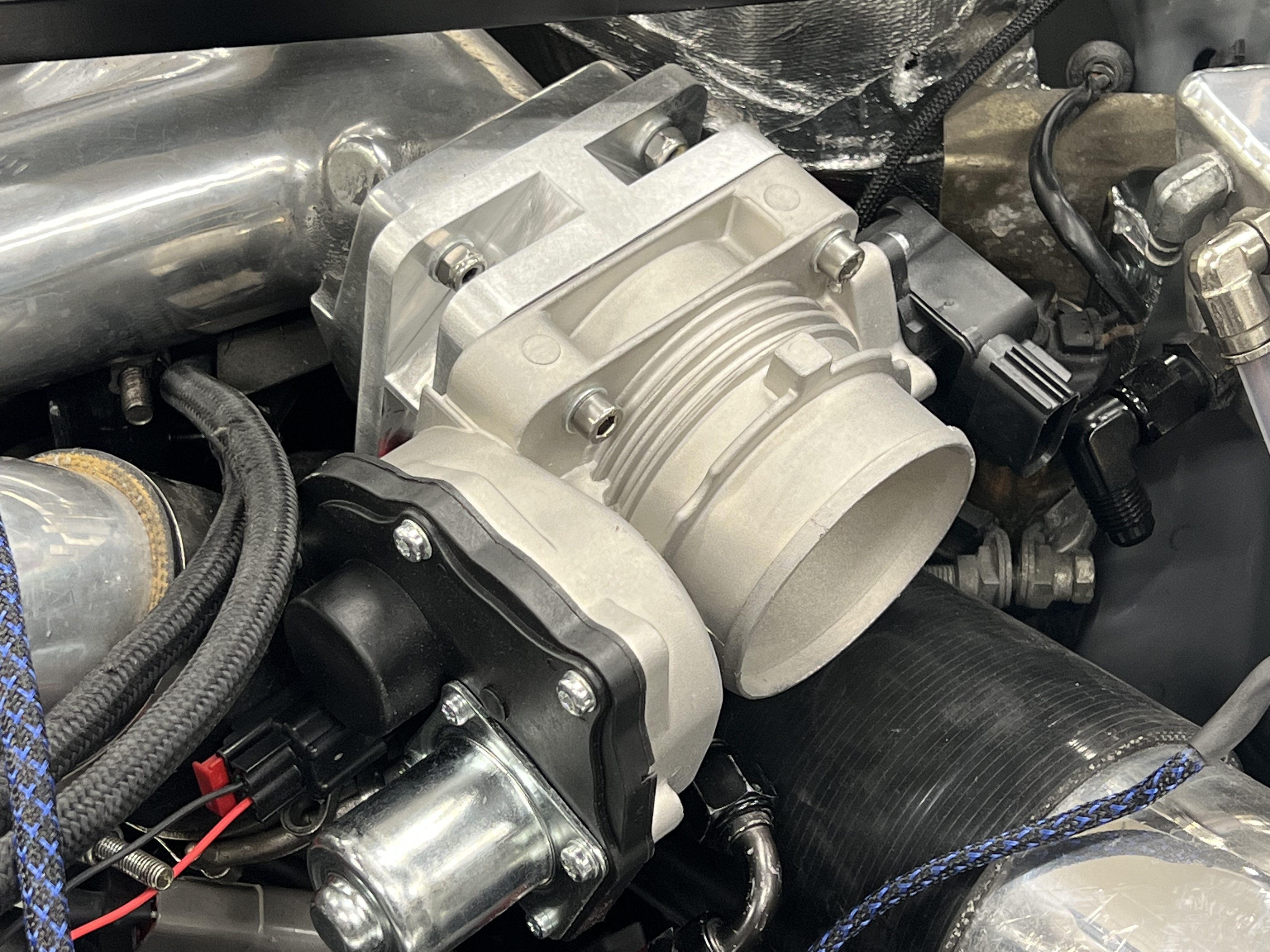

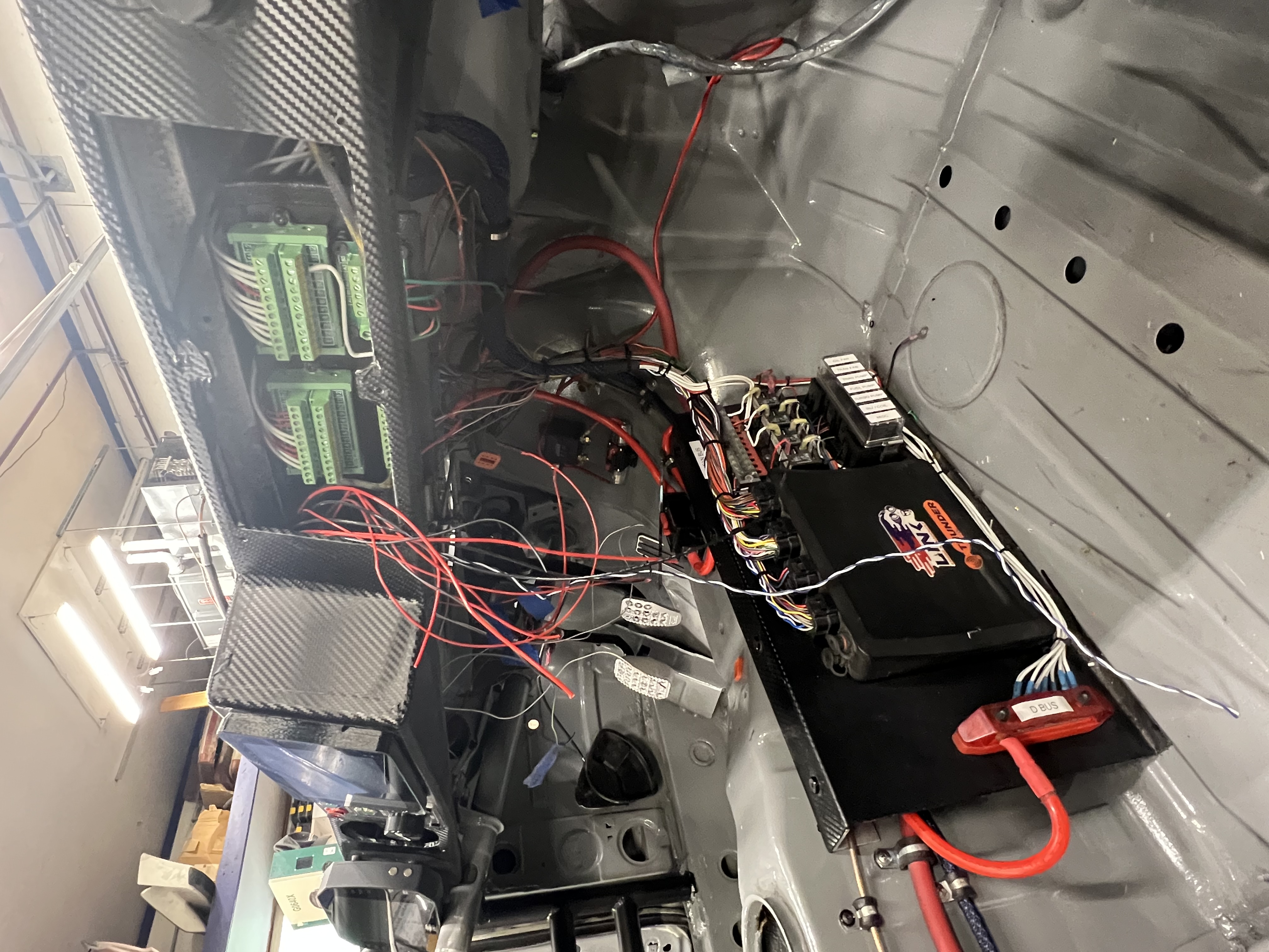

Loads of wiring and machining the ethrottle adapter.
LSD has been rebuilt and loads of other details

BTW - the Link controls an amazing amount of things on this car - two separate cooling fan circuits set at different temps, oil cooler fan set to oil temp, trans cooler pump and fan set to trans temp, push button start/stop, E throttle, auto blip for down shifts, boost control and I still have at least a dozen more channels. Can bus to Aim dash, Aim Solo and powertune digital dash.

Also scored a Raptor RF button system (by summit technologies in England) to add to the quick release steering wheel. 8 RF buttons to control 8 relays. I'll be able to scroll through the various AIM dash screens and program one as a 'push to pass' button to add short term boost....mmmm, toys!
