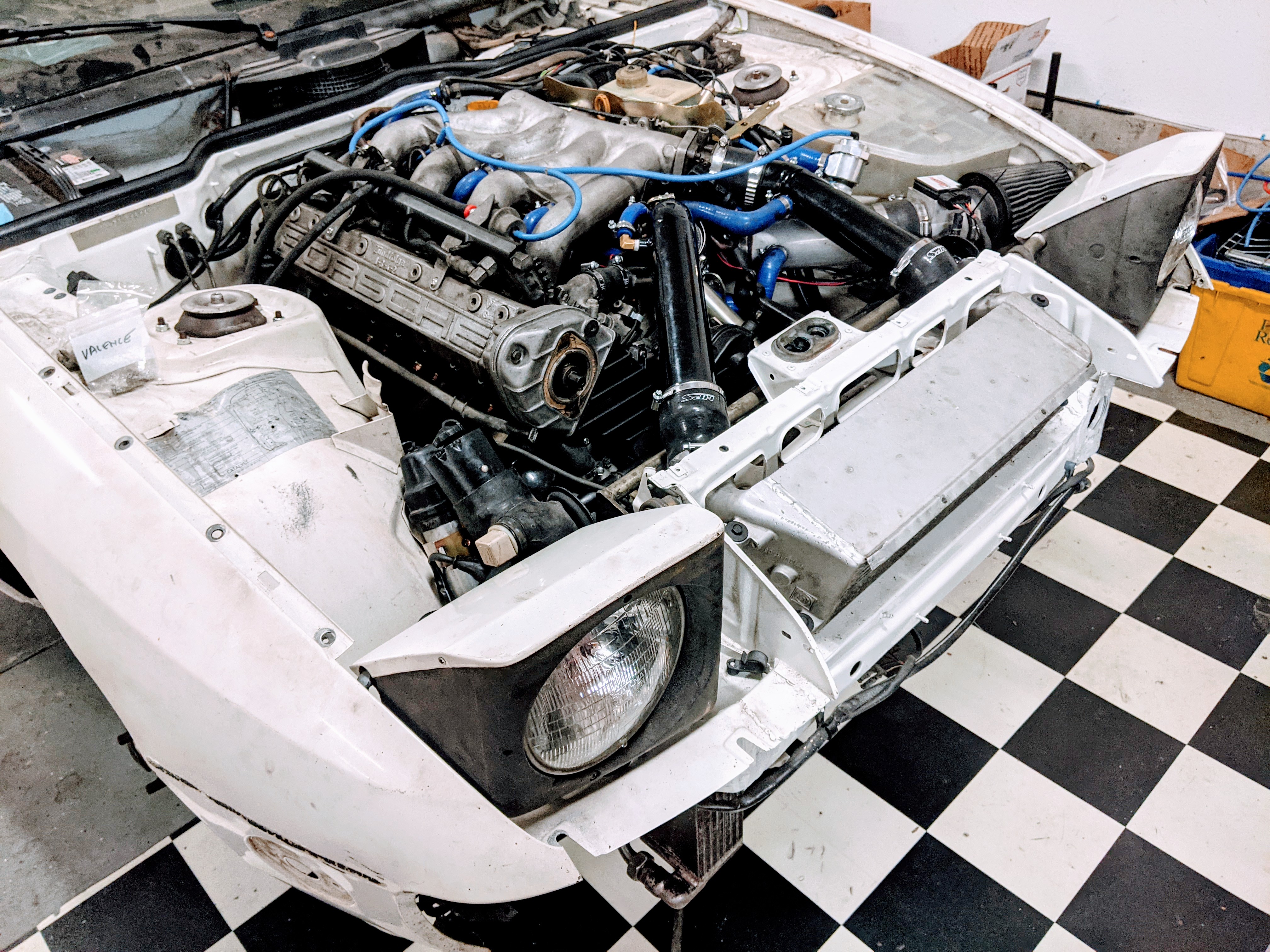

Rasta Monsta wrote: Tue Jun 17, 2025 10:25 am Any chance of getting one of these?
If it helps, it's for my awesome 924s/951 swap
Interesting car. We need to see more of it and what's going on under the hood. :) Are you having no-start problems? I'll have to go see if I have the parts to make you one.
