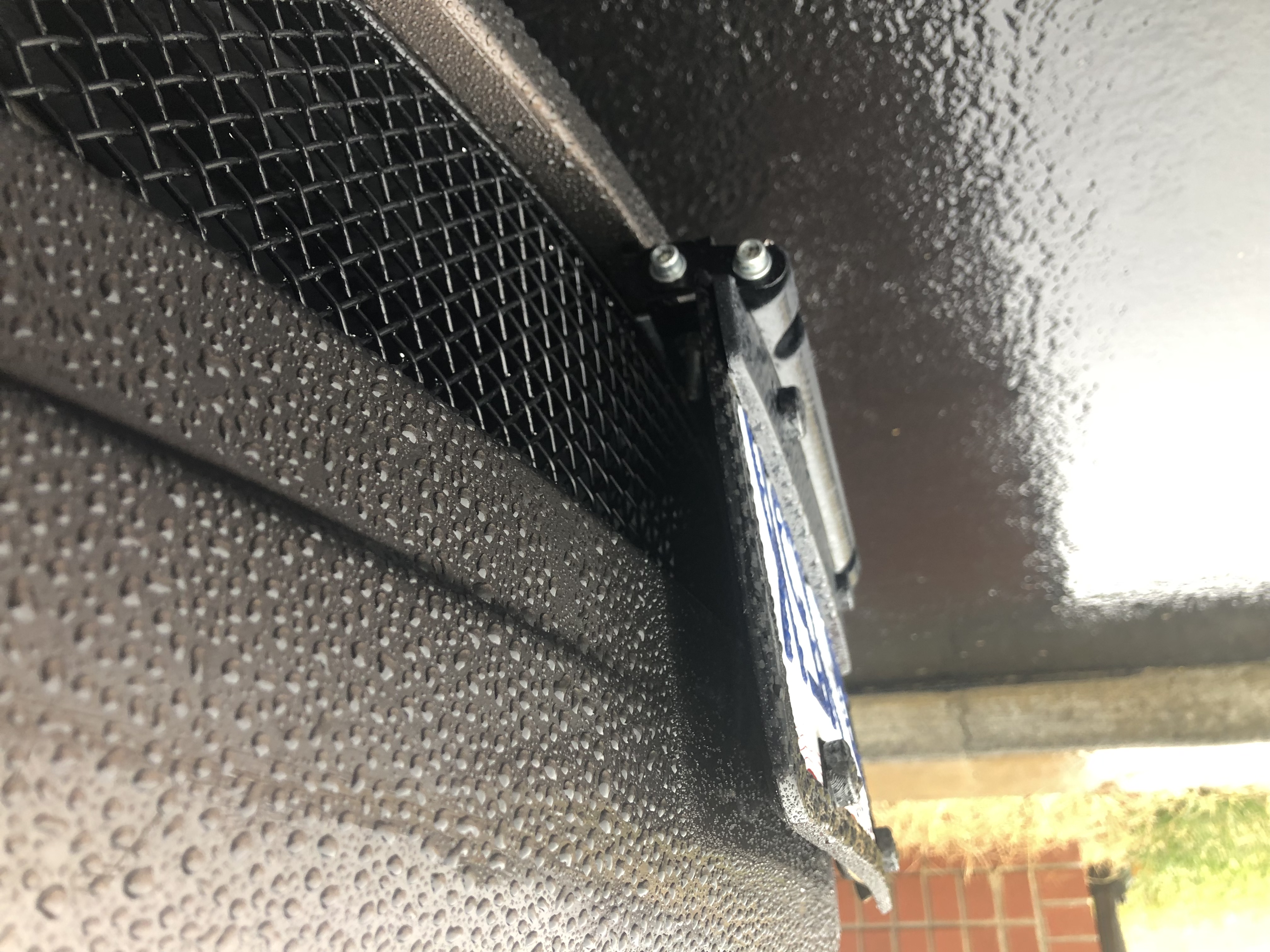

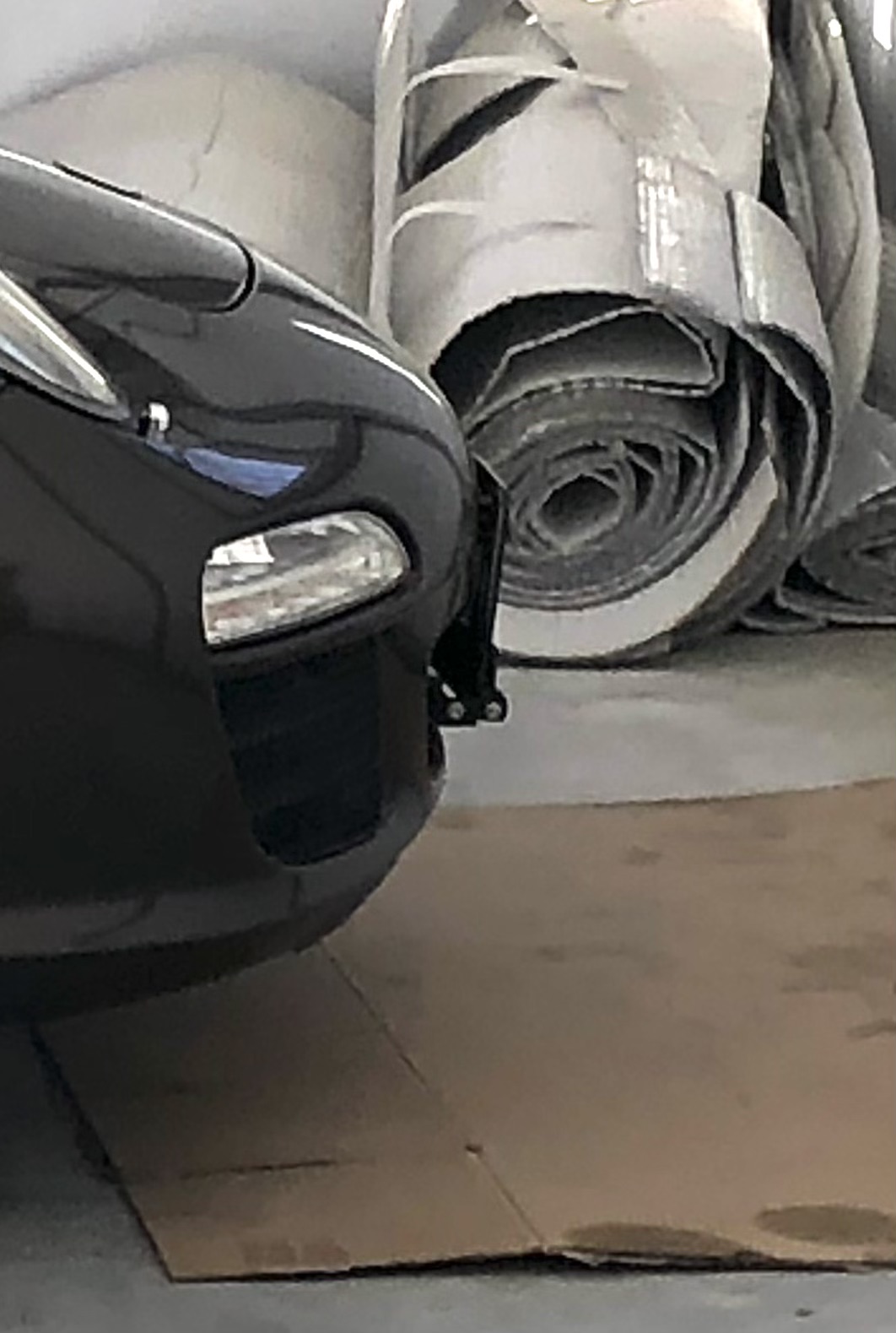

I made a carbon fiber front plate center mount for my 997.2, after not finding a satisfactory solution on the web. I’ll take better pictures tomorrow and detail the sourced components. But I like the result.
Here’s the bracket:
https://www.amazon.com/Carbon-Front-Lic ... 95&sr=8-37
Any of the web available carbon fiber plate frames would probably work…

Here you go…

The resulting mount did not interfere with the center grill guard…

Rubber cone grommets on bolt ends make great bump-stop protectors….
