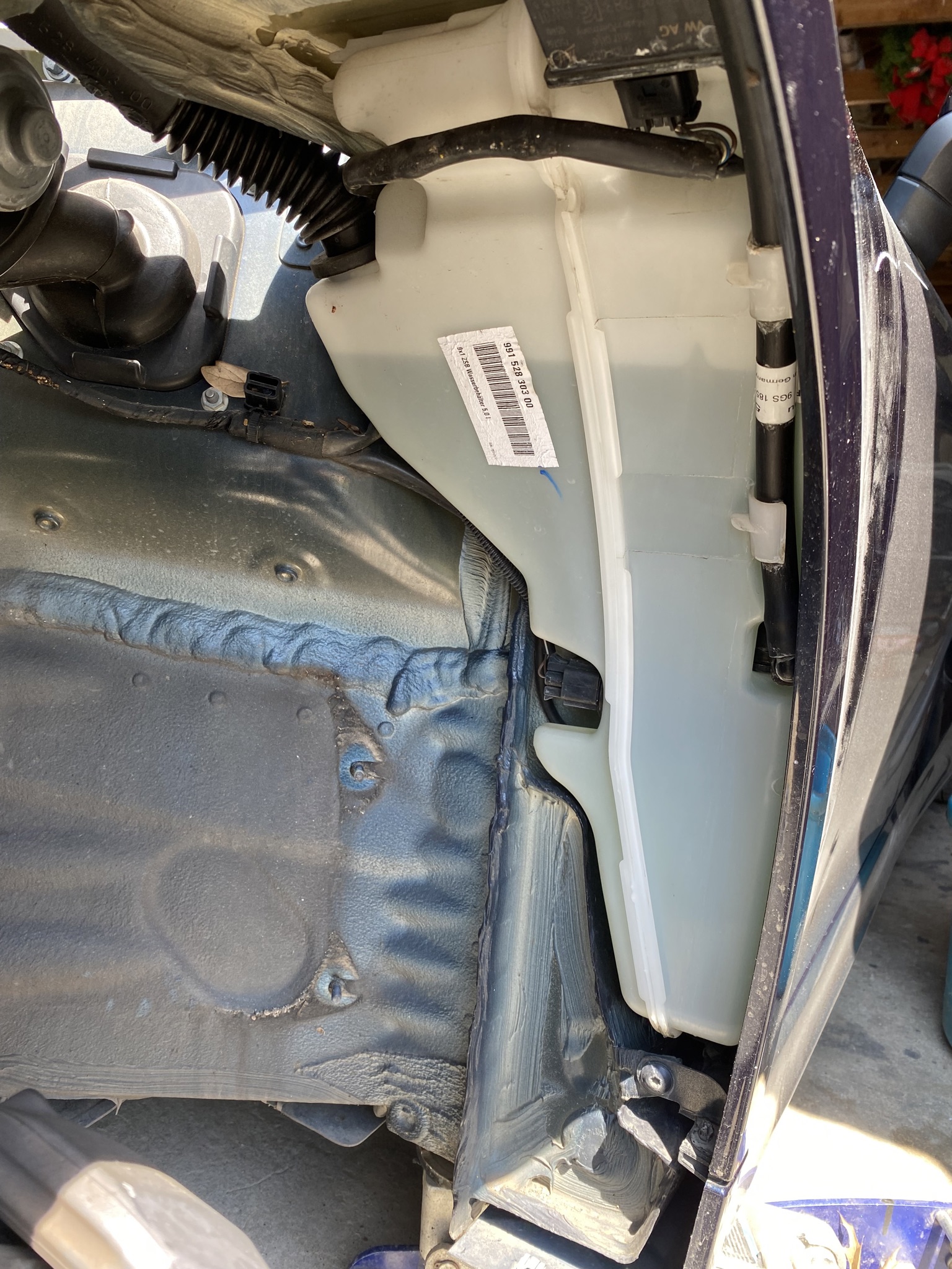

My 2013 Boxster leaks out the washer fluid. From the top everything looks OK. I haven't had the car on a lift yet. Is it hard to access this from below? Any tips are appreciated. Thanks in advance.

it is behind the fender cover on the drivers side . remove wheel, remove the panel and then you will see the tank, most likely you will have a leak at the grommet where the washer motor inserts or a line that is cracked . Pretty easy to see everything. There are a lot of attachments - basically will need a 20 and 25 torx bit driver and a 10mm socket There is one hidden attachment at the top of the tank , then you basically pull it forward and it pops out of its attachments ( rubber grommets )in the back. Replacement back it made easier if you lube the rubber gromets

This looks pretty straight forward and the pic will be very helpful. Thank you so much
