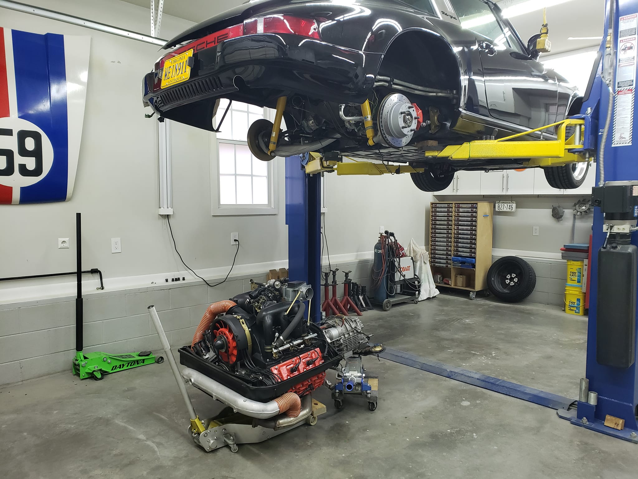

I use also a motorcycle jack. I use it under the engine, and in addition I use a small car jack on a furniture dolly, so it can roll in any direction, under the transmission. This way the engine and transmission can be tilted up and down as needed.
Here is a picture after it is down on the floor. Of course, it can be used also with the car just jacked up at the rear.

Carmagic wrote: Mon May 08, 2023 5:20 am I use also a motorcycle jack. I use it under the engine, and in addition I use a small car jack on a furniture dolly, so it can roll in any direction, under the transmission. This way the engine and transmission can be tilted up and down as needed.
Love that setup !!!
