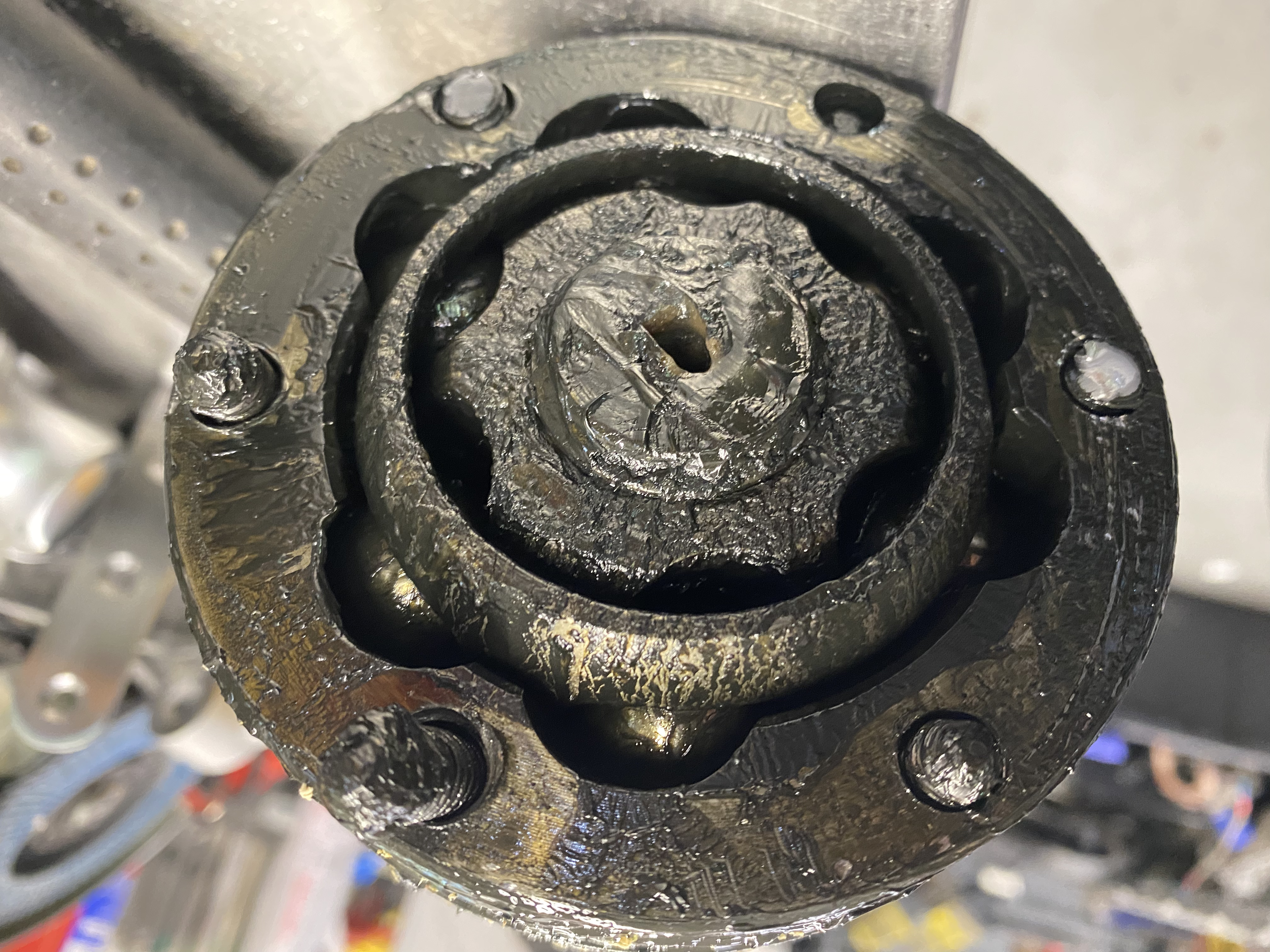

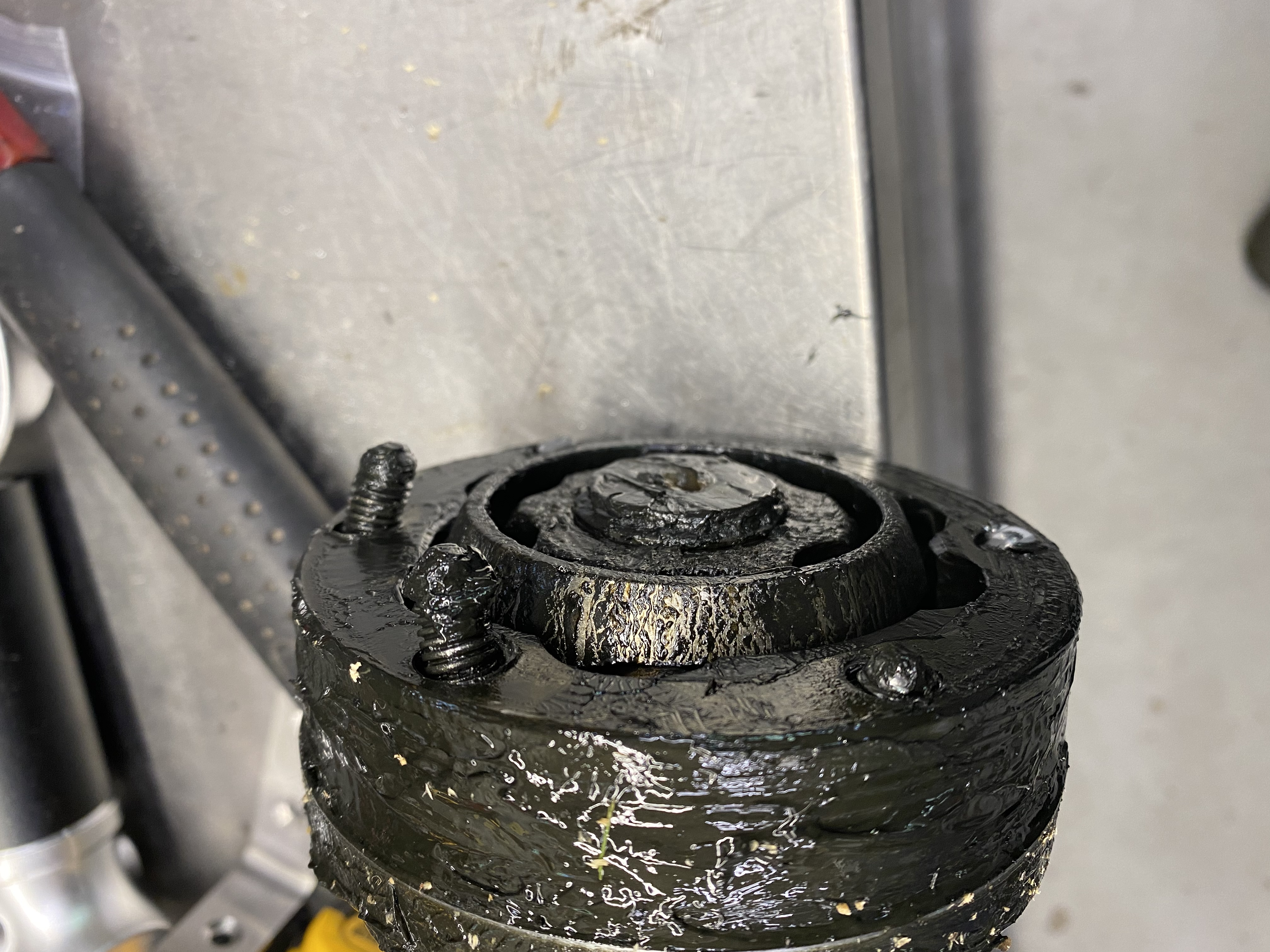

This is what happens when you ask for 500ftlbs in 1st gear with sticky 315 tires!
Posts: 9210
Has thanked: 962 times
Been thanked: 4161 times

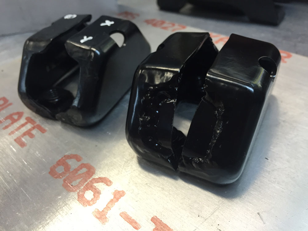

Yikes. I'm guessing the bolts worked loose if they sheared like that? I blew up 2 transaxles, until I had Kevin Gross rebuild one with new hardened gears like the S versions. Shortly after installing the strong transaxle, I shattered the CV joints. I then went on a pilgrimage to stiffen up the tranny mount, and use stronger joints (98-5084-B) and custom axles. So far so good. I was going to fab up some kind of stabilizing bracket for the transaxle case, ala a panhard bar, but I never got around to it, and it doesn't now seem to need it. Semi-solid transmission mounts proved too loud for me, especially without a back seat, so I ended up using 60A Urethane from McMaster to fill the factory mount. I also box-welded the mounts because many (most?) used mounts showed cracking from the side to side play, allowing the mounts to pull apart and allow yet more play...and the more play you have, the harder it is on the axles/joints...

Were you careful enough to clear off the bolts from any grease before screwing and tightening them back into the output flanges? It's nearly impossible to take the joints off and drop the axles without getting bolt ends dirty with grease, and it goes without saying that the threads should be squeaky clean before reassembly.

Thom wrote: Thu Sep 09, 2021 4:14 am Were you careful enough to clear off the bolts from any grease before screwing and tightening them back into the output flanges? It's nearly impossible to take the joints off and drop the axles without getting bolt ends dirty with grease, and it goes without saying that the threads should be squeaky clean before reassembly.
Yes, cleaned them well - but with the stage 8 fasteners it does not matter because they are physically held in place from rotating. Kind of a pain to install but bulletproof

the old ones were stock 12point bolts. looking at the failure several had loosened a bit. The stage 8 bolts have a 12 point male head with a 'washer' the matches the 12 point head and has a notch for the CV body to that the bolt cannot turn. Held in by a clip. Mildly annoying to install but will not back out.
