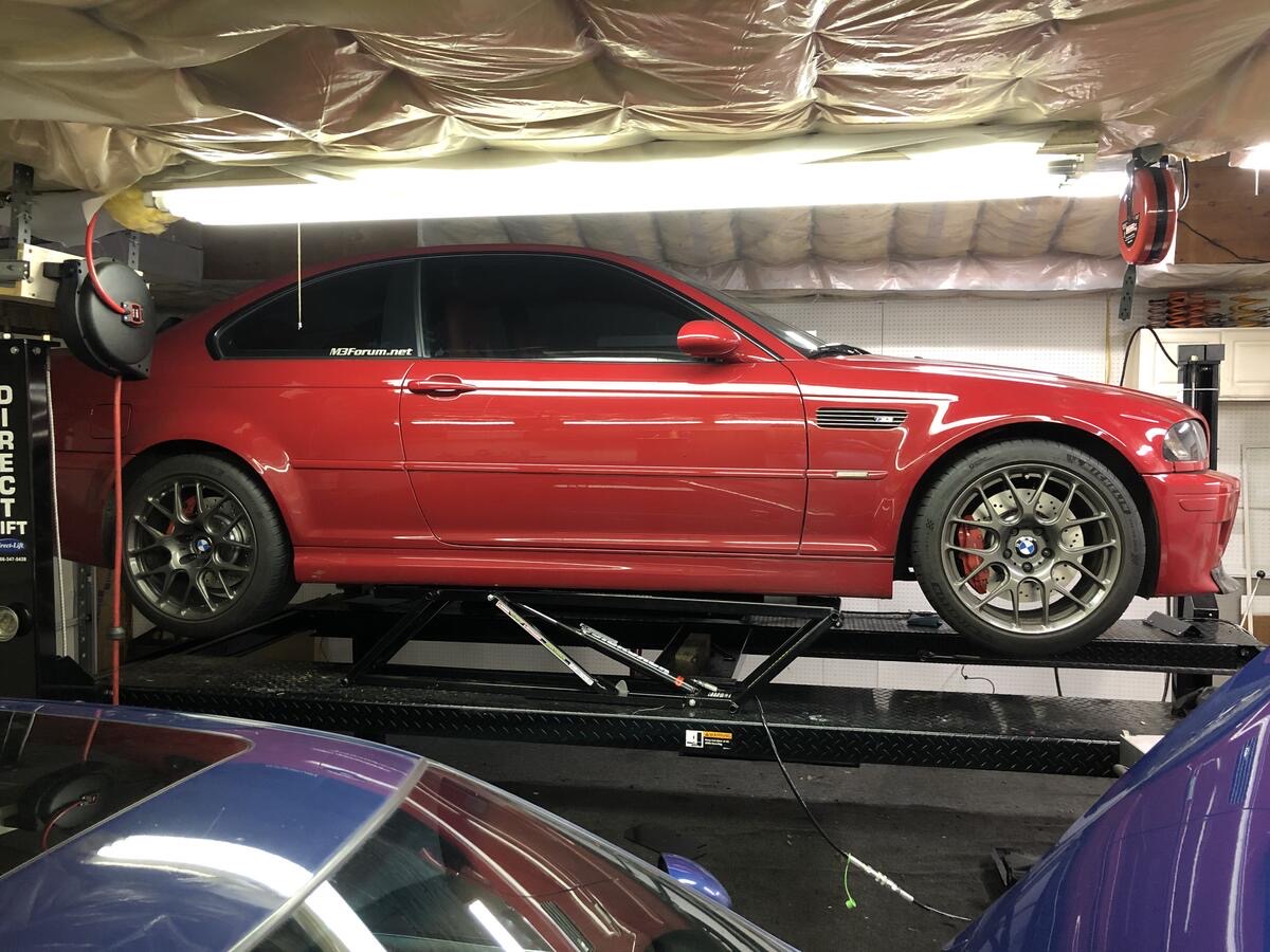

Tom,
I was reading on the other forum you were considering the Bendpak HD-7W. How is it working out for you? I’m considering one with a set of quickjacks to do suspension / wheel jobs. It *should* allow for the best of both worlds (4-post stability with 2-post benefits).
Photo found on internet:
4-post lifts

I have a 4 post (Tuxedo brand) and a set of Quickjacks, but not stacked together. I’ve seen these pictures on the internet as well, but I have no idea how they do that. The Quickjacks are heavy beasts and you need to slide them into position from the sides - you cannot drive over them to position the car. (To be clear, you can drive over them in the sense of straddling them if they are arranged together under the center of the car, but you cannot have the wheels/tires drive over them.) So if you want to put them on top of the 4-post, you need to position the car first and then manhandle the Quickjacks up into position.
Nothing is impossible if you have friendly neighbors and lay in a supply of pizza and beer, I guess…
