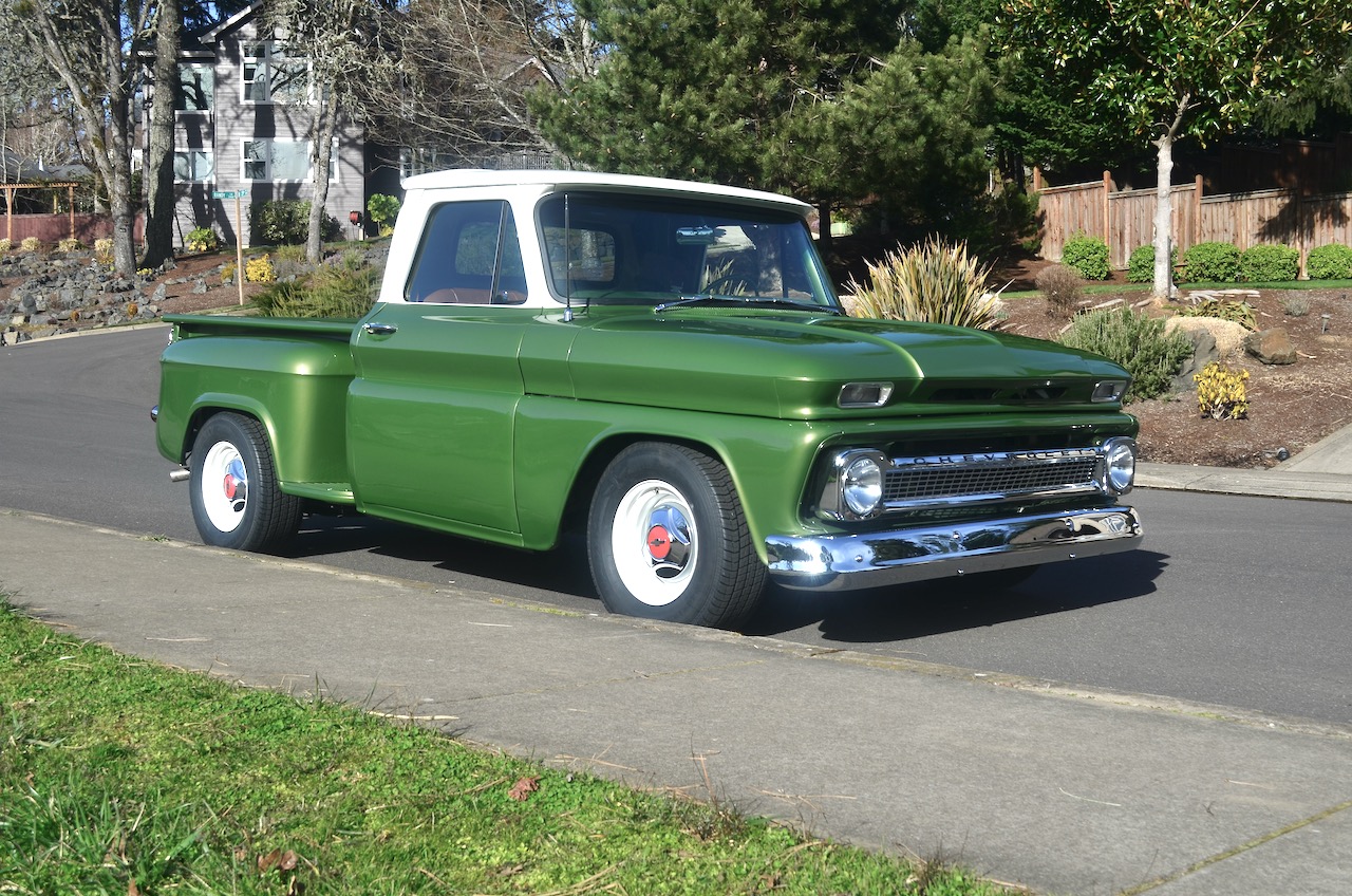

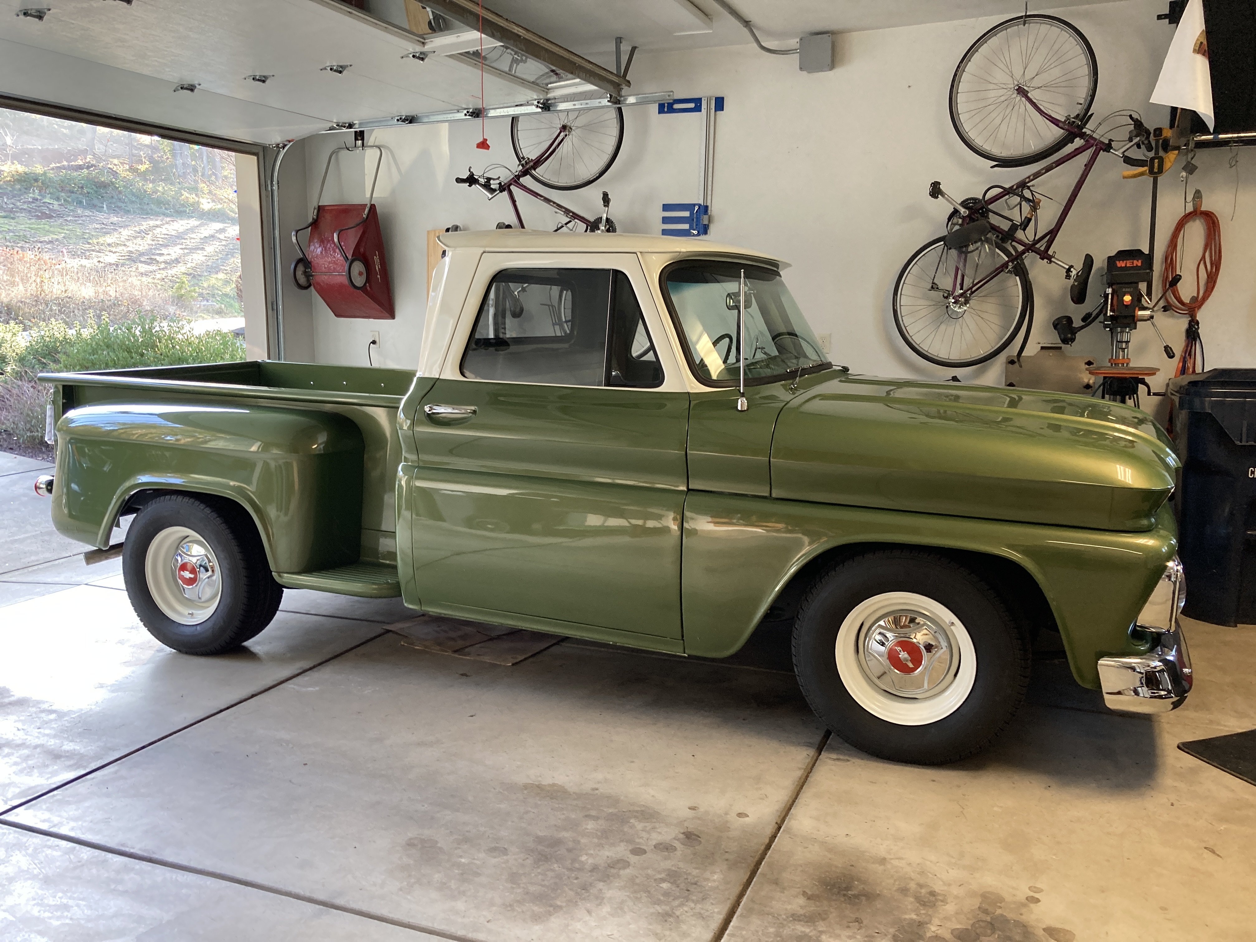

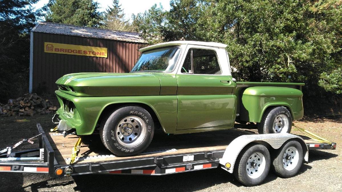

Here's a review of my current project - 1964 Chevrolet C10, a mild resto-mod. Bought it as an interrupted project last fall.
As purchased:

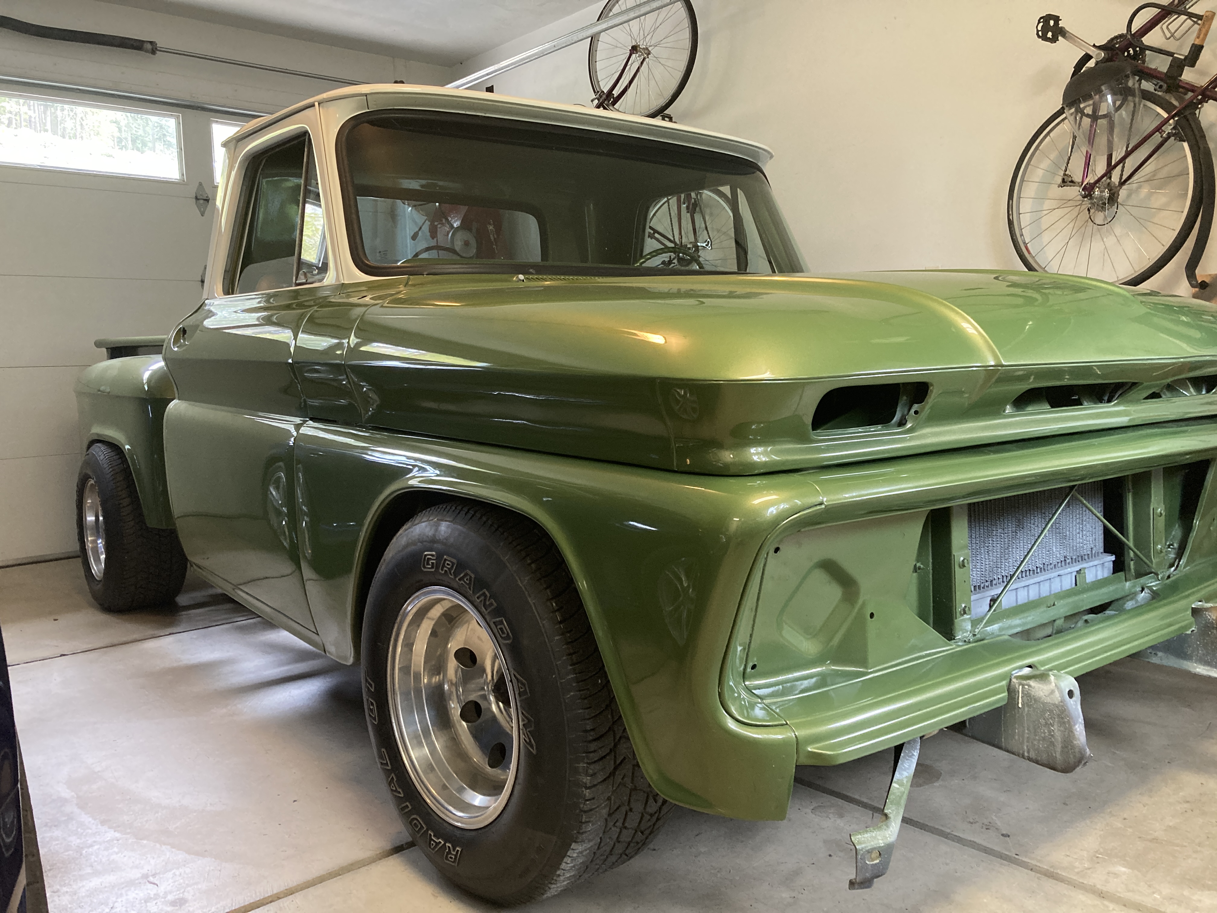

Starting to piece it together:
Ready for a trip to the muffler shop:

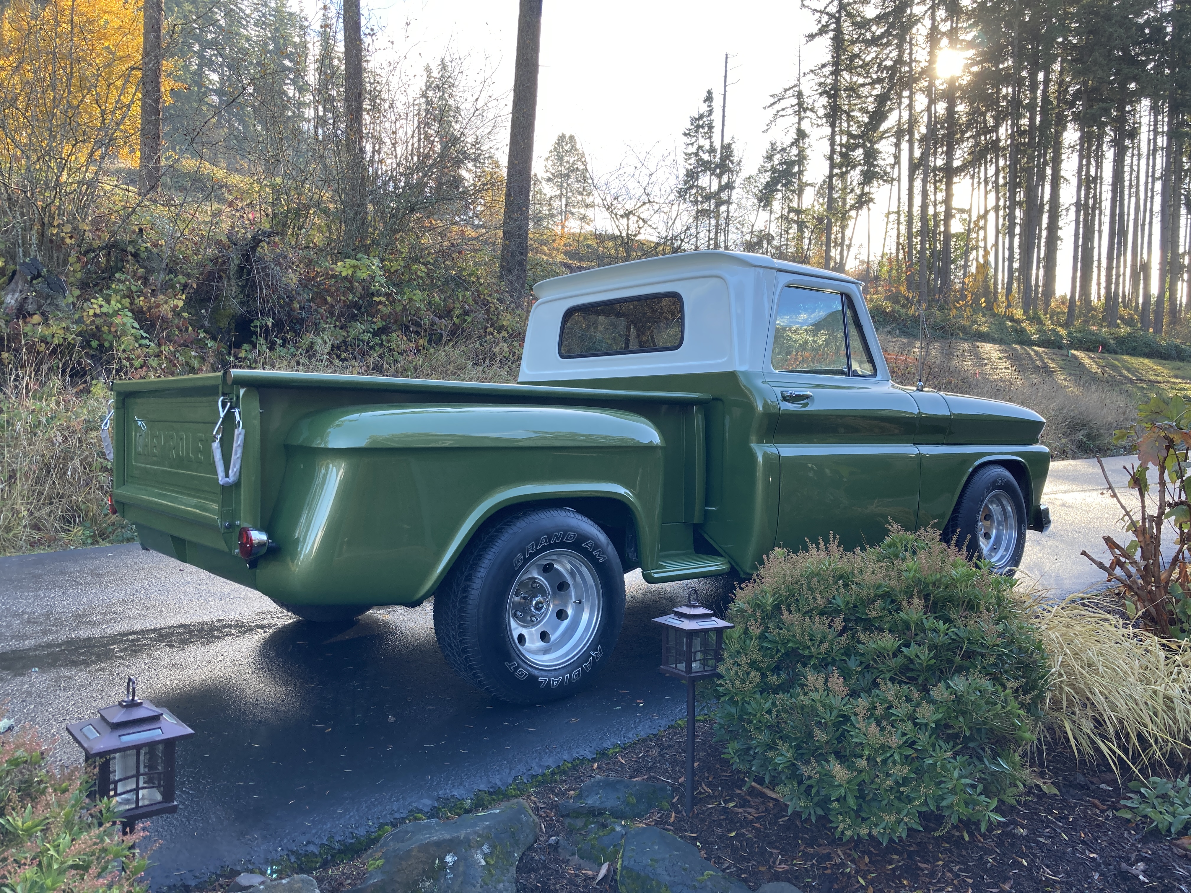

New wheels and tires:

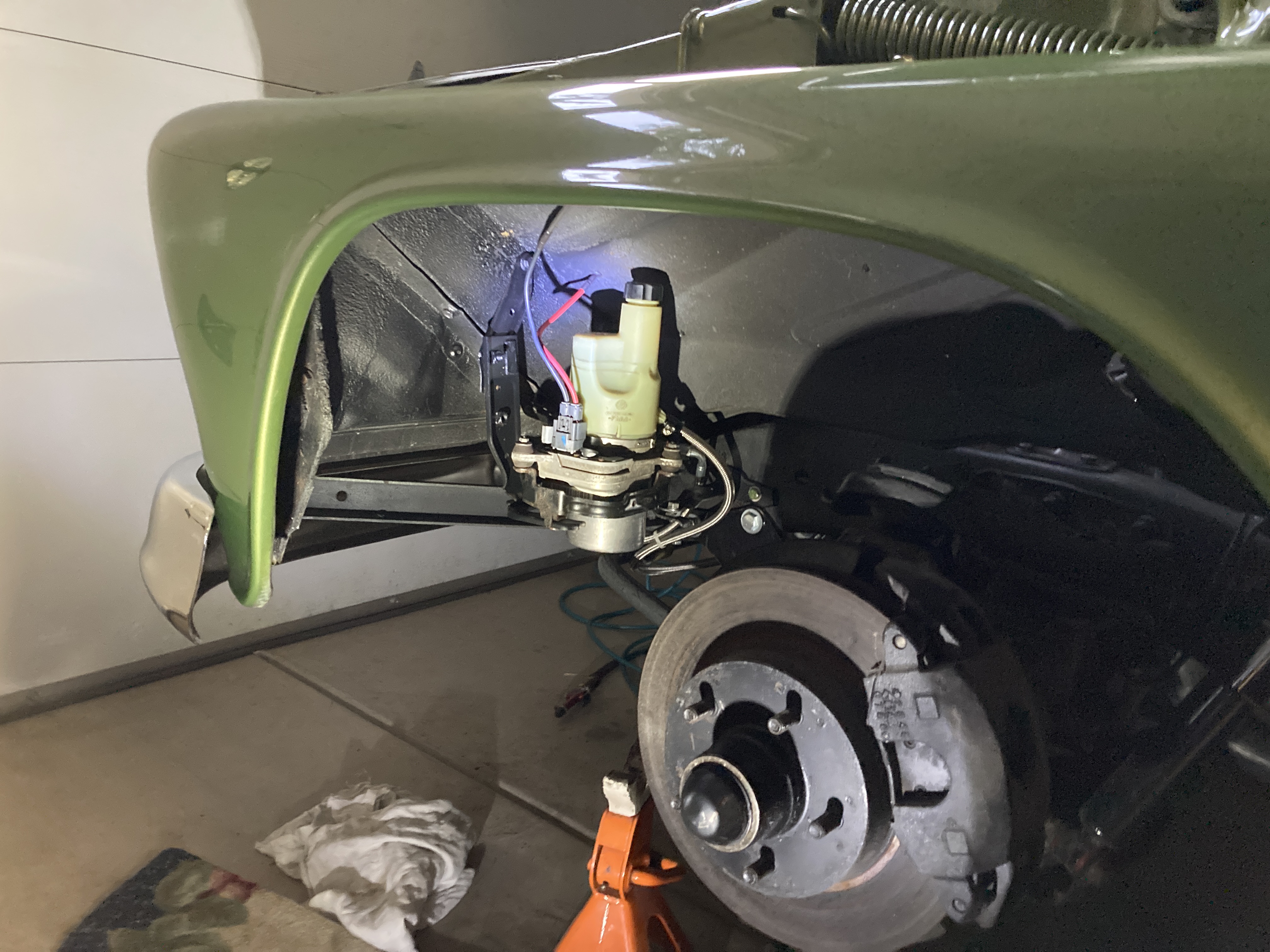

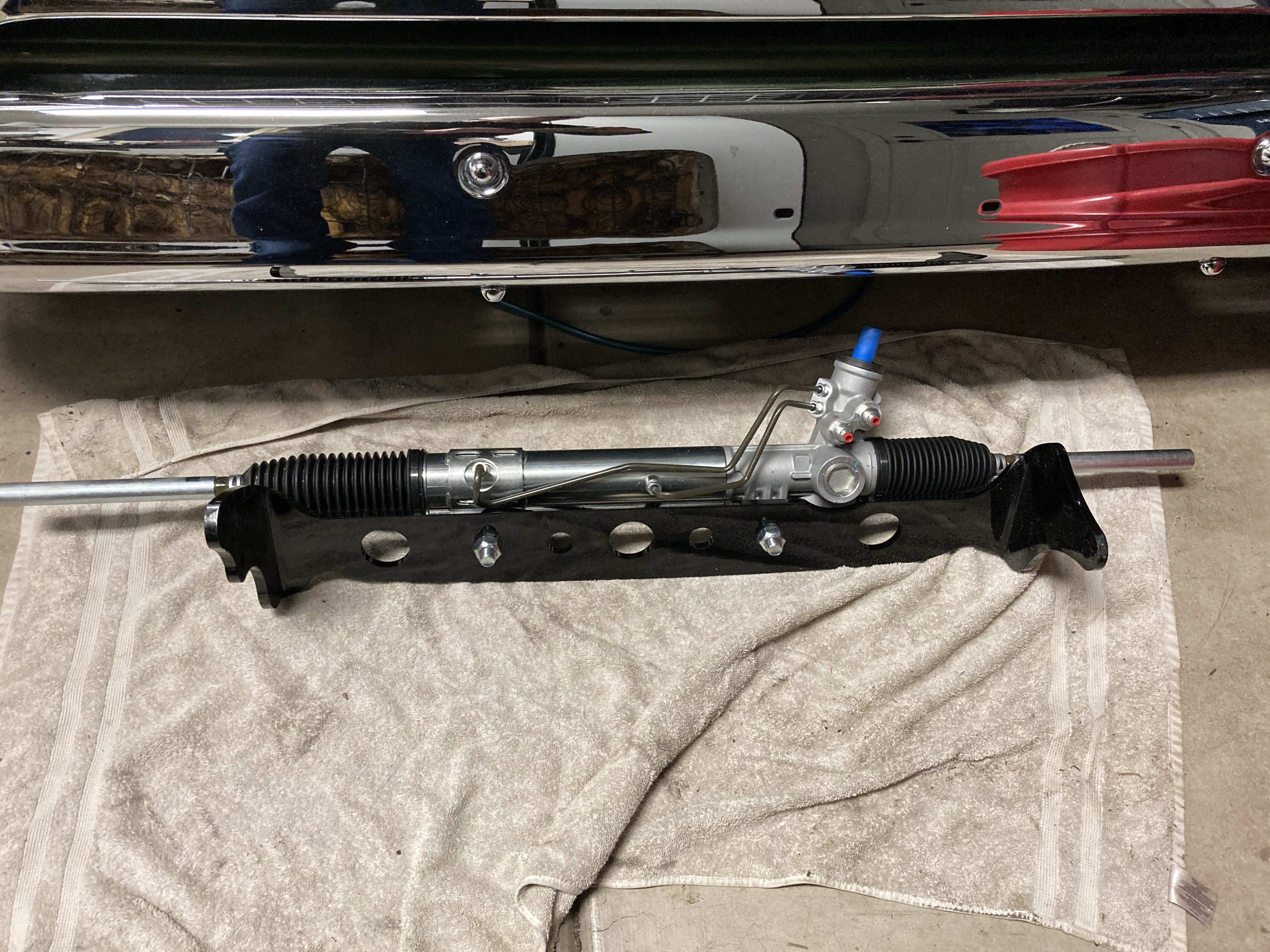

Power rack & pinion conversion, with a Volvo electric pump:

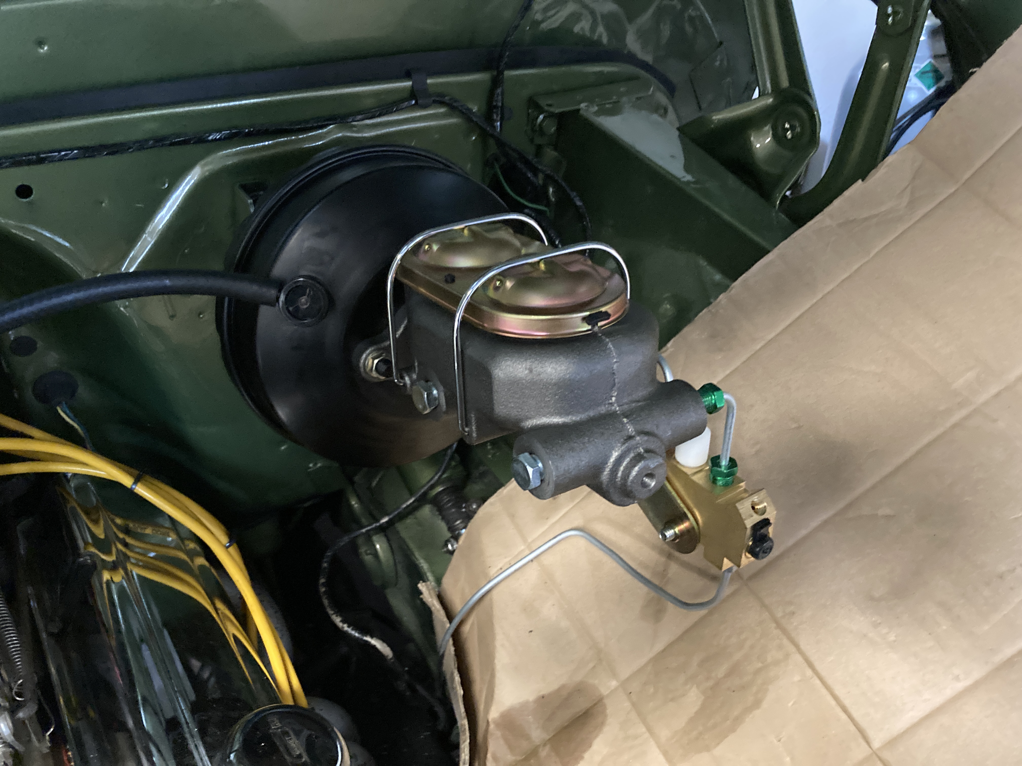

Just finished the brake upgrade. It was already converted to 5-lug and front disc when I got it, but no power assist. Took a lot of leg to stop it from speed. So a vacuum booster and matching master cylinder has been added this past week.
Getting close to finished now. Just a couple of larger items left.

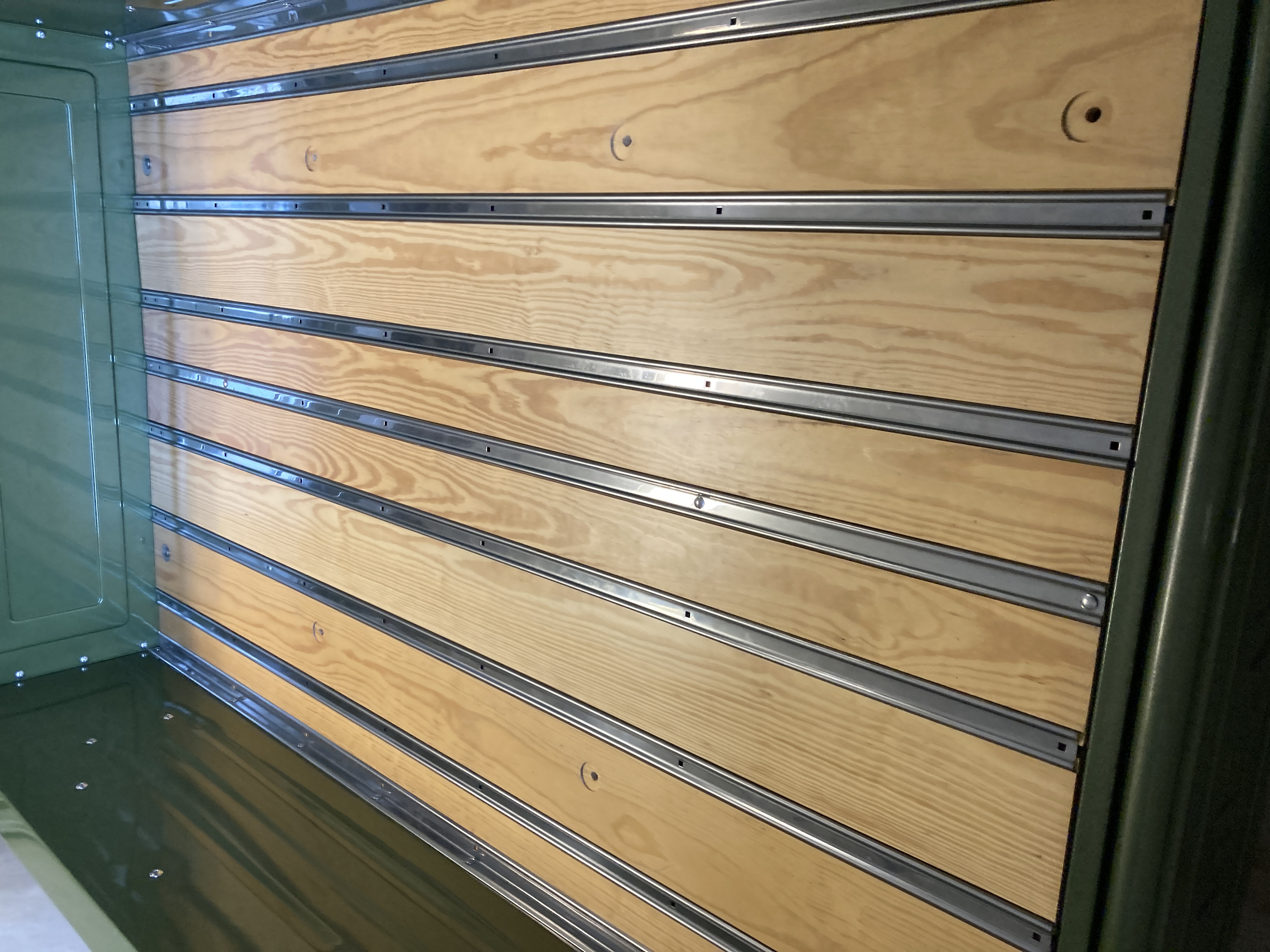

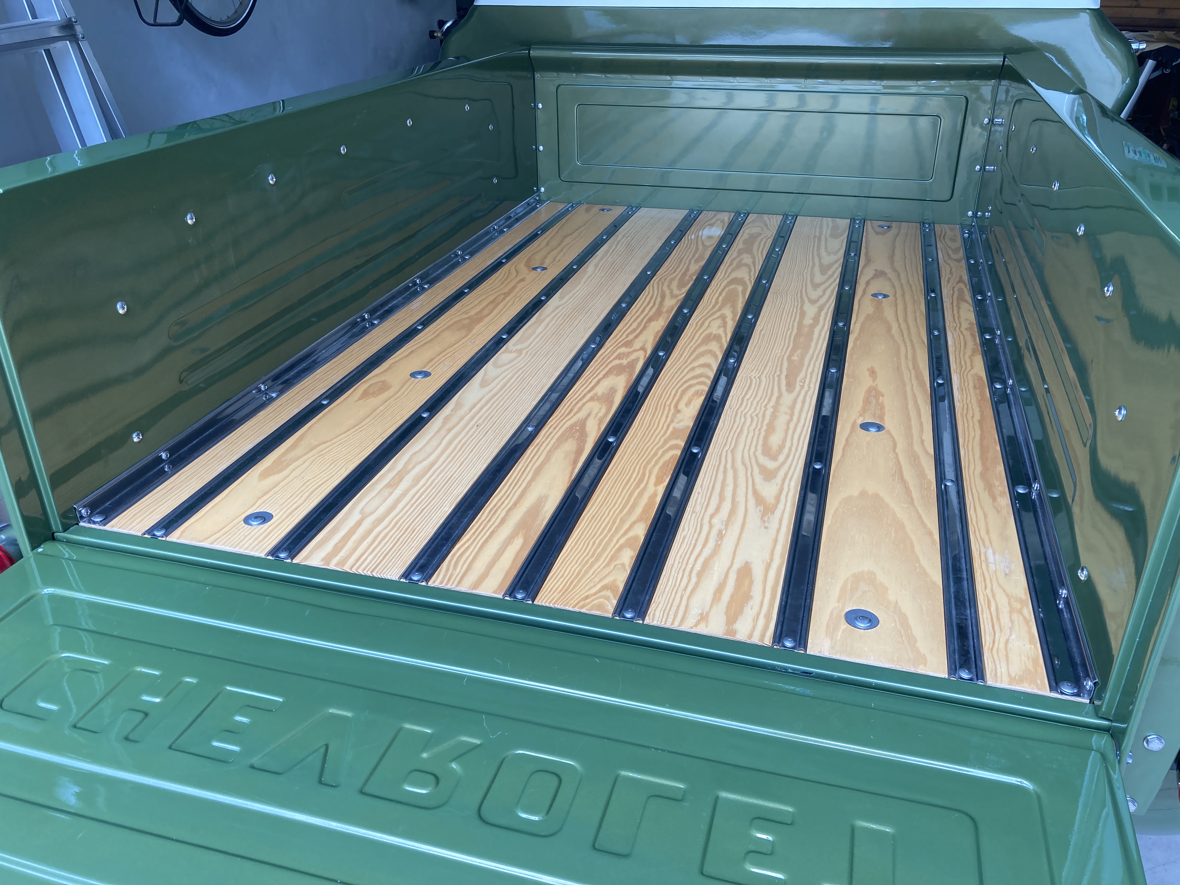

Applying finish to the new bed wood today and tomorrow. Should have the bed installation wrapped up by Monday or so. The pic here was during the mockup stage.

Arne2 wrote: Fri Apr 28, 2023 7:50 pm Applying finish to the new bed wood today and tomorrow. Should have the bed installation wrapped up by Monday or so. The pic here was during the mockup stage.
Looking good!

The bed wood is installed. I replaced the front springs to bring the front ride height up an inch. The springs the PO installed were too short, gave too much rake, and only had ¾" travel before hitting the bump stops. Much better now.
Also installed a rather basic radio/media player and speakers. Not because I have any reason to expect people to want a radio, but since the truck has an antenna and a big, DIN-size hole hacked in the dash, a DIN radio was the easiest way to fill the hole.
