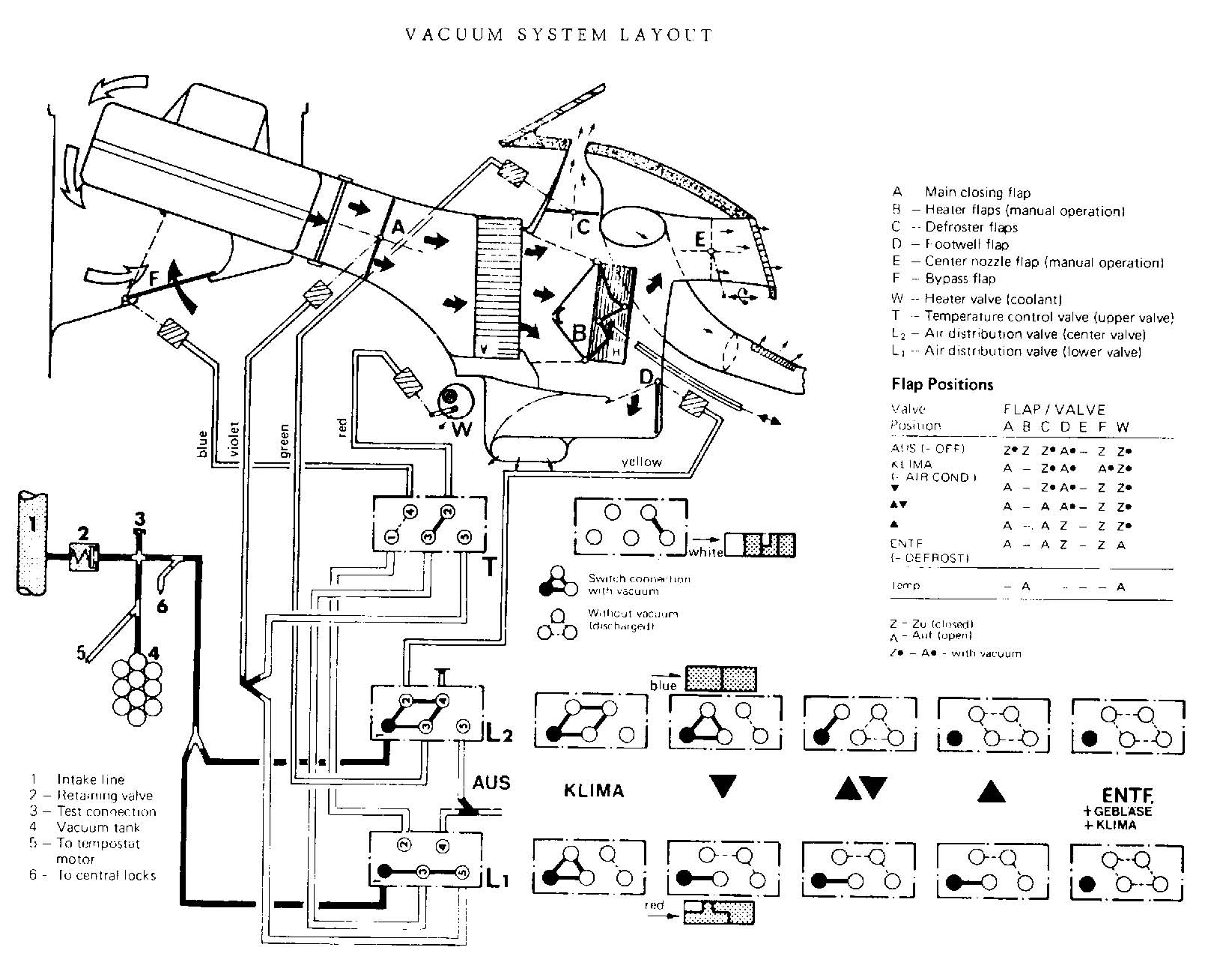

Colors for the vacuum solenoids and lines going into the console, from the workshop manual:
footwell flap (yellow)
Defroster flap (green)
Center nozzle stage I (orange)
Center nozzle stage II (brown)
Mixing flap and heating valve (red)
Fresh air bypass flap (blue)
This page 87-44 is from the 1980 printing, so take it with a grain of salt when applying to your S4.
Here's diagram that shows the vacuum and actuators.
