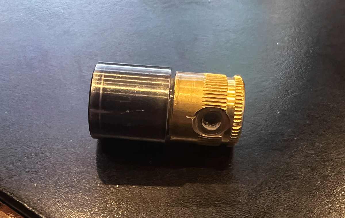

In working to remove the camshaft pulley (to replace seals), on my 1986 944 Turbo, I had to destroy the adapter to get it apart. Does anyone have a spare they would sell? The attached picture has the offending part circled. The others are to help with where the part generally fits (because I was not sure what people call it). You can’t get just that part, but can get the rotor and sleeve with screws from Porsche for a list price of around $160.

Any interest in this one? The brass sleeve is what is left of the rotor after it was broken off. I'm sure it would come off with some combination of heat, twisting, maybe a dremel cut-off wheel, etc....

PM sent. Send me your address and I'll send it out. And, good news, I put my little map gas torch on it, and the brass collar slid right off like hot butter. Probably a good technique for getting the rotor off in the first place when it is stuck this tight.
