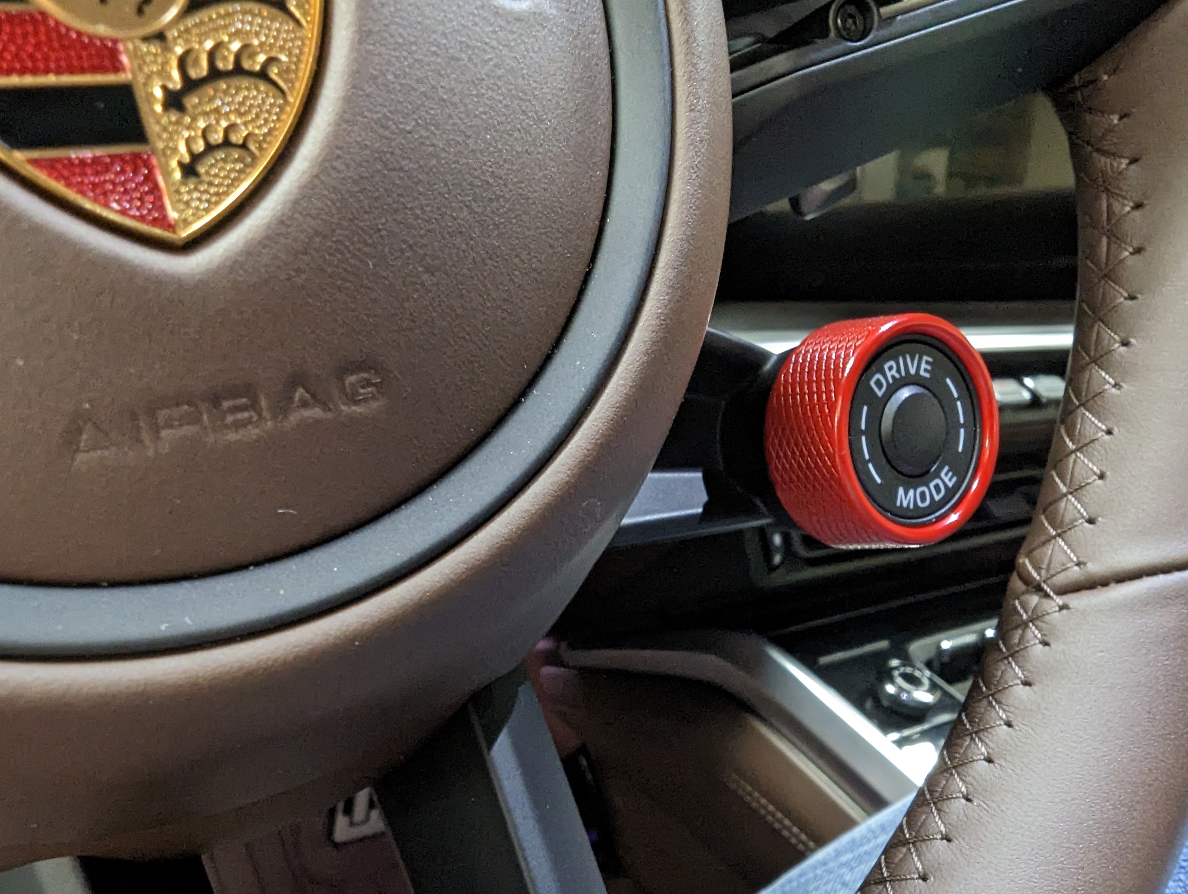

I agree with Tom on having the default be in Sport mode rather than Normal for a 992 TTS but then again, I am ok since switching is second nature now.
It's easy to twist the dial one notch - especially so now that I have the Carpokes dial mode cover!
