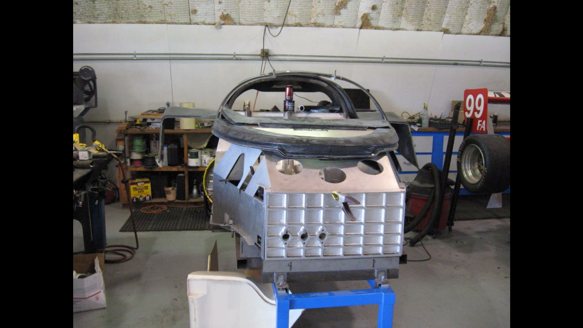

Well this is a project I built for a local guy but ended up starting my own build after that.
Rolling chassis
Rolling chassis

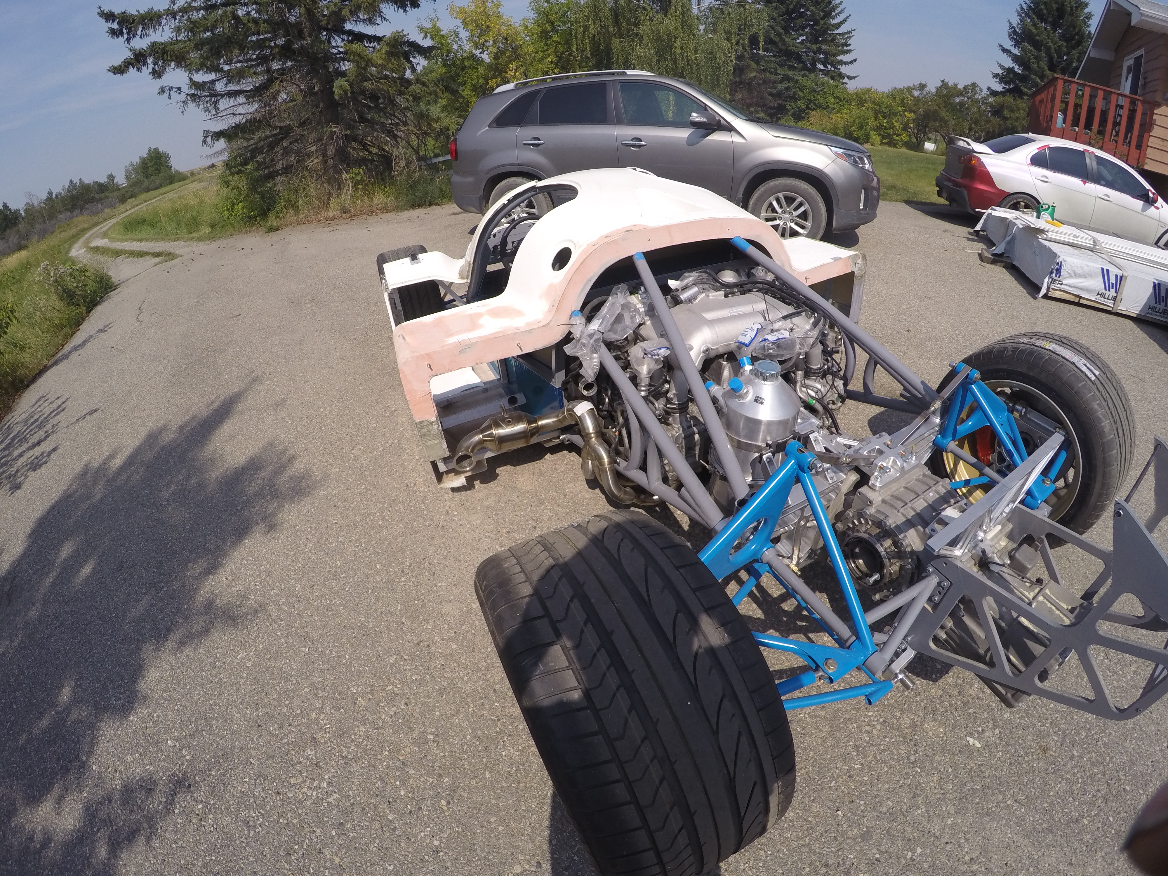

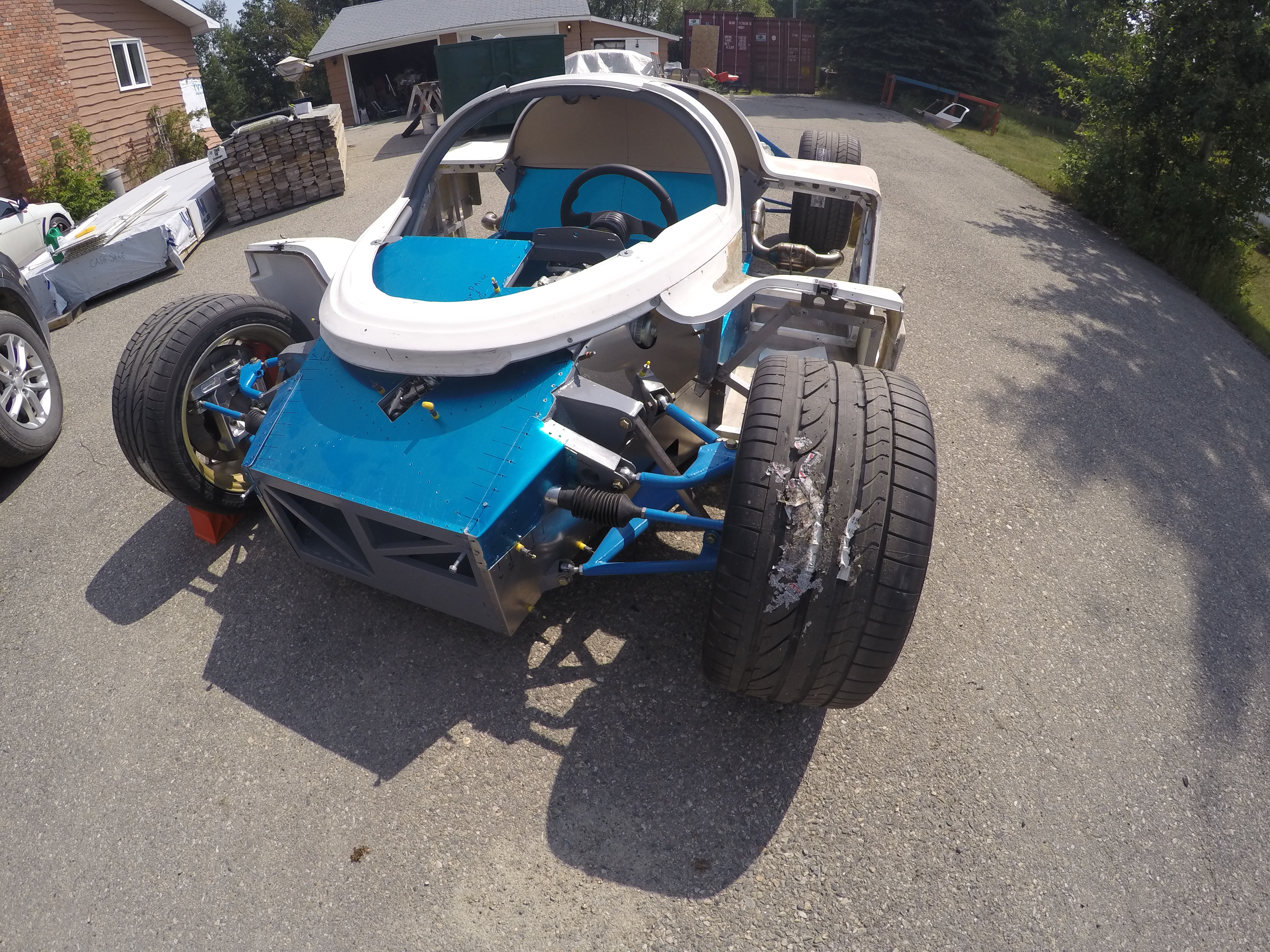

The chassis is a Tube frame but we have skinned it which makes it kind of look more of a Tub stile
Front view<br />Front
Front view
Front

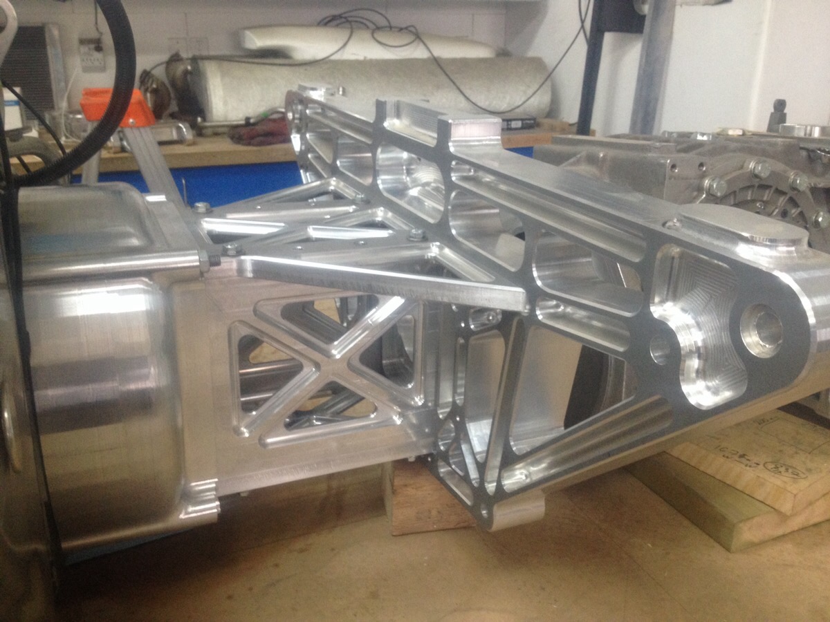

To put the 997 GT3 motor in the right place I built a custom adaptor plate with a new Bellhousing and extension. Dont ask how many hours machining as it was months in the making. But is a talking point to anyone that sees the car..
Custom Adaptor
Custom Adaptor

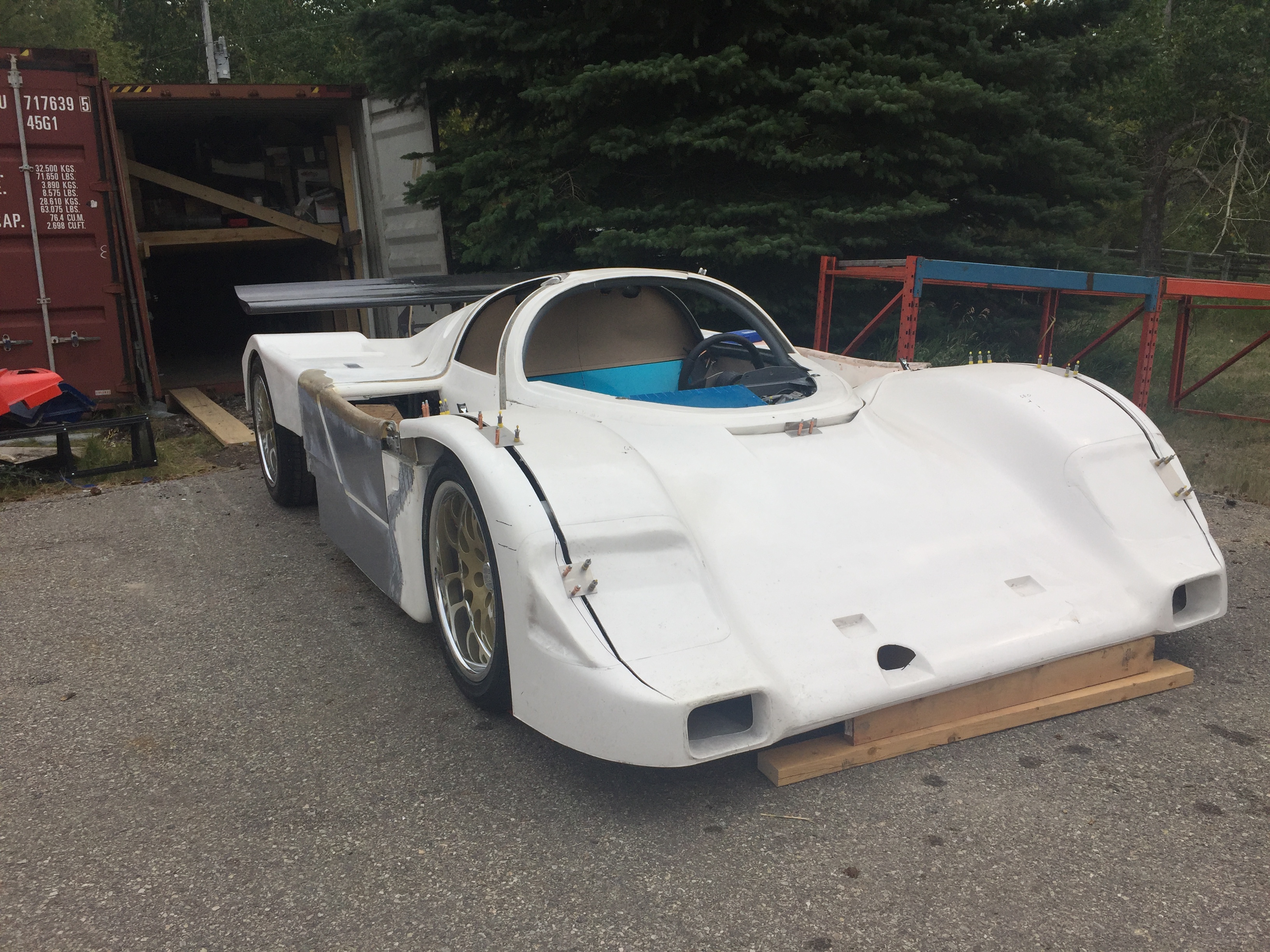

Body was almost ready after many adjustments for a paint and body guy to take over

Wowza!! I bet that adapter took months… this is amazing!!
