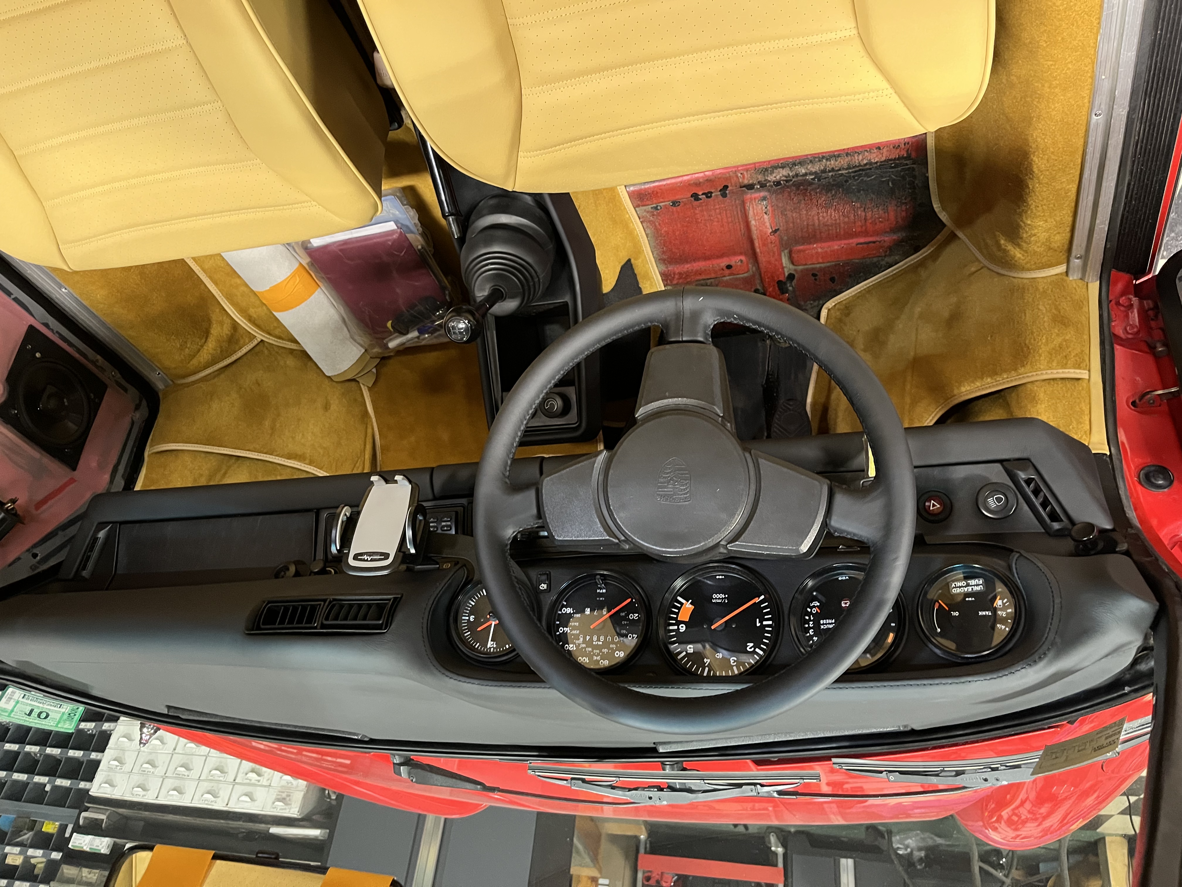

I’m looking for anyone who has extended their steering wheel and what parts they used to do it. Pelican Parts has a steering wheel extender/adapter for Momo steering wheels, but has anyone used it with a standard Porsche steering wheel? Any other source for extending a stock Porsche steering wheel?
BTW, I am 6’4” and have a 1982 911SC Targa. I drive with the seat slightly reclined and almost all the way back to not hit the roof and give my legs some room, but if I push the seat all the way back I am not close enough to the steering wheel. Moving the steering wheel back 1-2” could be perfect. The Momo adapter mentioned above moves the wheel about 3/4”. But anything would help.
Also, I just renovated the interior and had the steering wheel recovered in black leather. After that expense, I am not eager to replace the steering wheel with a Momo steering wheel.
jwhittle
Joined: Tue Jan 10, 2023 10:28 am
jwhittle wrote: Tue Jan 10, 2023 11:05 am I’m looking for anyone who has extended their steering wheel and what parts they used to do it. Pelican Parts has a steering wheel extender/adapter for Momo steering wheels, but has anyone used it with a standard Porsche steering wheel? Any other source for extending a stock Porsche steering wheel?
Apparently Porsche offered an option for G-body 911s to extend the steering wheel, but it seems like very few people checked that option. Someone on Rennlist was selling an extender several years ago.
Interior renovation in progress; note how close steering wheel is to dash (normal distance).
Recovered steering wheel, and interior almost done.
