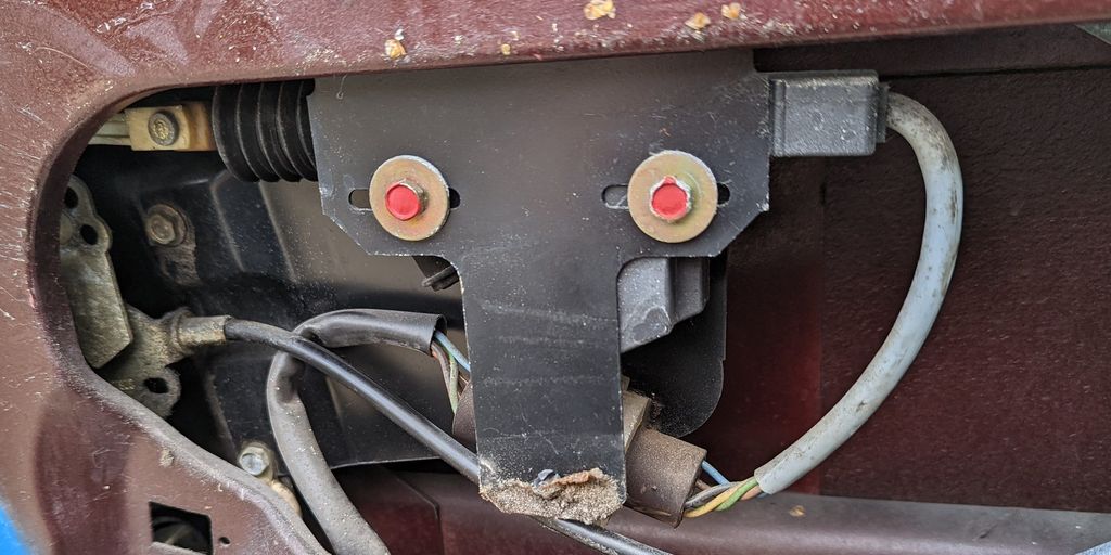

Door Lock Motor
Behind the door lock motor is another black plate that probably makes "slim-jim" style door lock attacks slightly more difficult. I don't have separate photos of its removal, though it is straight forward.

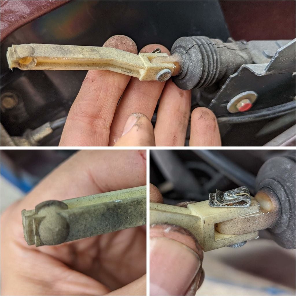

The ball end of the nylon rod (that connects the power lock motor to the door latch mechanism) has a small clip that helps keep the ball end secured on its ball. That clip is known to fail and break away, which has happened here. If the nylon rod falls off its ball, the lock/unlock functionality also fails, naturally.
This nylon rod does not have distinct left/right part numbers.
left or right pn: 944-537-511-00-M100

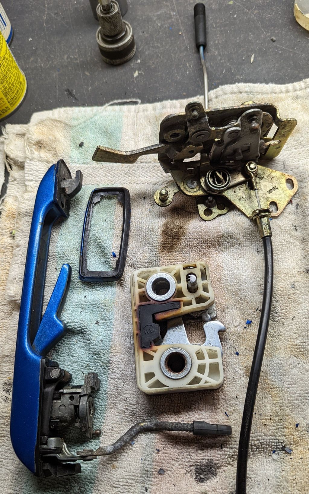

Complete Door Latch and Handle, Exploded

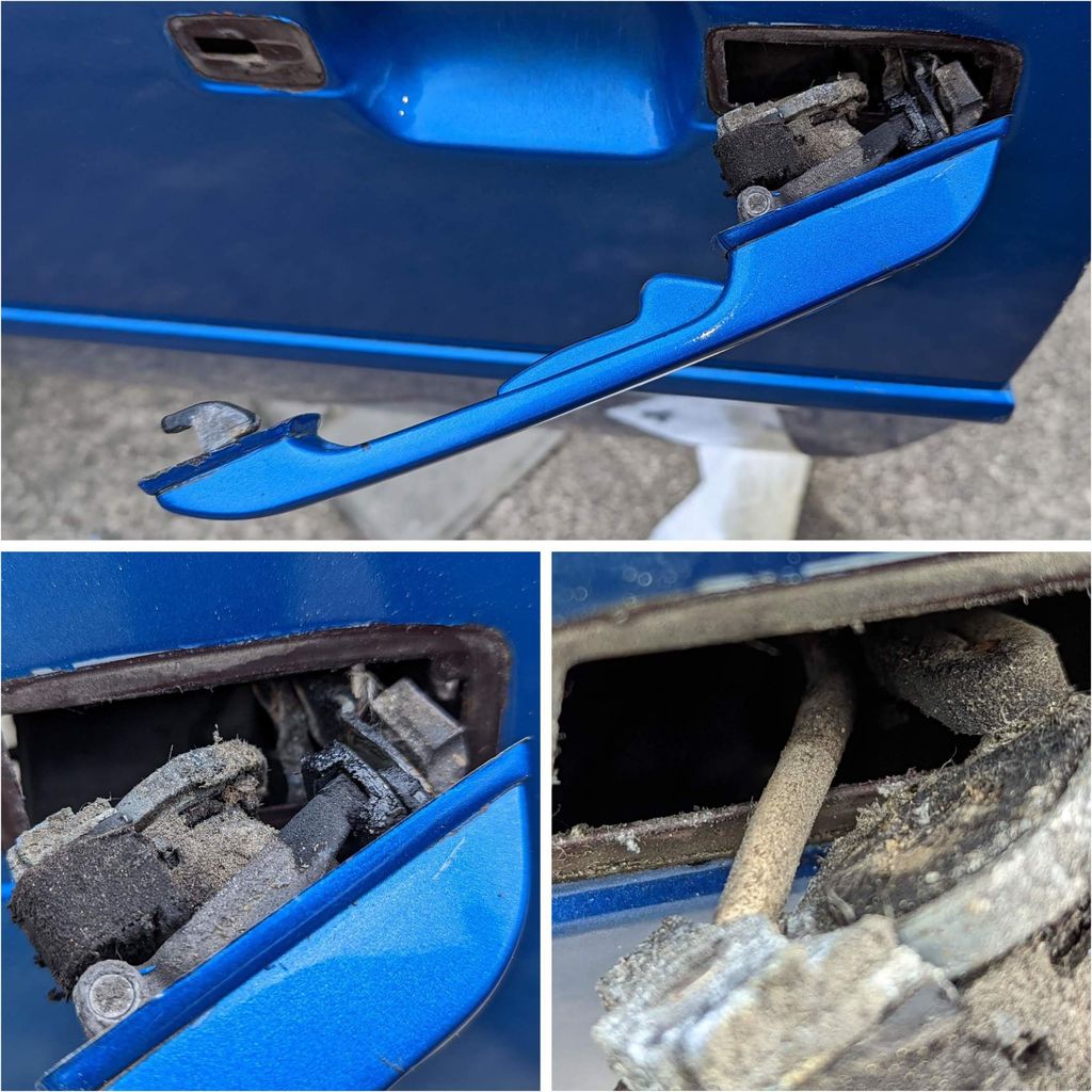

My door handle is not "springing back" very well these days... often sticks in open position & have to nudge it back.
Is there a simple lubrication or cleaning fix? Is it tricky to remove the handle?

I imagine I can get to this spring and lubricate it?
Do I have to remove the door panel to get to this or is there a way from the outside?

danmartinic wrote: Tue Jan 10, 2023 10:31 am I imagine I can get to this spring and lubricate it?
You can easily get to that mechanism without removing the door card. There is a screw on the side of the door in alignment with the door handle that holds it in place, after removing that you can slide the handle either forwards or backwards (I forget) and pull the handle outwards (it will look like the picture usury posted titled "Door Handle Removal").
I spray cleaning solvent and lithium grease this way every once in awhile to keep the handles easy to open.

my latch mech was just absolutely disgusting. all the dark stuff is dried, dirt-filled, sticky grease.
Re: What's Inside: Door Lock & Latch
Posted: Thu Nov 02, 2023 9:09 am
by notny41
after letting it soak in berrymans and scrubbing a couple times:
I ended up just tossing the toothbrush i was using to scrub this thing because it was just black and greasy…
