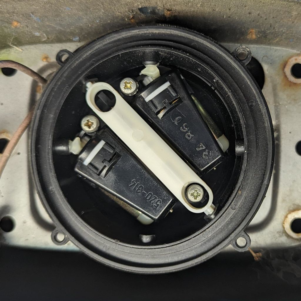

These notches (circled in green) are accessible by pushing the glass of the mirror itself all the way to one side and reaching inside the housing with a pick or blunt screw driver. Using the notches, rotate the black plastic ring a few degrees until it releases the mirror glass from the mirror housing. Lay some towels or a work mat on the ground to provide a degree of protection for potentially dropped mirror glass.
Lubricate the Two Drive Motors
Completely eliminate mirror whine noise by lubricating both ends of the two drive motors. I used a silicone spray lube. You use what you like. Connect 12v power to the proper pins to run each motor through its full range of motion (or use the mirror controls if it's still on the car). This can be done without removing the mirror housing from the car. Only the mirror glass needs to come off.

Little Notches
