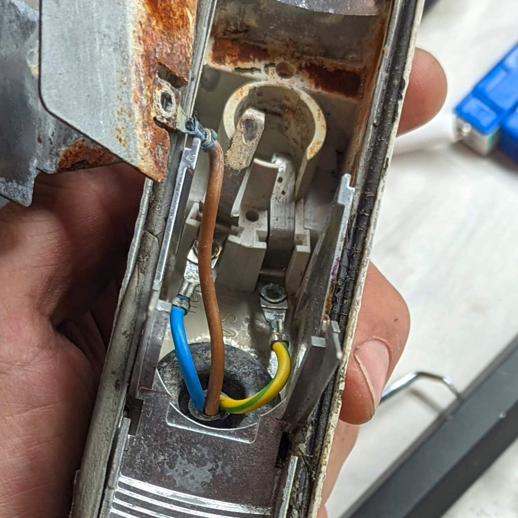

The electrical pigtails for the turn signals show an aftermarket waterproof wire connector at the car-side of the wires. Don't let it throw you off if the wiring for your turn signals is terminated differently - it probably still has the factory connector.

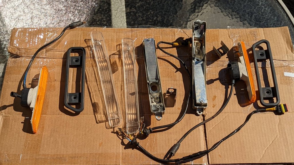

Turn Signals and Side Markers

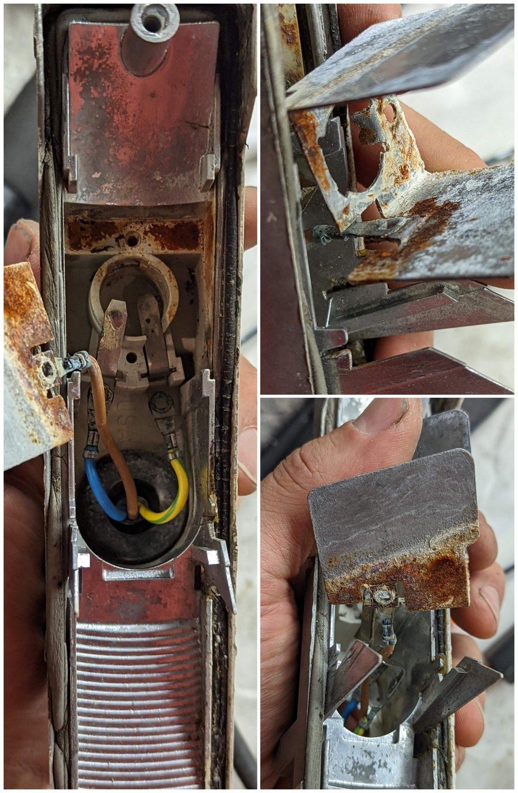

Wiring and Metal Reflector
Wiring Zoomed In
Wiring Zoomed In

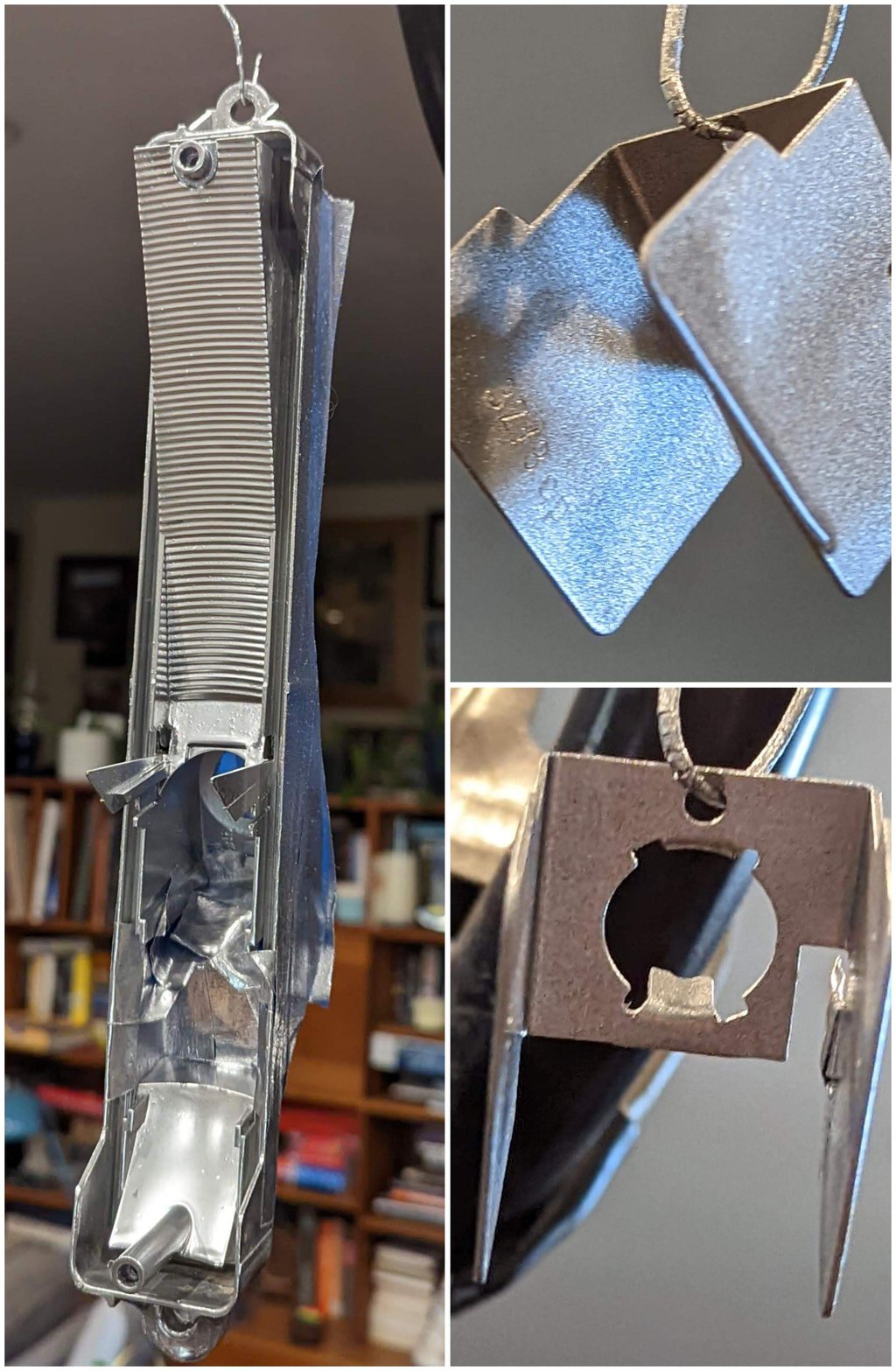

Painted Parts
Painted Parts
Painted Parts

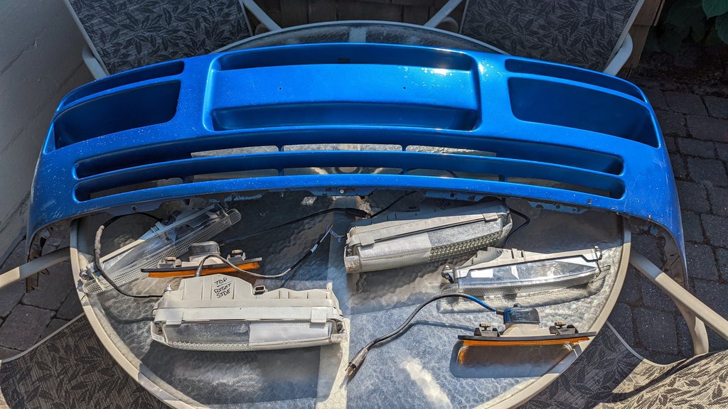

Bumper and Assembled Lights
Removing the bumper cover from the car is way easier than doing this on the car. In fact, I don't think it's possible to remove/install the turn signals with the bumper cover installed. The back side of the fasteners is not accessible by mere mortals with normal tools, or perhaps by anyone with any tools.
Side marker lights do need to come out first, though, in order to access the fasteners that hold the bumper cover to the fender.

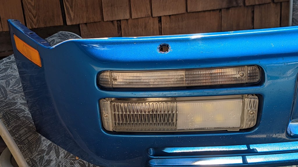

Turn Signal (and Fog Light) Installed
